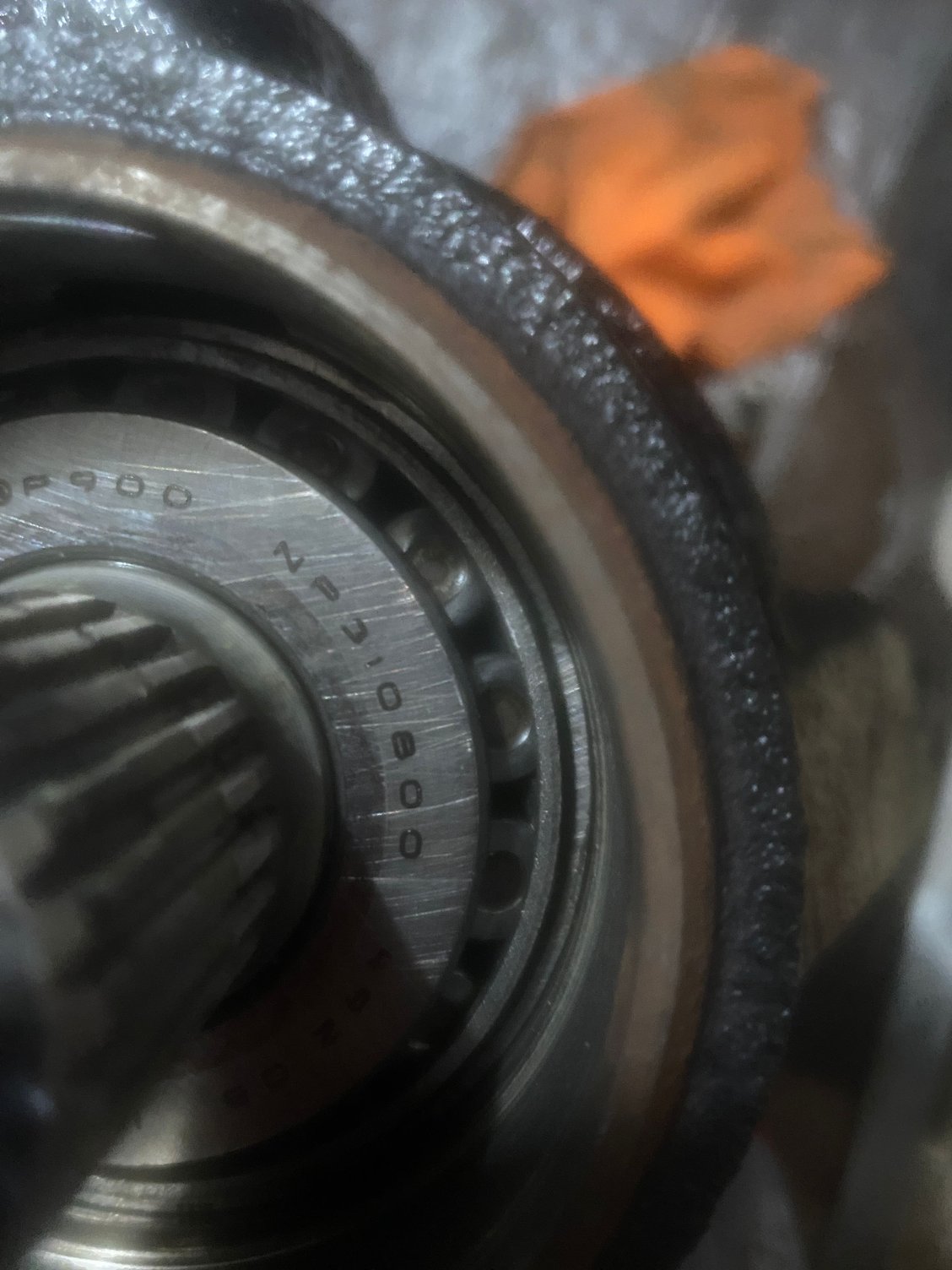

Pinion bearing is Timken NP310800, FYI.

Measurement notes on carrier bearings:
Driver side:National 21.60, total package
Timken 20.00, total package
Timken new race, 15mm
Timken original old race, 15mm
National race, 16.65
These next measurement are not very accurate cause of the bearing cage interfering:
Nationa body only (no race), 20.2
Tim Ken body only (no race), 20
Pass side:
Both BCA/NTN and old Timken race measure 15.45mm
And today I installed both races. Only thing to do next is clean up the gears really well and paint em to check the interface and check the backlash which value I am still not sure of.
The pinion bearing on mine, like I said before, seems excellent and I had no plans to replace anyway. Originally they would "stick", it took some slight force to get them to rotate then they spun smooth and fine. Once unloaded with no input installed there was actually play in them (that is when I cleaned em up). I marked the nut and pinion shaft and after getting this close to my mark I decided to stop for now and checked the force needed to rotate the shaft. Which no longer sticks at all, just spins smooth. I am getting about 3.6 lbs on the fish scale which is as far as I know pretty good. But I still need to see if I can find a true and proper value. But based on two sources who have done pinion seal replacement with the diff still installed in vehicle, that is about the proper force.
