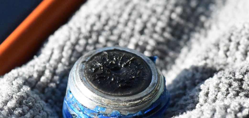

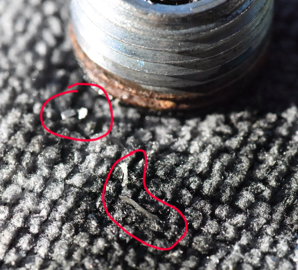

Tiny update. I did a diff oil change today. About 80 miles so far, not much. But diff oil is cheap and I wanted to see how things looked before a highway run. Hard to say really at this point. The oil looked great of course, it is new. The magnet had more on it than I would like including several small flat pieces of metal. It is possible this is debris from the rebuild that was trapped up in the pinion bearings and now worked itself out. Or I could be a touch high on the torque preload values as I mentioned before. But I am within spec. Assuming the specs are correct.... There is so little info on this actual diff. The diff sounds great in that it makes no noise at all. I will do another change in a couple weeks and see what ends up on the magnet. For the record, when I drained my old diff before removal I expected some metal bits and had none at all though, just metal sludge as normal. No chunks, bits like this, etc. I was surprised and even more so when I saw the state of the old bearings.
EDIT: Since we do not have to do a proper break-in since we are not replacing gears, I did one heat soak run. Drove around town at lower speeds for 20 minutes then let it sit an hour to cool. This is in addition to the around town driving I have done all week but those were always much shorter trips. So after cooling for an hour I took it on the highway for a few miles to an exit then looped back home. The diff was pretty hot but I am bale to touch for at least 8 seconds. So it's not overheating, but it does feel hotter than I would like. But there is so much conflict of info out there.... The consensus seems to be that they will run hotter because even with just doing carrier bearings there is some break-in. I am curious to see how hot it gets after an hour of driving at 70mph. Surrounding metal like the frame supports were not super hot, so I know it is not heat soak from the engine heating it up.
And that is blue teflon tape, not thread lock on the plugs. I always use some to help prevent leaks and aid in much easier removal.
