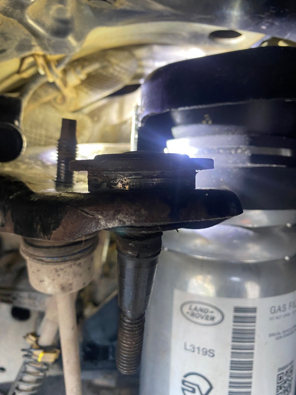

So here is the issue. I pressed out the old ball joint and took the joint out of the new Mevotech arm. The issue is when I put the Mevotech into the OEM arm, the joint plopped right in! No press-fit at all. This is an issue because now the only thing holing the joint in place will be the circlip. Its job is more of a backup than to take constant abuse of the arm slamming between it and the joint cap. So something is not right. The Mevotech reads about 0.5mm smaller in diameter than the OEM. So in a pinch, I order the only one from Amazon with fast shipping. It is from CTR, which is OEM for Kia and the likes. Reputable but not a brand I used before. Well... it is smaller too. Larger than the Mevotech but still undersized. You can see below that if I press it in there wont be much bite, a millimeter or two at best. I took the OEM and set it in and you can see how much higher it sits. So for now I added some shims and pressed the CTR one in which helped a TON. Test drive and it has not moved. I do not plan to keep it in there though and I have two more ball joints coming. One is TRW and the other is API which is a re-boxing brand I have had great luck with.

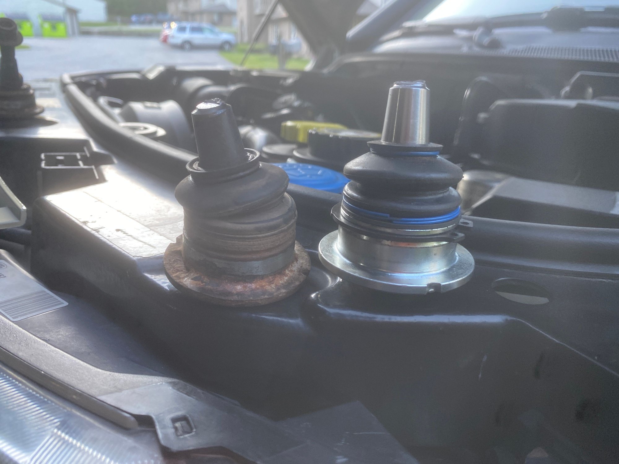

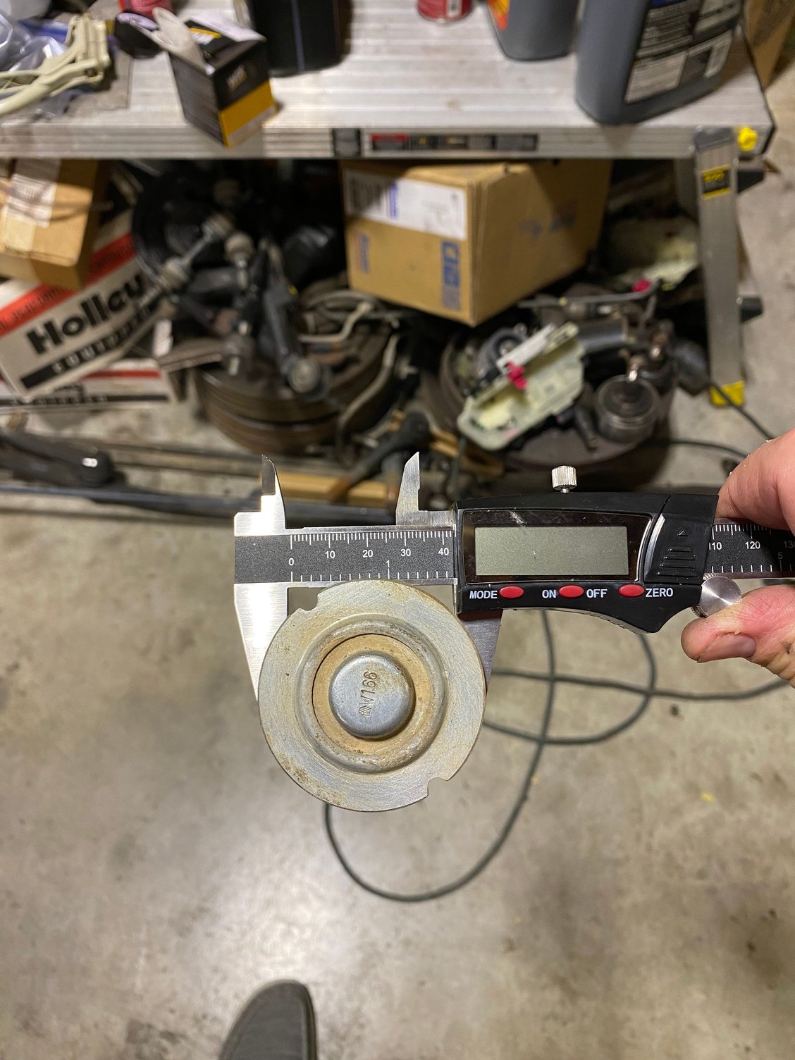

Finally got a minute to dig mine out of my scrap pile from my 2006. I pressed new Lemforders into the factory arm with no issues. Same on my 07.
I don’t have any batteries for my caliper, but here’s the OEM upper.

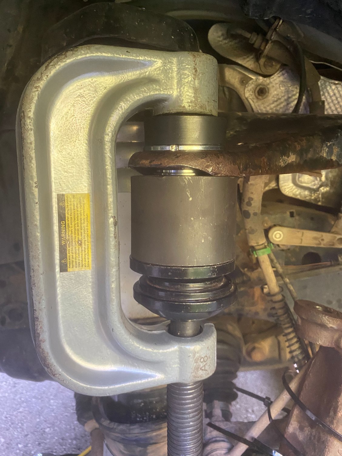

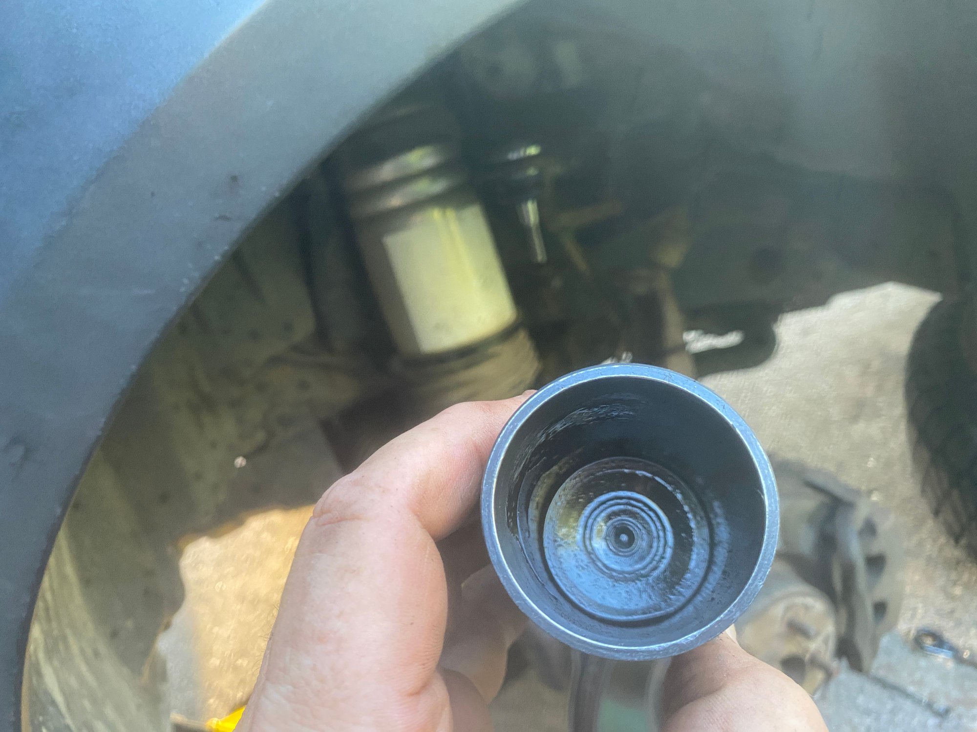

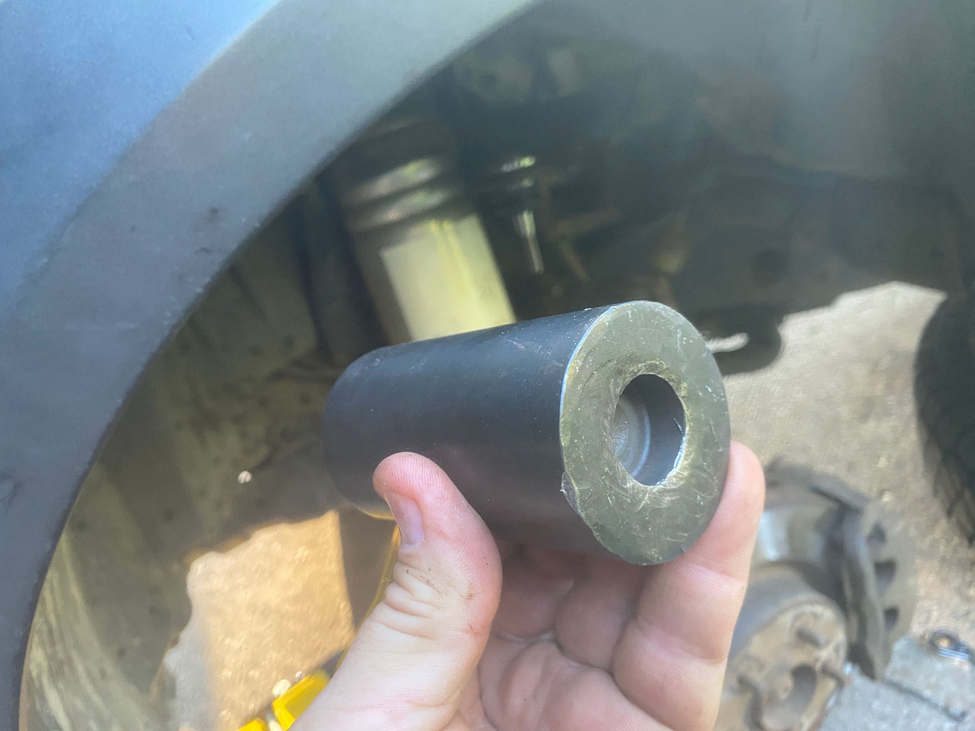

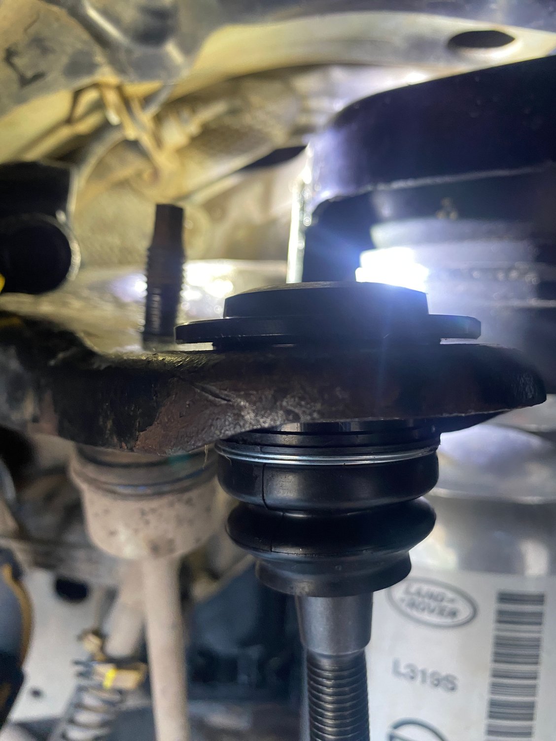

Another update. Good news is the Delphi ones fit just fine. Bad news is that they *may* be longer than the others I installed. This created an issue. Installed on and it was pretty sloppy. No actual play that I could feel, but no resistance to articulation. I could not leave it like that. So out it came! The second one I did in a much slower manner. I would get it a short but and remove the press and inspect. I did this up to the end but on the final check I noticed the installer cup I used, really the only one to use, was not going up all the way to the arm and around the joint that was sticking through. That was because the spindle end was actually bottoming out in the installer cup! That cause the first joint to be pushed up into the top/crown grease area whatever and probably distorted things enough to allow the slop. So with the basic ball joint kit I had I needed to get creative for the last half millimeter just so the snap ring would fit right.
The installer cup tool thing that is not deep enough:
The creative combo needed to prevent the spindle from bottoming out:
Also a new trick on this upper ball joint job, cut the dang spindle. Just do it. Makes removal MUCH easier. What you do is use a large deep ring, like pictured above now sitting under the joint - use that on top with a cap to locate. Then one the spindle end use the other black cap thing and drive things home. That lower one WILL walk over one way and may frustrate you. Don't, just let it walk and tilt and just drive tihard it will pop out. Well as long as you remove the snap-ring! And keep in mind the torque spec on the ball joint is really low! I thought it was 68 or 72 - NOPE! I started to torque mine but stopped after I questioned it. It is only 52 foot pound which is not much. I think mine is around 65 when I stopped.... For that reason alone I may replace it yet again because I am paranoid.
