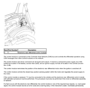

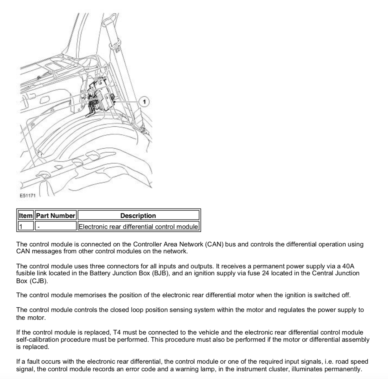

Well you could just disconnect it and see what happens, no? Or I wonder how the vehicle would behave if you disconnect the module (driver side, second row near where the seatbelt attached to the body). Thought on disconnecting the model and resetting computers if that it wont show up on the bus and the vehicle may think it was never installed. Otherwise you may have to reprogram.
Attached Thumbnails LR3 HD Locker Delete-screen-shot-2018-09-02-8.46.36-pm.png
