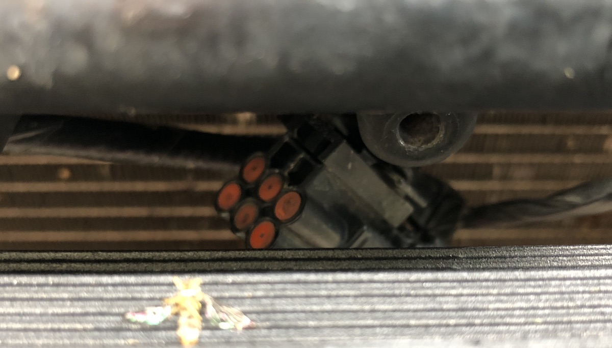

Searched several ways, no results that I can find. There is a six (I think six) pin connector behind the grill. Orange inserts into the female connections to seal them. Any idea what this thing is for?

A pic would help.
could be parking sensors or fog lights.

Okay, I will grab one. Its mounted high, just under the center catch latch area. Fog lights and parking sensors are installed and working.

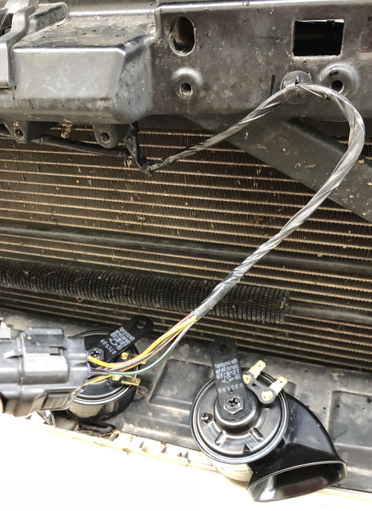

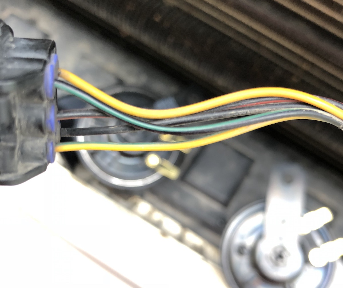

Pics - Its wrapped along with the horn wires as the harness goes behind the front frame.

original owner?
wondering if the truck originally had a factory brush guard with lights, or had a factory winch at one point. looks like that could be the connector for those, definitely looks factory

It is factory, the aux light have a separate harness, not bundled with the horns.
I never really noticed that connector. I will look now.

There is nothing on the build sheet about winch, lights, etc. And I would think if removed at some point that most people would not bother to insert those orange rubber plugs.
I dunno, I assumed everyone had this connector and I wondered what it could be. Sorta wondering if I could utilize it in some way for my modifications.

I just worked on an 08’, no plug.

Be good to know if it is not stock where is the location of a switch to activate what is connected to.

Could be this: (pollution sensor for some markets)
DISCO3.CO.UK - View topic - Unknown connector
