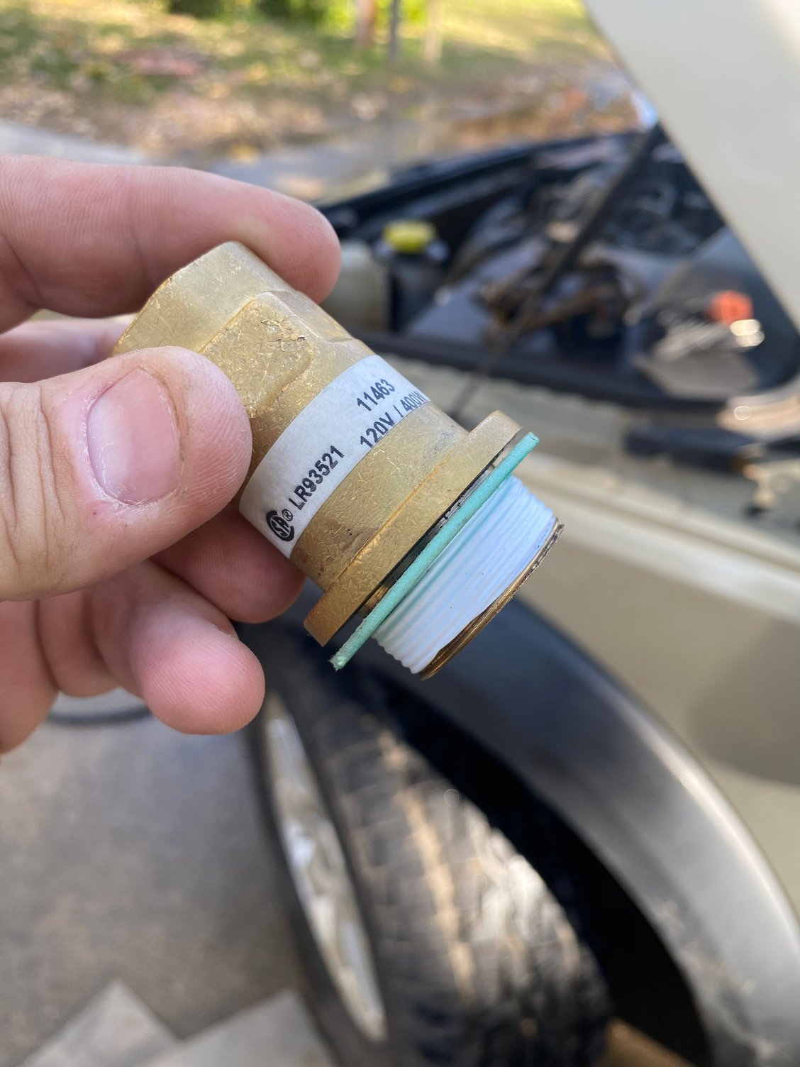

• For heater install, my Kat's used a 1 1/16" socket. You want a shallower one but one that get get over the plug portion of the heater. Its its too long, well there is just so little working room there.

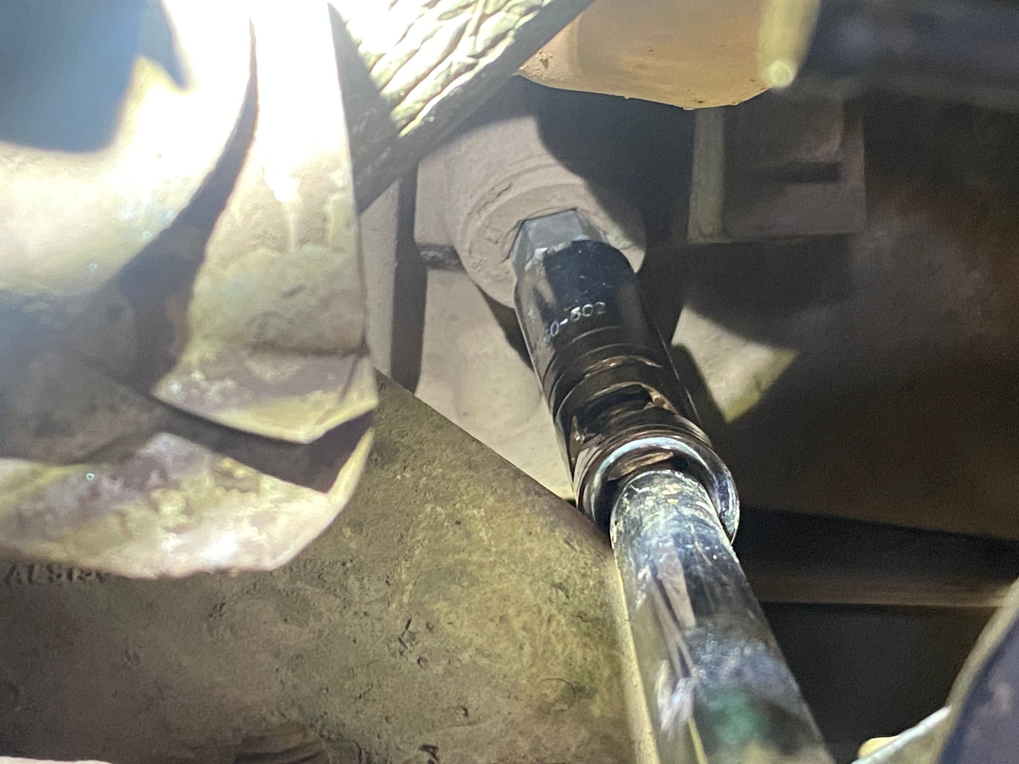

Removing the freeze plug is the hardest thing. Not because its tightly installed, it is, but because there is just no working room. My tools were all half inch drives. I had the 17mm socket, u-joint and extension. The distance from the plug to the engine mount is very limited and it was not easy wiggling the Allen bit into place. Then when backing out the back end of the u-joint would hit the mount. Its a trial and error and frustration thing, but you can get it. Once it is popped free from its initial hold, it comes out easy and you can work things around more to get it out. My path for removal was forward of the upper arms rear tower to frame. You can also try the other side of the upper arm frame. Just did not work for me. Oh, I used a 3-foot breaker to get it to initially break.

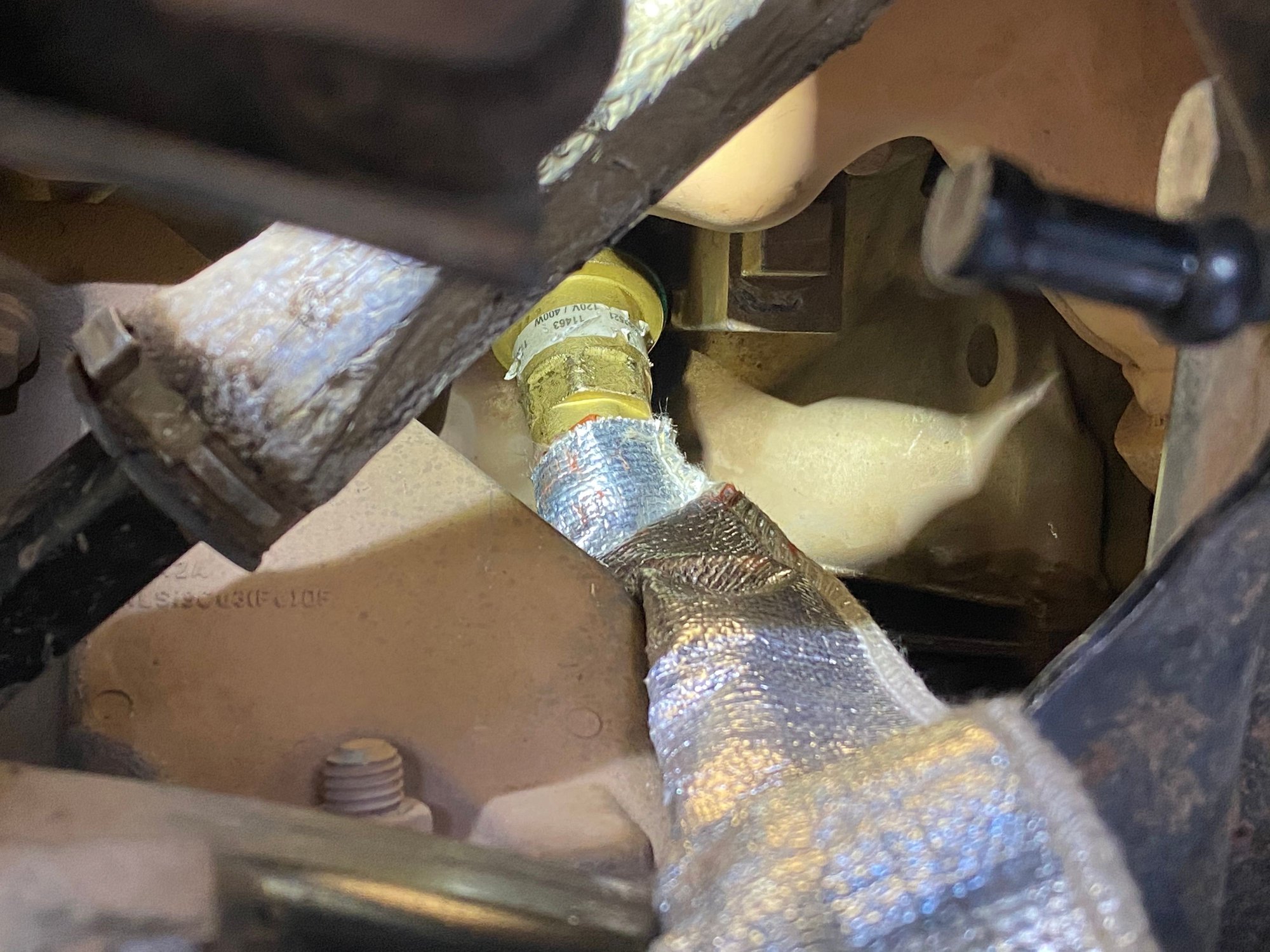

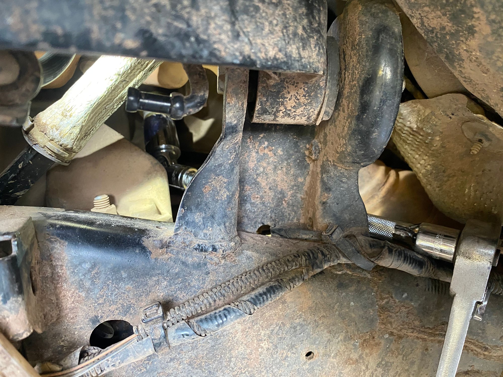

Install I did go behind the upper arm tower. This is when maybe removing the liner would help, but it would have done nothing for me. Same setup as removal with u-joint, etc. But now with socket. I did add teflon tape to the heater threads as a precaution. I also covered the first bit of cord with heat shield. And at the connection I put some high temp gasket maker to both seal the connection better and to keep it from falling out (I drive on corrugated roads). In the last pic, I did not route the cord that way when done, I went behind the upper arm's rear tower with a downward bend to keep it away from exhaust. Then several cable ties along the factory harness that is attached to the frame. My cord was not long enough to exit the truck at a good spot. So I will have to open the hood to plug in every time - will work out a better solution later.
