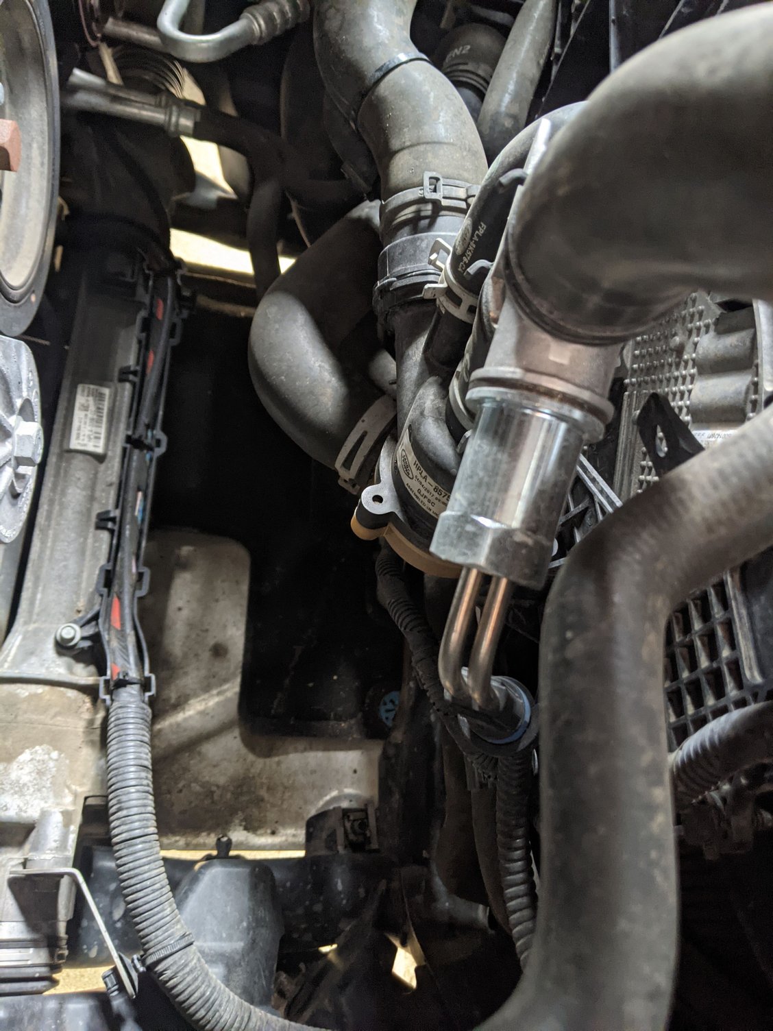

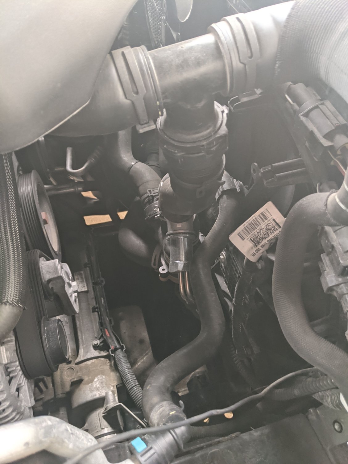

I installed one on my 2017. Goes into a radiator hose.
