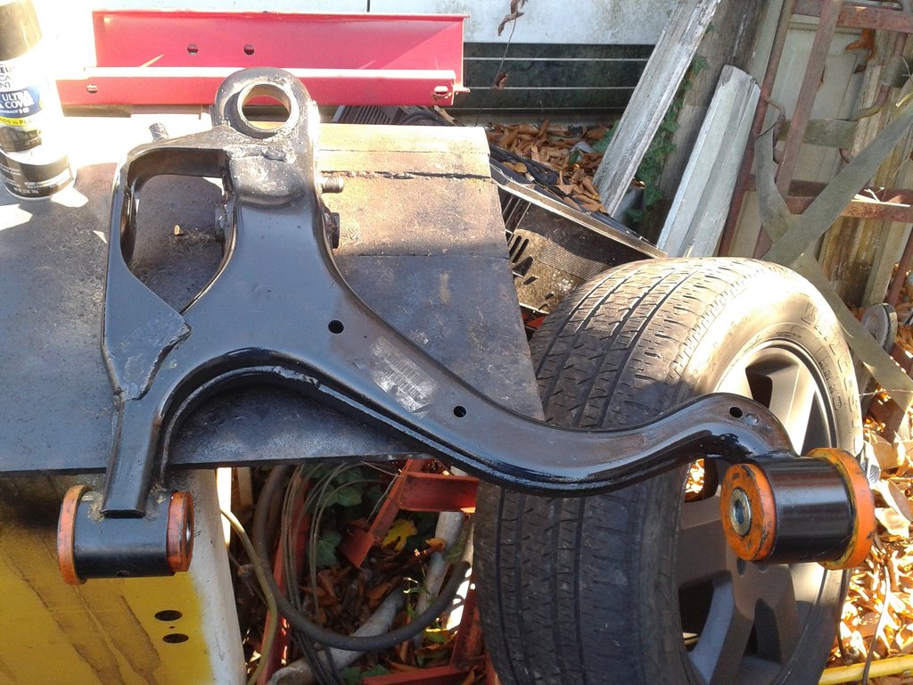

Pic of right front lower a arm

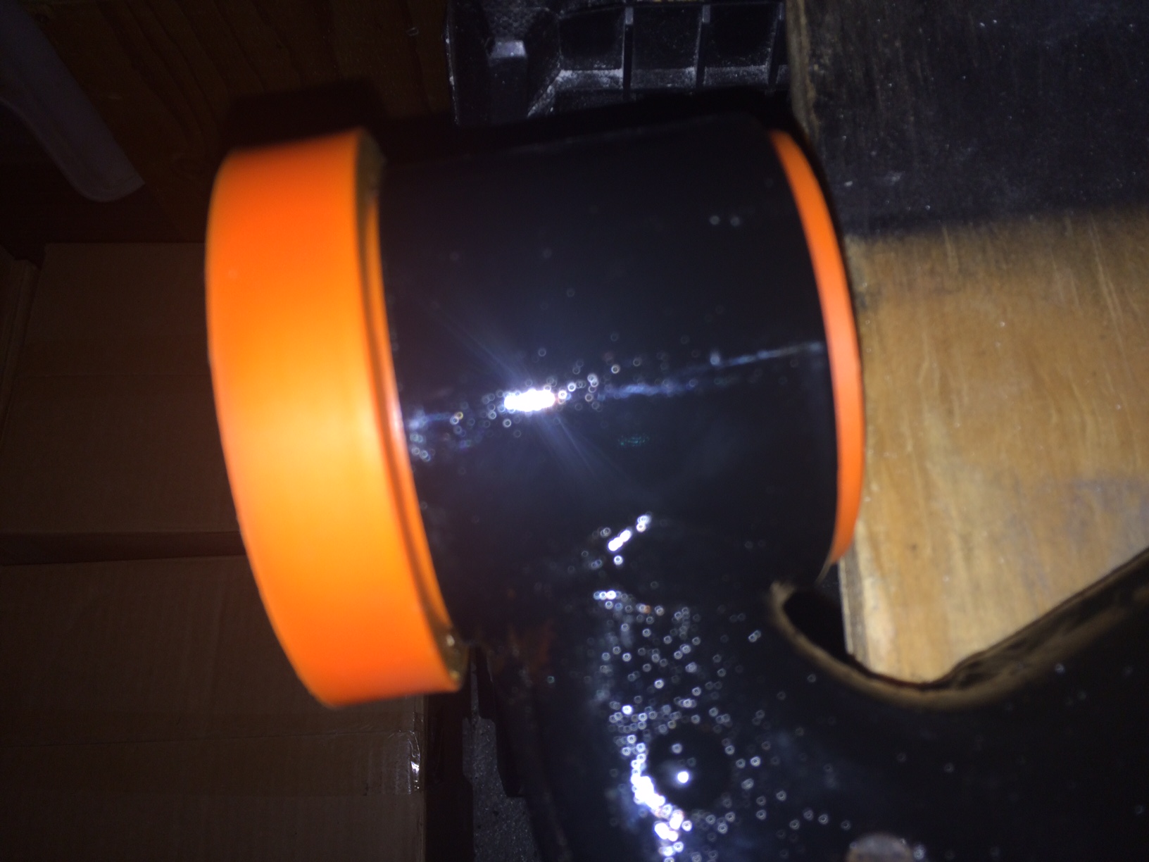

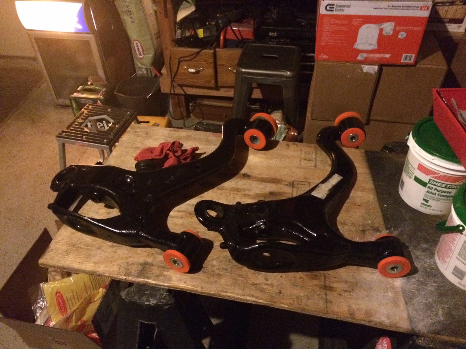

Default How flush?
I just installed polys on my lower control arms. Problem I'm having is that one of the bushings won't go all the way in flush. I've included a pic. I was wondering if you think it'll be ok to use if its not totally flush. Thanks.
Attached Thumbnails lr3 poly a arm bushings how to-img_8484.jpg   lr3 poly a arm bushings how to-img_8485.jpg

Looks like you only have maybe a mm from flush - I'm pretty sure you'll be OK with that.

Has to be flush IMO, hit with dead blow hammer, you know the orange plastic type filled with shot, did you lube them?

Yes, tap them in and you'll be fine. I am happy with mine so far. I only did the front lowers, the biggest culprit but plan to do the rest eventually.
Nope just banged them in like it said to do on the Atlantic British polybush video.
Should I remove them/lube them and start over? If yes, what lube would I use? Thanks.
