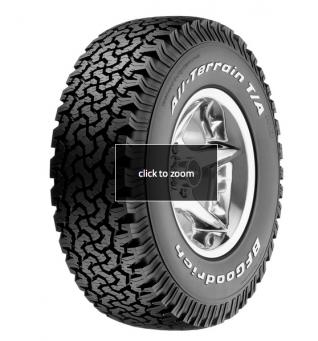

Tires installed are goodrich bfg ta ko 275/65r18. I installed them without installing the lift kit from Toddco. I heard from everyone that it will rub, and it did. It rubbed from the back tires on normal high when turning and getting in a dip. If i were to lower the car, it will for sure rub even more. The from tires barely fit as the tire will rub with the whole surface on a metal part (didnt check what part it was) but i knew that i needed to get the lift kit.

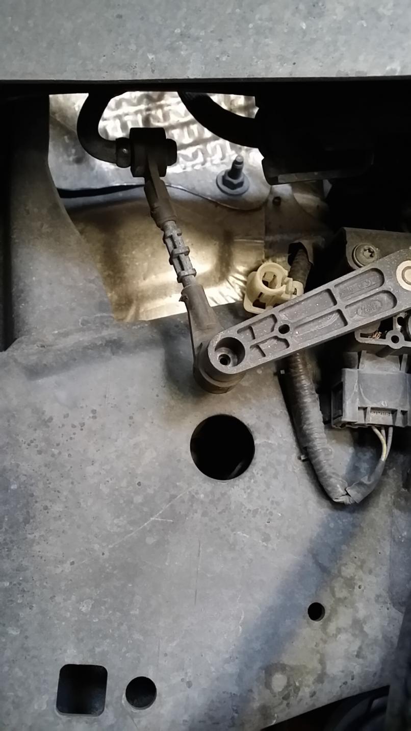

I tried looking for some videos on how to install the Lift Kit from Toddco on how to install them or how do they work. The toddco lift kit website doesnt have crap. So i kinda figure it out by my self. The front are small and the back are large. I compared them side by side and noticed that the toddco lift kit parts extended are the exact same size as the stock. So i thought, well i am sure they did it like that for a reason. So i made the toddco lift kit the smallest possible and thought that the computer on the car will think.....The car is to low, i need to lift it. (I set my car on normal height before doing any work).
After breaks installed, and tires back on. Turned on the car and noticed and the suspension was blank by the height selecting and then the lowest was selected, then i hit normal height and the car we up higher. I was so happy that it worked as i expected since i never seen anyone else do this.

Hey houm_wa,
Ive read that you dont need spacers to install the toddco lift kit.
Attached you will see 2 pics of the lift rods. I could not believe that the OEM were and look so cheap. The ones you purchase from any one else would be so much better, (but it doesnt matter because they dont carry any load).
As you can see on the replaced ones, i made them the smallest so that i can get the most height. I will be testing them with the maximus height and see how that goes, i can always make them larger to get less lift.
Becareful when changing them, as the bottom part holding the rod is plastic. Try not to move it back and forth as you can break it. Just hold it with your hand, while using a flat screw driver to get the part out.
