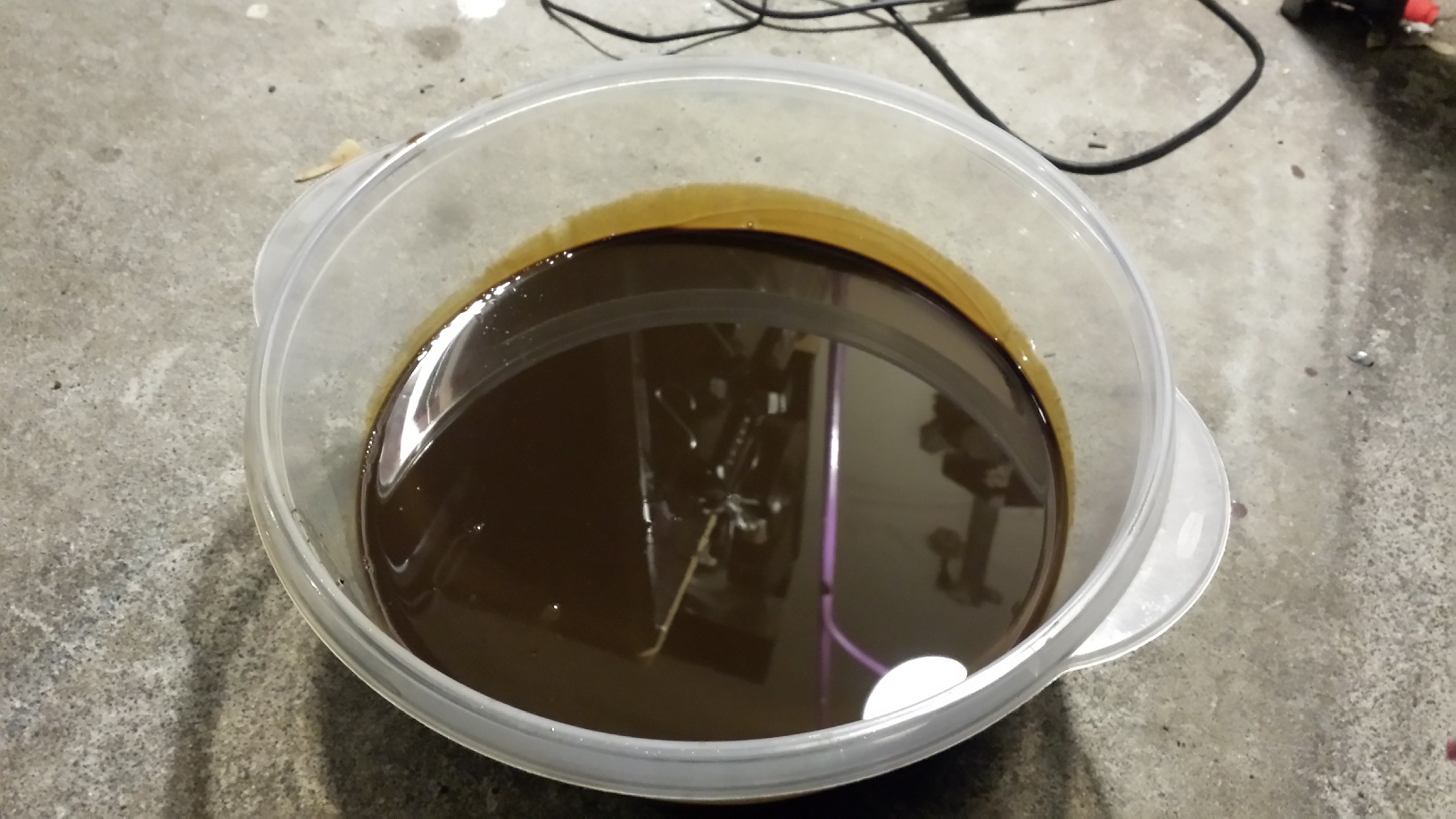

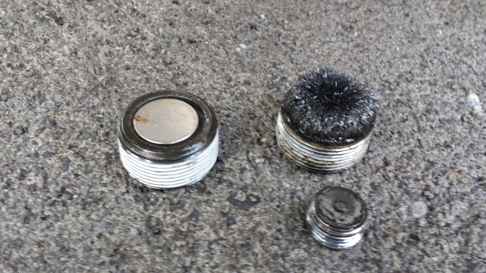

Mine has a "machine whining" noise, most noticeable between 25-55 mph. The best way to detect it is to put it on the rack and let somebody drive it, then use stethoscope to find what's making noise. When they do that make sure pull the fuse F26E out, so the suspension compressor wont mess up. I thought mine was front diff, but turned out to be the T case.
One thing Im different from you is the noise will NOT change if I remove throttle, full throttle, or even put in netrual, it's only speed sensitive. So I was sure mine was not engine or transmission. My fluid were all really dirty
