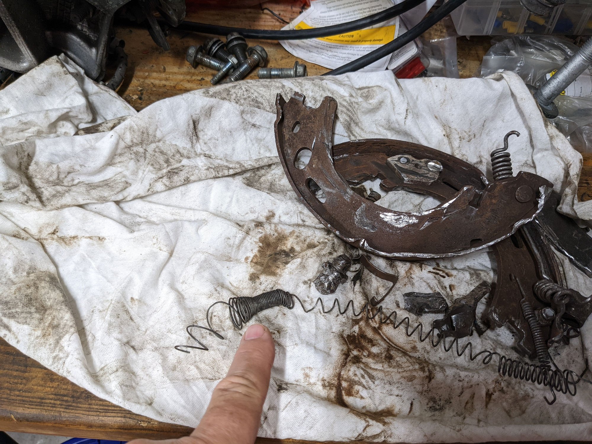

Like many others, I finally had a minor issue with the parking brake on my 2008.
Anyway to the point, I need the part number and source for the spring that covers the parking brake cable the enters the backing plate. I even looked at the dealership parts sites. I am sure it is there, I am just missing it.
Not sure, but may not be able to re-use this. As for the other parts? I think the small hex nut is about all that is salvageable.
Here is where it comes in at the backing plate

You may need to go with a kit, like I probably have to do since I have to rebuild my parking brakes from the ground up.
https://www.roverparts.com/brakes/pi...ews/SMN500020/

THANKS. See, How did I miss that? I got the other one that had the brake shoes and all the other parts from AB (the picture did not show these parts though), but I did not see this. It is ordered and on its way.

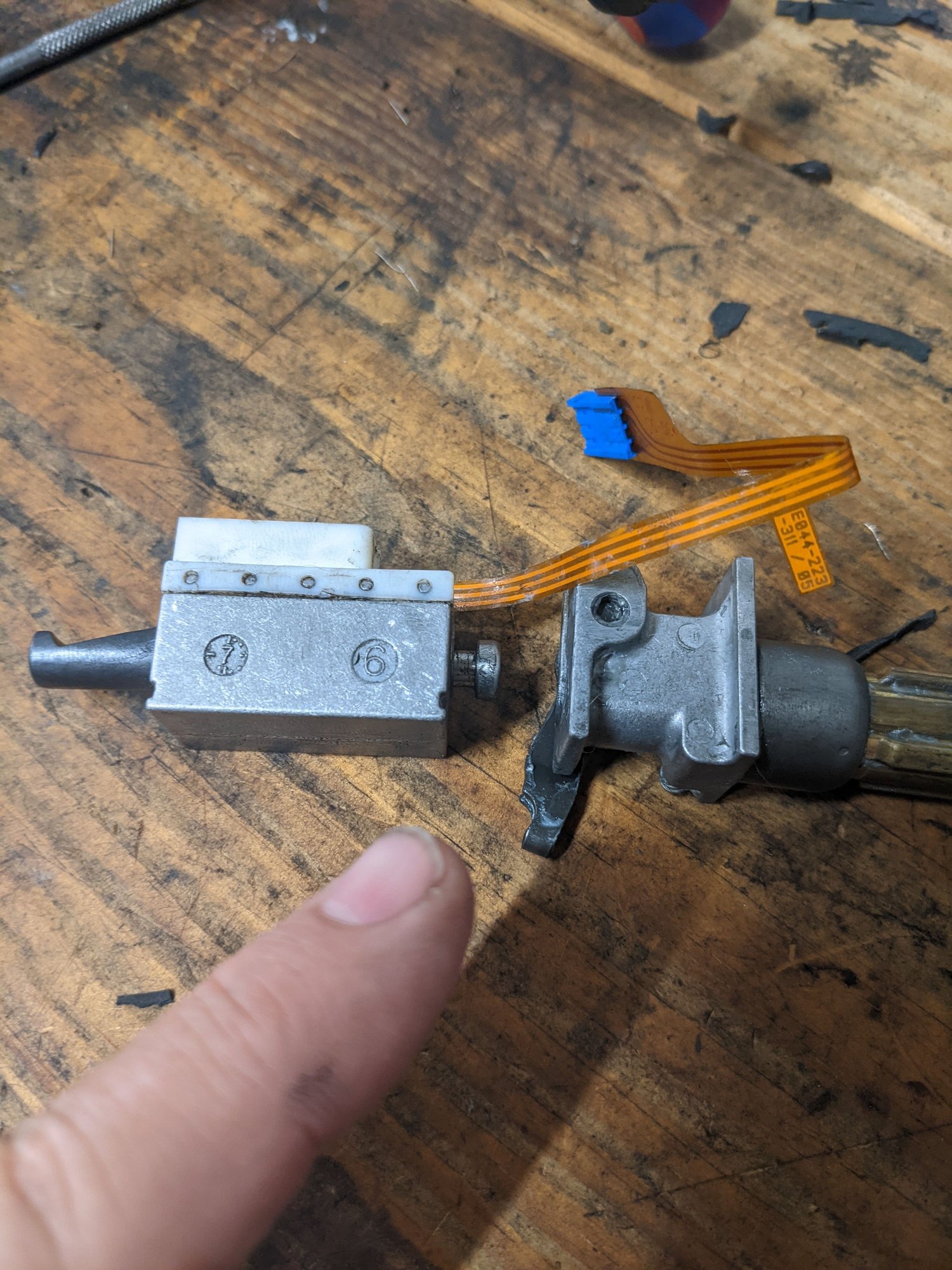

OK, The parking brake module is out. I now have enough money in the swear jar to buy an adult beverage when this is over. The adjusting screw (the one that only screws in 5 turns) was all the way in. I checked the gears and they looked fine, but the little part does not want to stay connected to the big part.
See my pictures below. Should I be able to just pull them apart by hand?
Will this work just pressed in, or do I need a new module?

I got the parking brake module back in. I made the mistake of not running a wire or cord along the cable before I removed the module, but other after a few tries, I had it where it belongs (I think).
I got the brake shoes installed and adjusted per the manual. which seems to translate to "just tight enough not to move, then back off 10 click (or one full turn).
