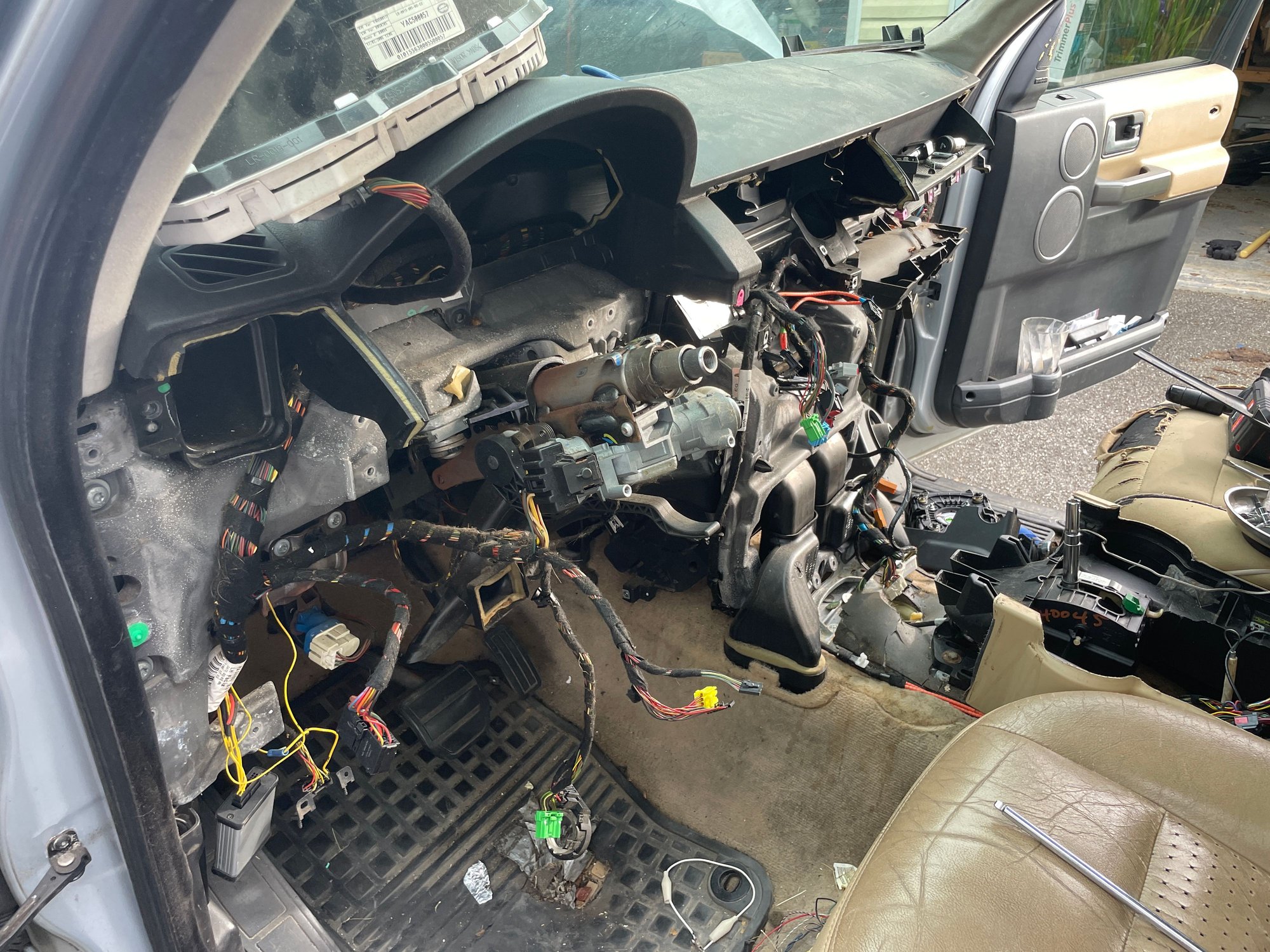

well… the stepper motors have been conquered.
It was a long, but not hard process. So. many. steps. In the end, it was the motor on the driver side that controls that damper that goes to the footwell - the arm has become unattached.
the reassembly went much quicker, but i’m still not over the hump. the car will not move from park. The code says solenoid circuit is open, or something to that effect.
Any ideas? I’m guessing i just messed with something i shouldn’t have - the question is what, and where.
good times :/

Brake pedal switch? That's my first guess, but maybe you've already checked that. That looks like one heck of a mess!

P-Bod is right, check the brake switch under the dash first. Also, I see yellow paint on the shifter, did you change that or was it there when you bought the car? Why was it changed out?
With engine on and your hand on the shifter, you should "feel the solenoid in the shifter disengage when you press the brake pedal. Is this happening? Check the connection at the right rear of the shifter to make sure it is fitted tight. You may have to use the emergency cable to get it into neutral and then put it back into park and see if it will disengage.
Other than that, I am out of ideas for today. I will keep thinking about it, maybe something will come to mind this afternoon.

Hi. I went to the Brake Light switch too. It arrived today. Will report back when it’s installed.

No dice with Brake Light switch. I’ll get in there and check the harnesses and see if i missed something. :/

Try to use the small cable by the shifter to get it into neutral. This may be a chance to see if the shifter is the issue or not. Once in neutral put it back into park and see if it will work then.
