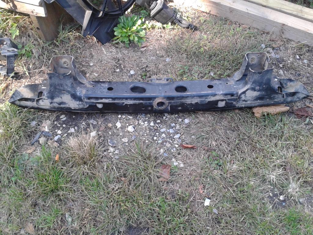

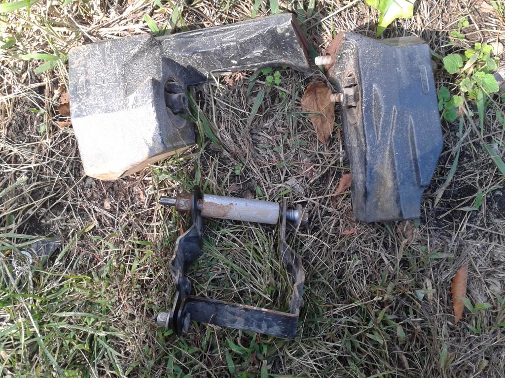

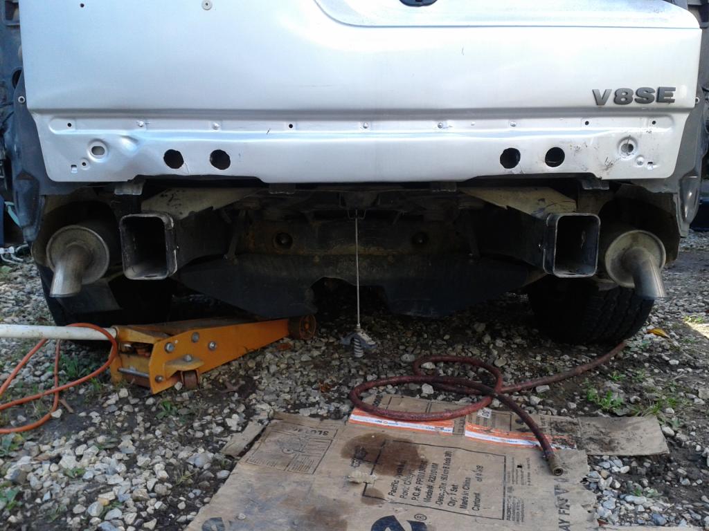

06 bumper removed
Rear bumper top view

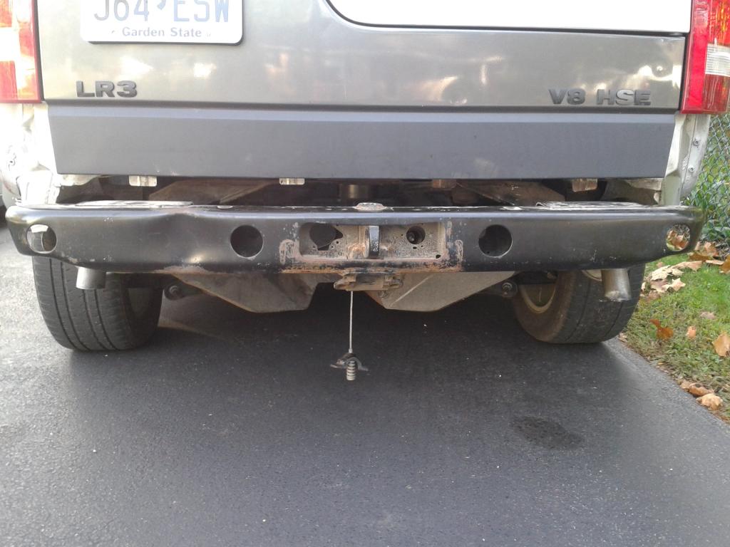

Rear frame vibration damper with bracket

This is why you run a vin check guy wanted 10k for this 50k mile 05 I ran a carfax on the spot showed him and crawled under saw the damage and pointed it out, he knew it and was not gonna tell me, this made it a $5k rover
The 06 I ran a vin check it was fine no reported wrecks
If I did not have the 06 sitting here she could have drove it how it was I am just ocd on car stuff and want it to be right, sucks neither came with the hitch although the 05 bumper would have fell off lol

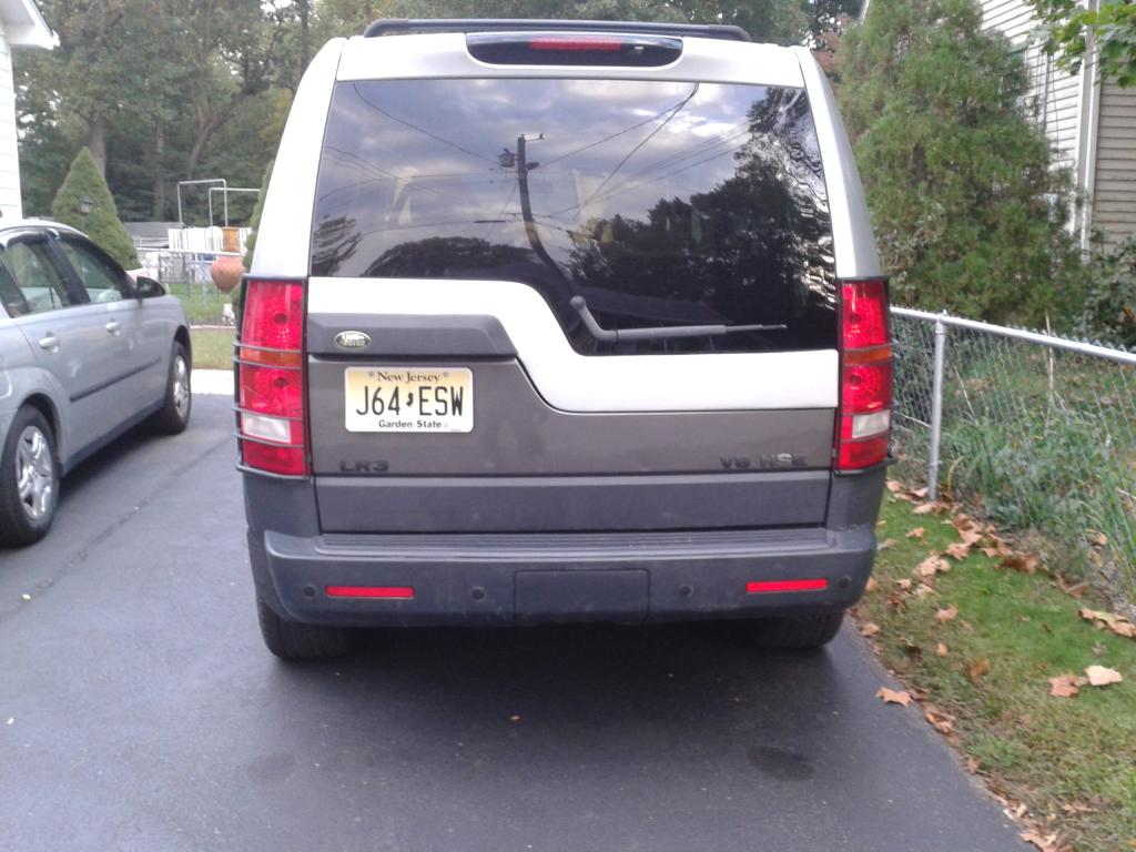

Pic of bumper welded on and finished product properly resembled
Now if I want we can get a hitch adapter and tow, also now no worries of being rear ended with an already crushed bumper

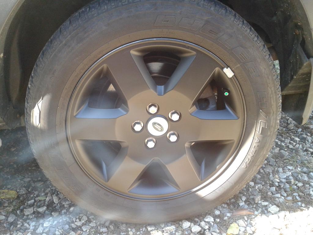

Wife wanted black wheels so black plastic dip looks great

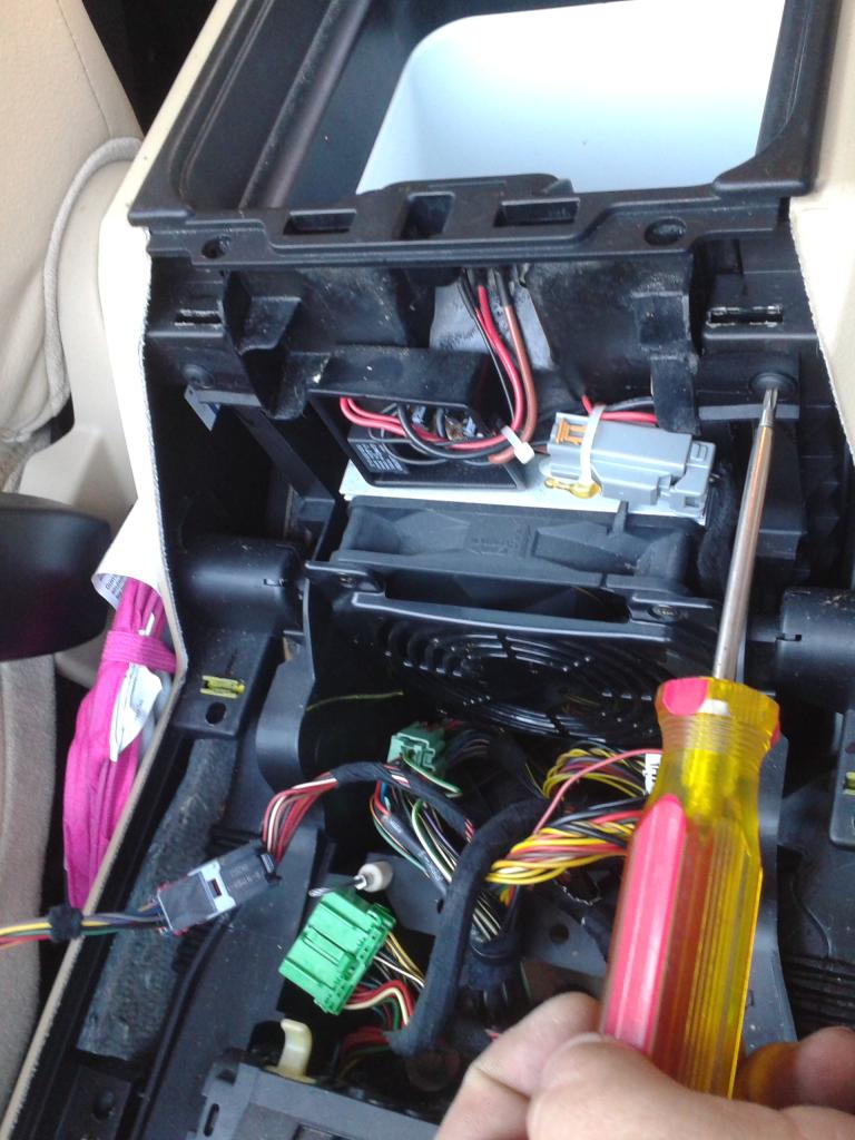

fridge install
ok this is easy to do
block wheels
put shifter in neutral, pull up and twist on shifter handle it pops off
there is a screw in front of the park brake lever, it can be Phillips or torx, remove it
flip open console lid, remove the rubber mat under the ashtray area
now grab and pull up the top of the console on the sides where the top and bottom halves meet it is hard to remove but will come off
you can now lift it high enough to get past the shifter stalk and rotate it clockwise 90* , the wiring is tight so be careful, I unplugged it all to get the cover off all the way
there are 3 plugs; park brake, shift lights, off road selector ( this one was hard to remove had to use a screwdriver to ease it out)

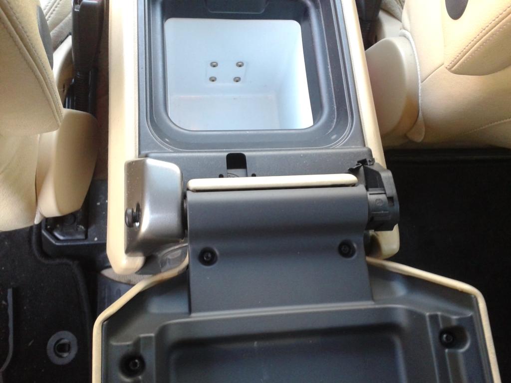

now there are 2 screws in the front one on each side at front of the glove box ( see pic)
next put both front seats forward, take a torx remove both console lid hinge bolts, and the hinge caps ( see pic)
now grab the cubby box and pull up hard it has clips on bottom
last locate the fridge plug, it will have a piece of foam wrapped around it, drop in the fridge and reverse procedure

pic remove screws and caps for lid hinges, that hole in the fridge flange is for the factory satellite radio
