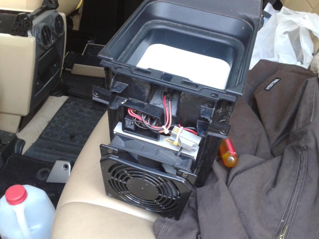

fridge out

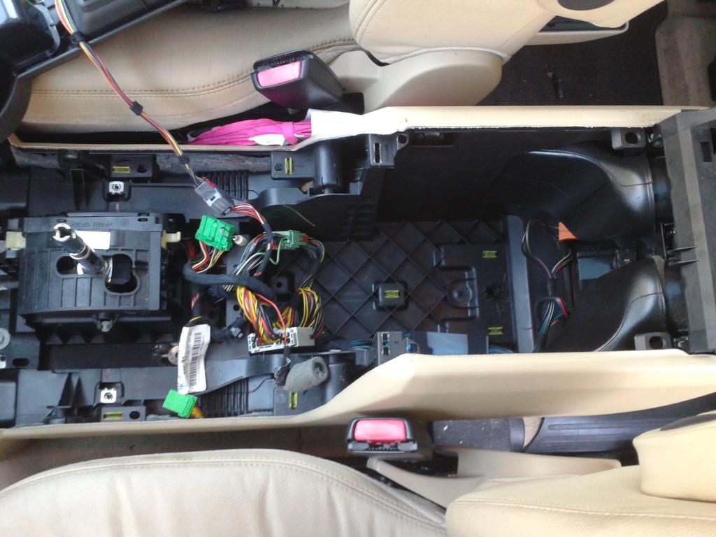

empty console
see the grey foam near the driver seat belt that the plug just ditch the foam and untape it from the harness to get slack

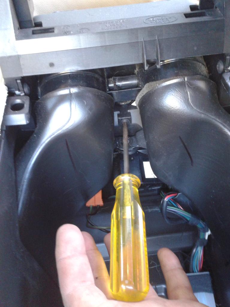

now if you want to remove the rear panel on the console this is the time to do it since the cubby hides this screw, unscrew it and pull straight back on the rear panel it will come off
the plugs are under there for the rear heated seat buttons they are green but covered in foam

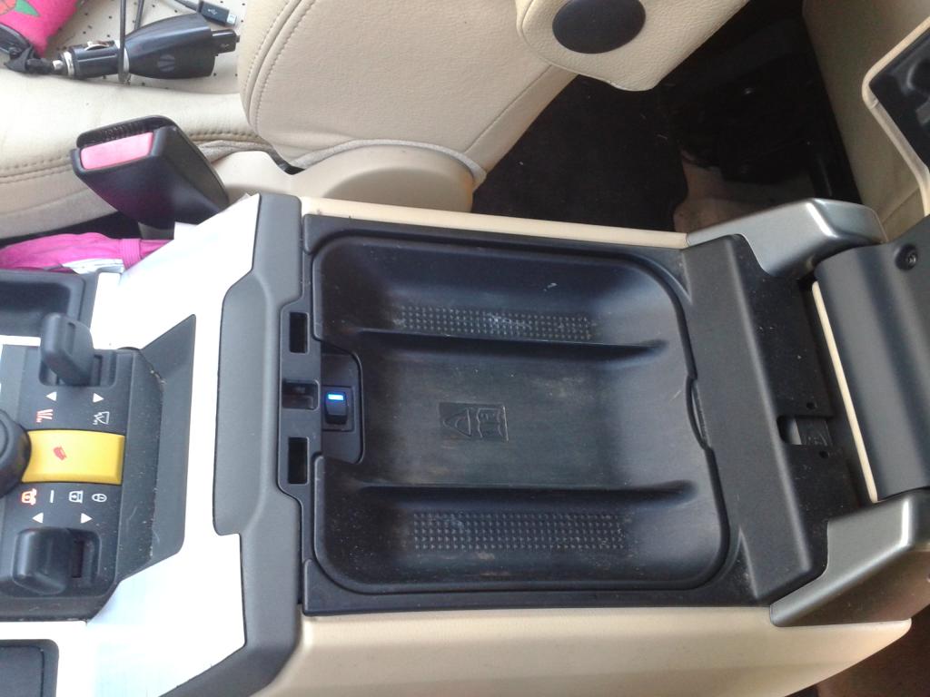

installed with the coin tray installed and turned on, it takes a second or so for the switch to light up, I also think it only works with engine running gets real cold real fast few minutes maybe

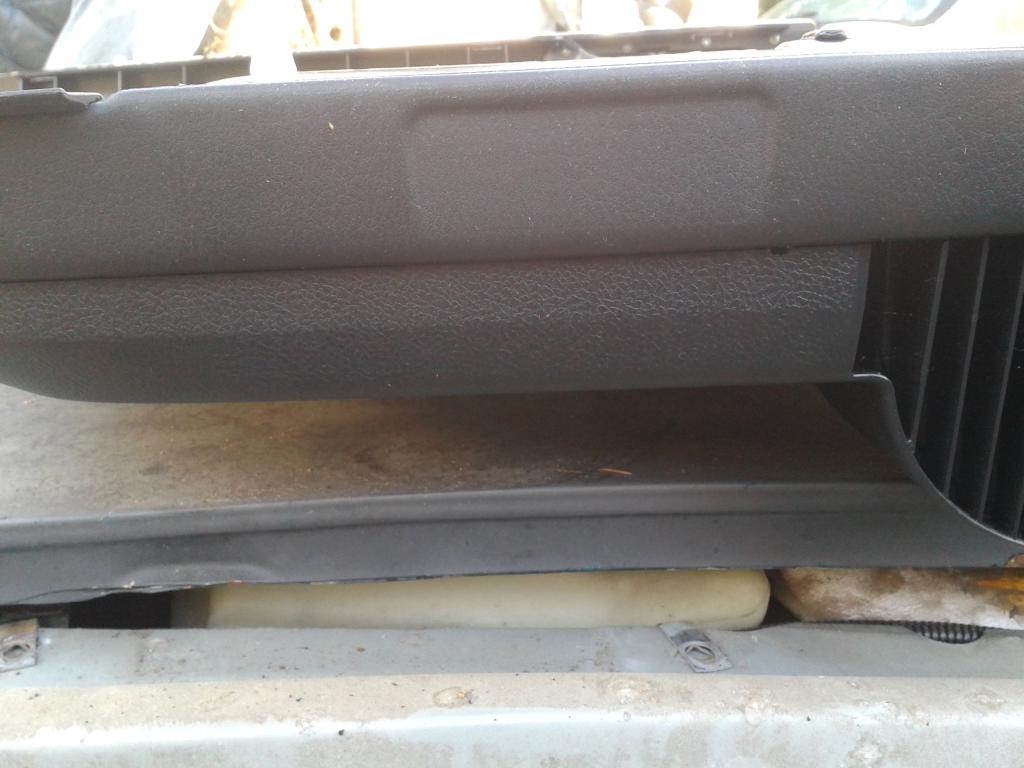

adding the puddle /entry lights easy but takes some time since you have to remove all 4 door panels
see the indent in bottom of panels

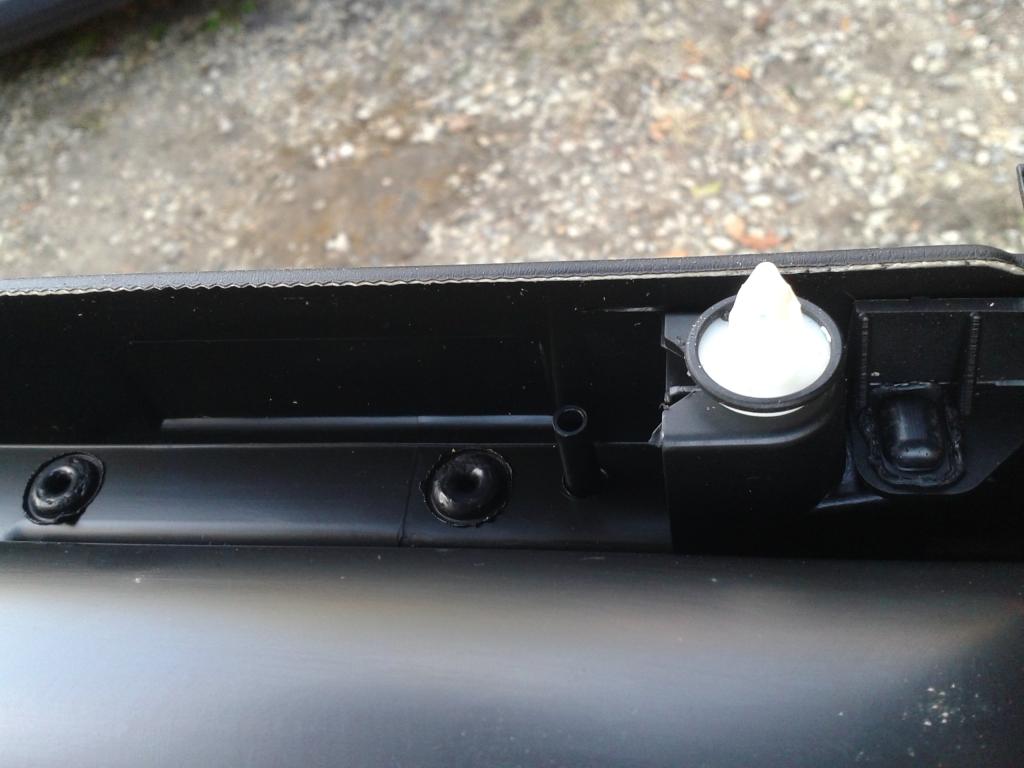

inside there is a line molded to show where to cut

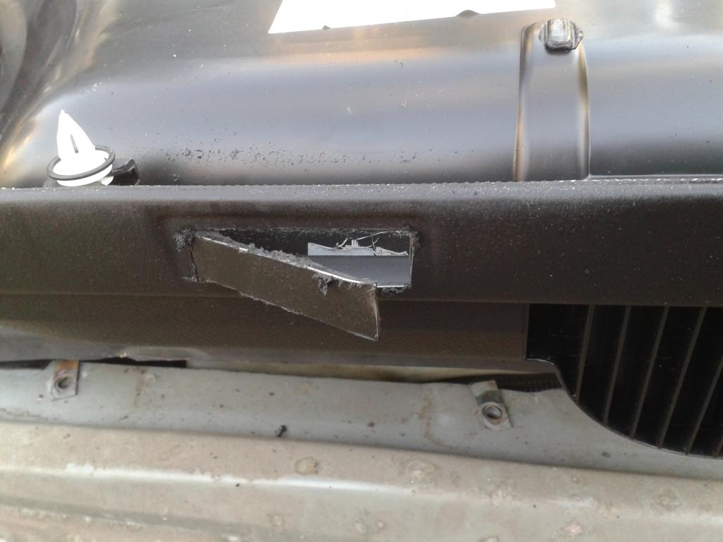

cut out with dremel, don't go nuts you can always make the hole bigger

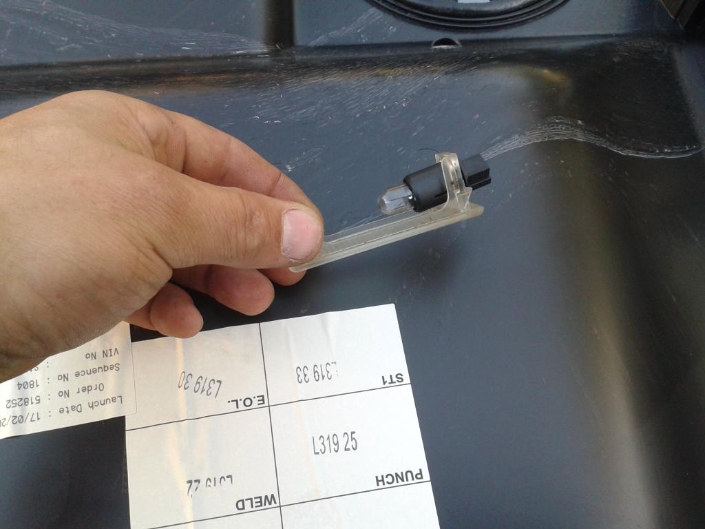

here is the light

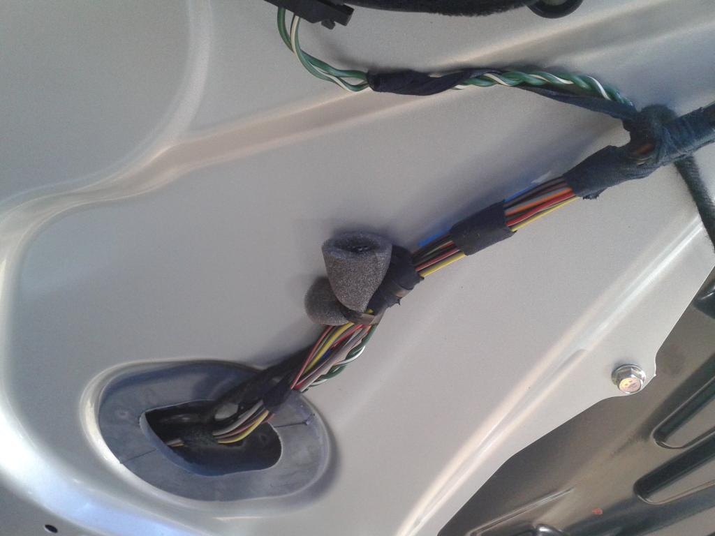

plug is in that gray foam, also untape from harness

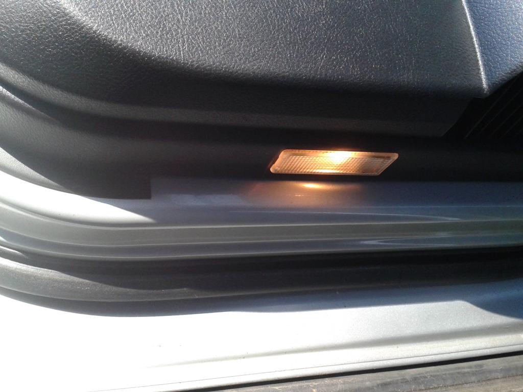

installed and working actually put out a surprising amount of light at night
