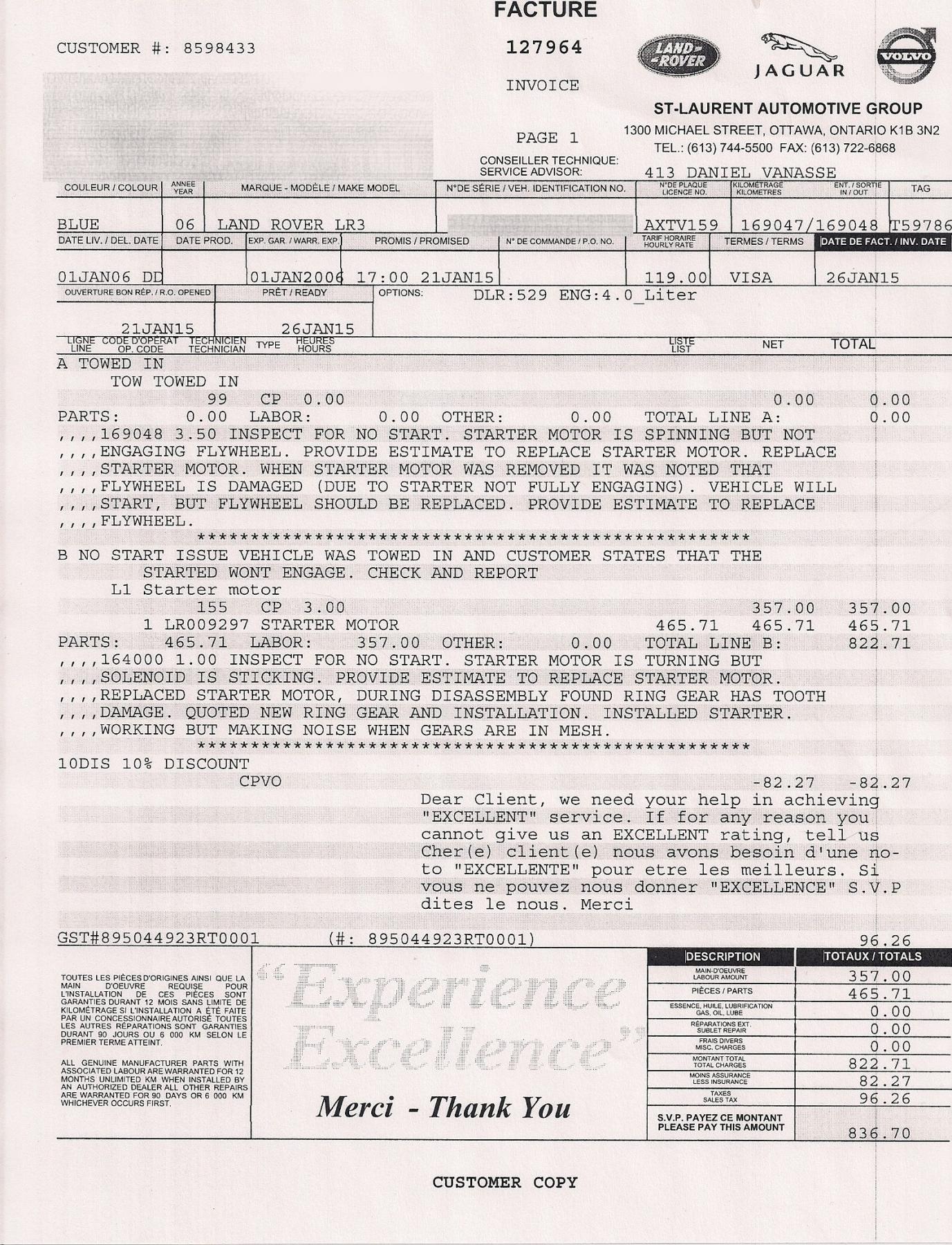

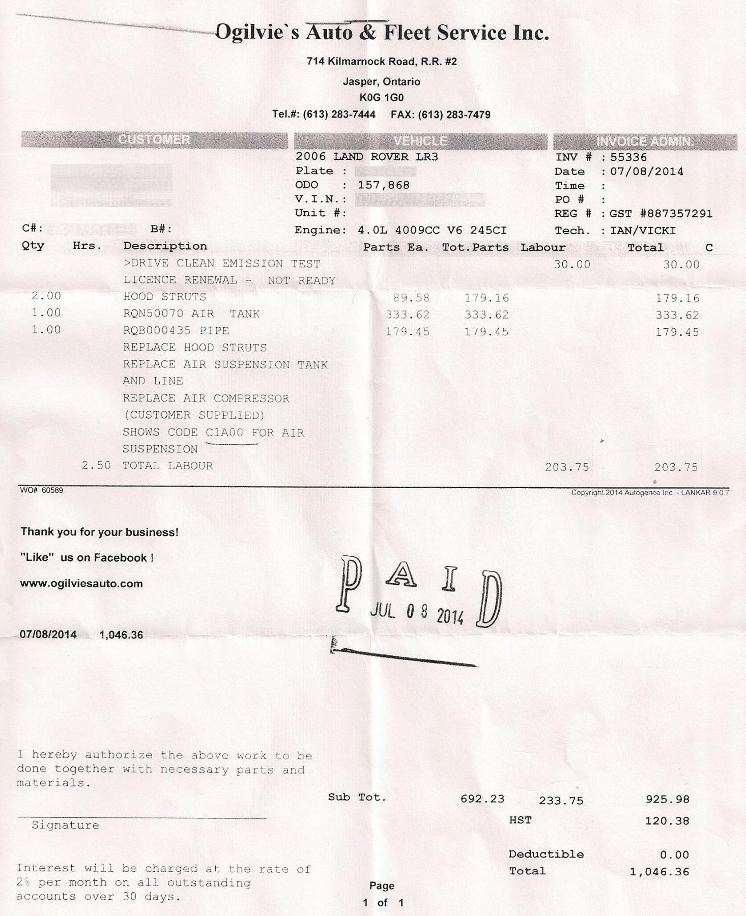

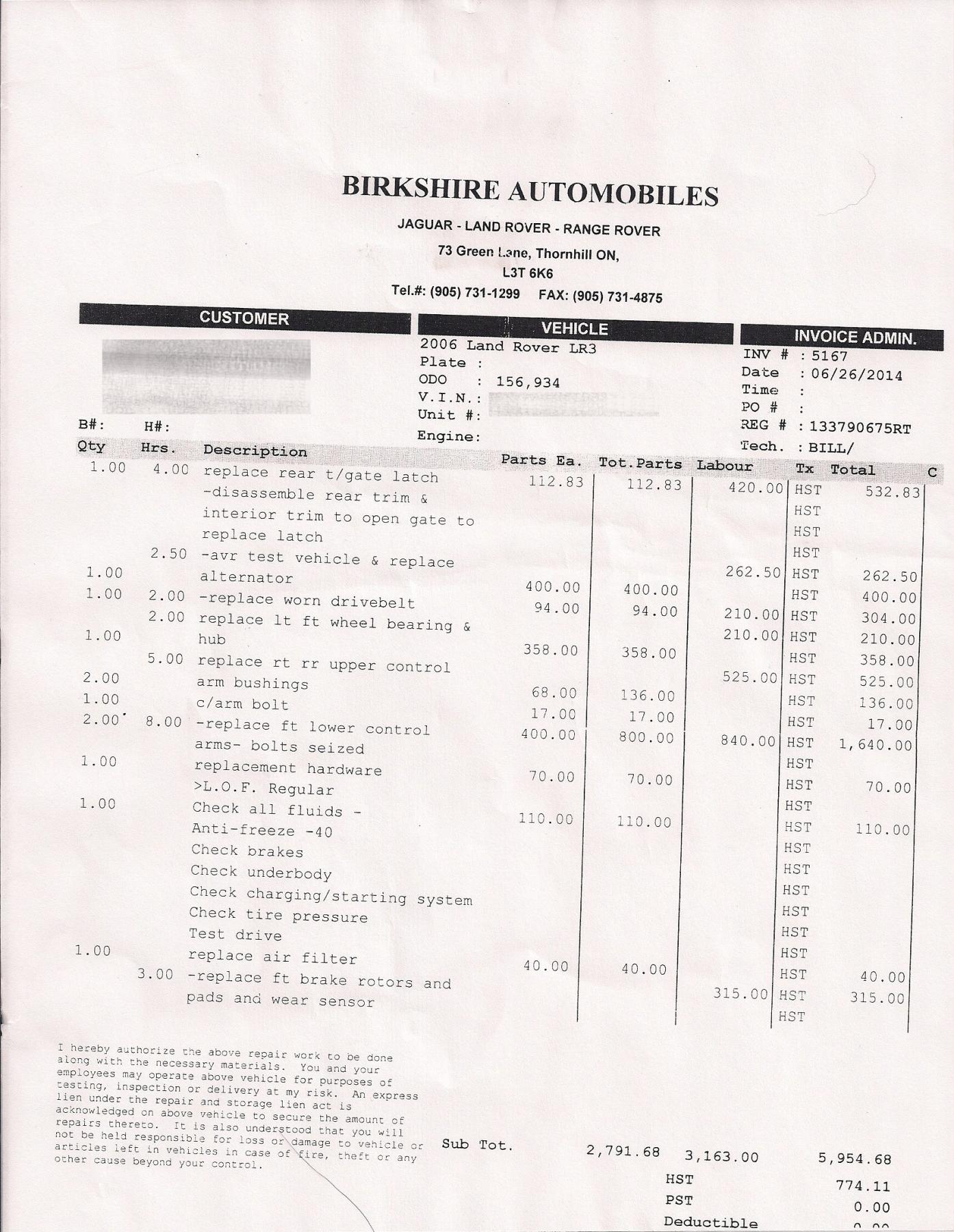

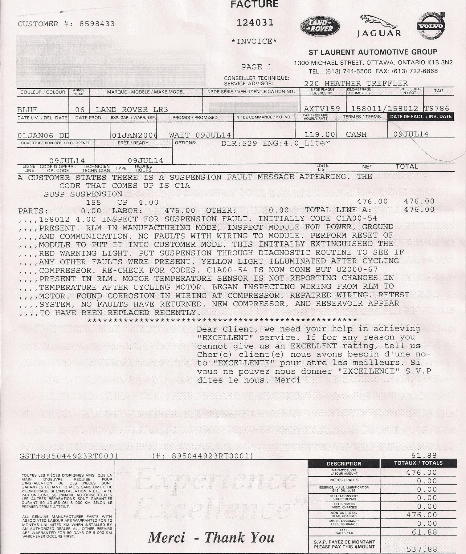

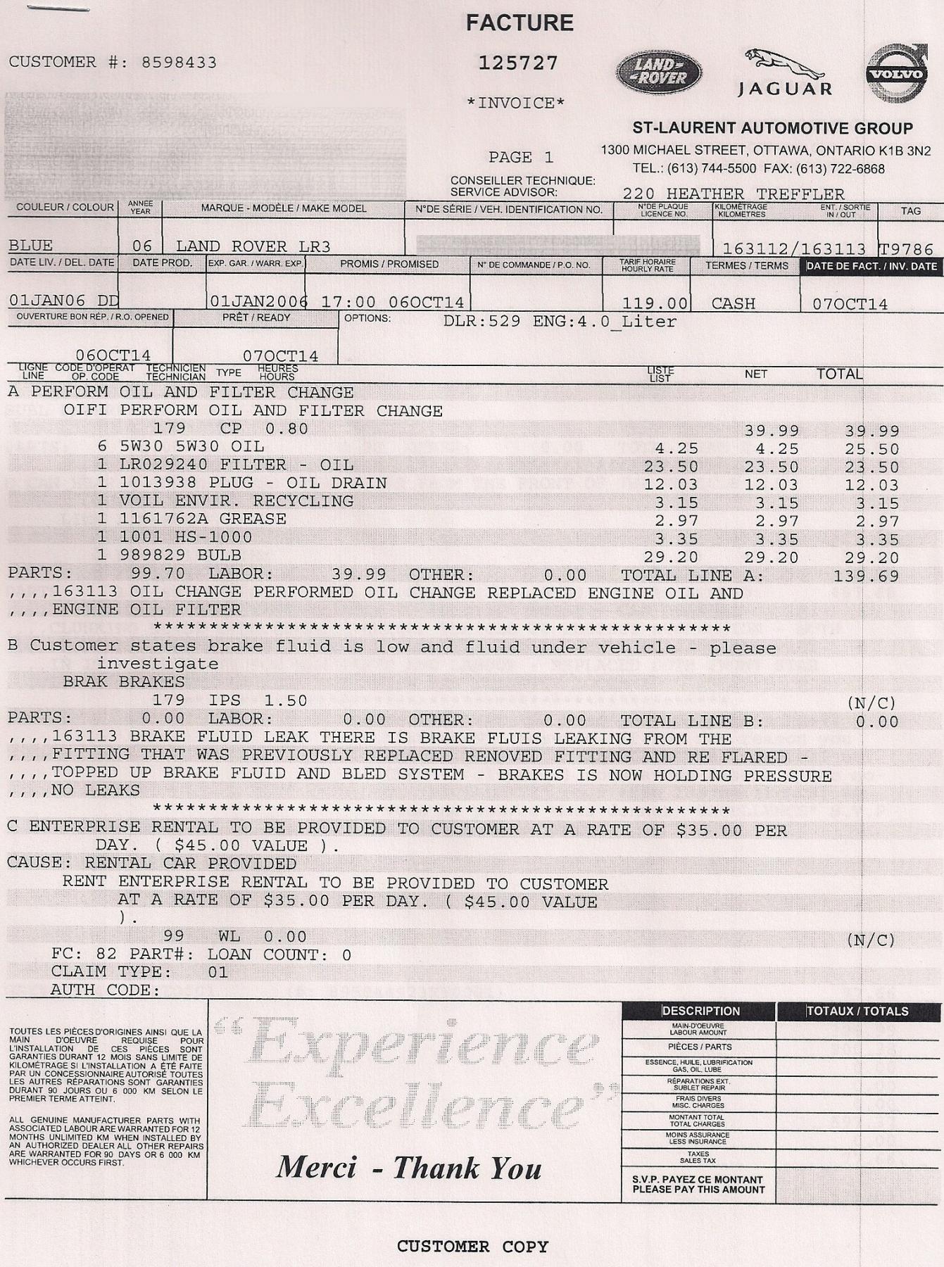

Hello,

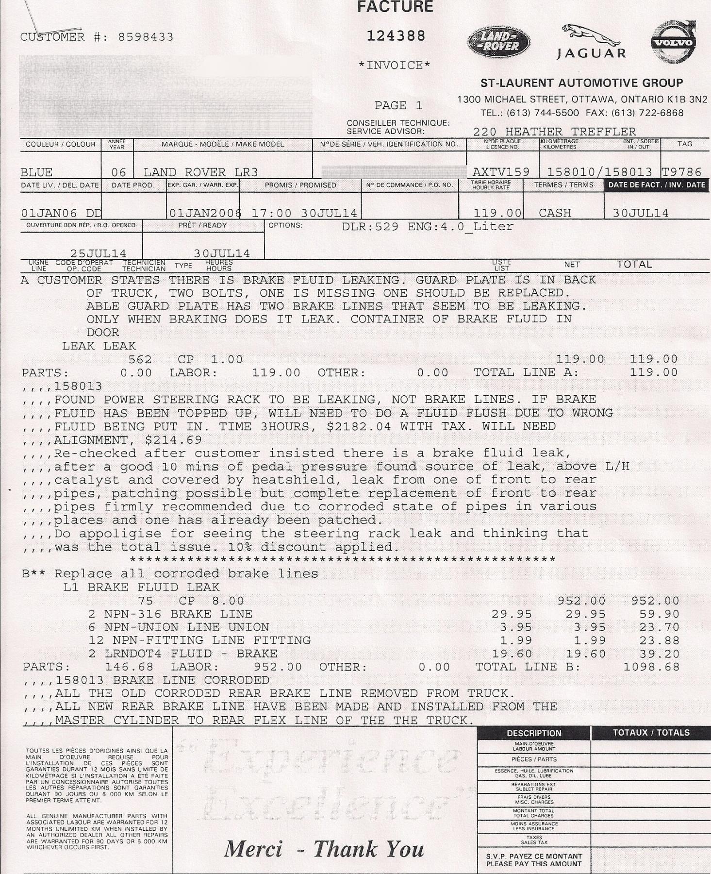

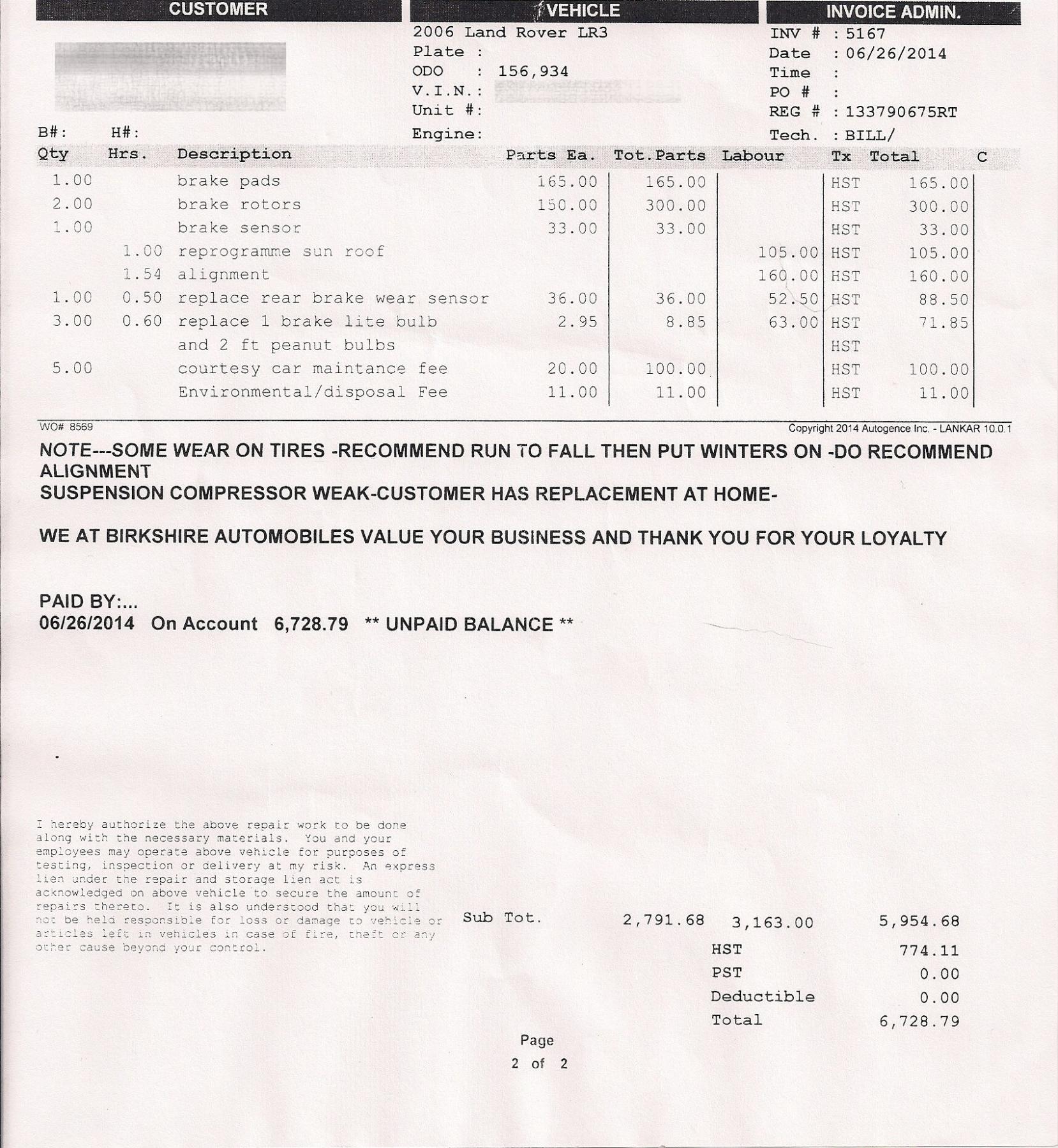

New owner of a 2006 LR3 SE V6 with Heavy Duty option and cold climate packages. It has 169000 km on it (105k miles). Previous owner dumped $15.5k CDN ($12.4kUS) since June 2014. Huge amount of that was labour. Some of it was because of being in the rust belt. Some highlights of things replaced:
- Both Front Lower control arms and hardware
- Front rotors/pads
- Steering rack and lines
- All hard brake lines
- Suspension compressor, tank (rusted out and leaked)
- alternator, drive belt
- starter and flexplate
- tailgate latch
Attached the receipts to give prospective buyers an idea of what they should look for.

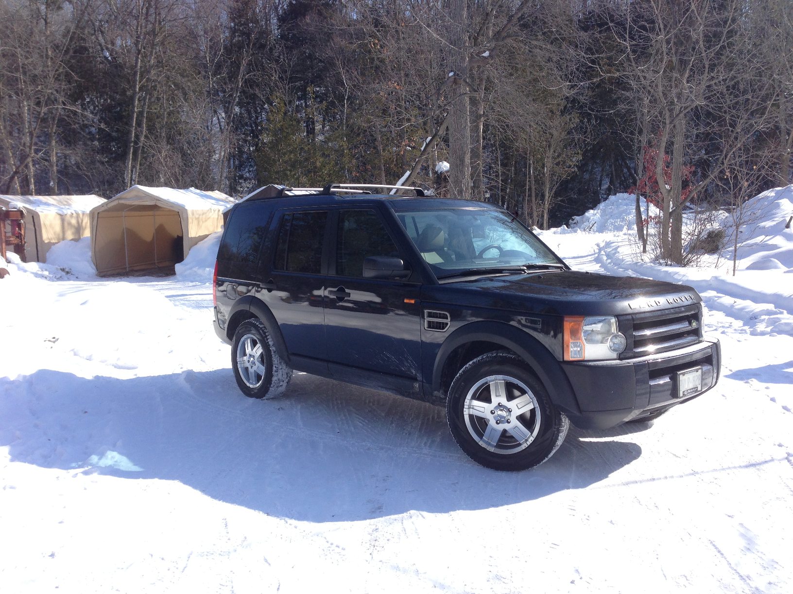

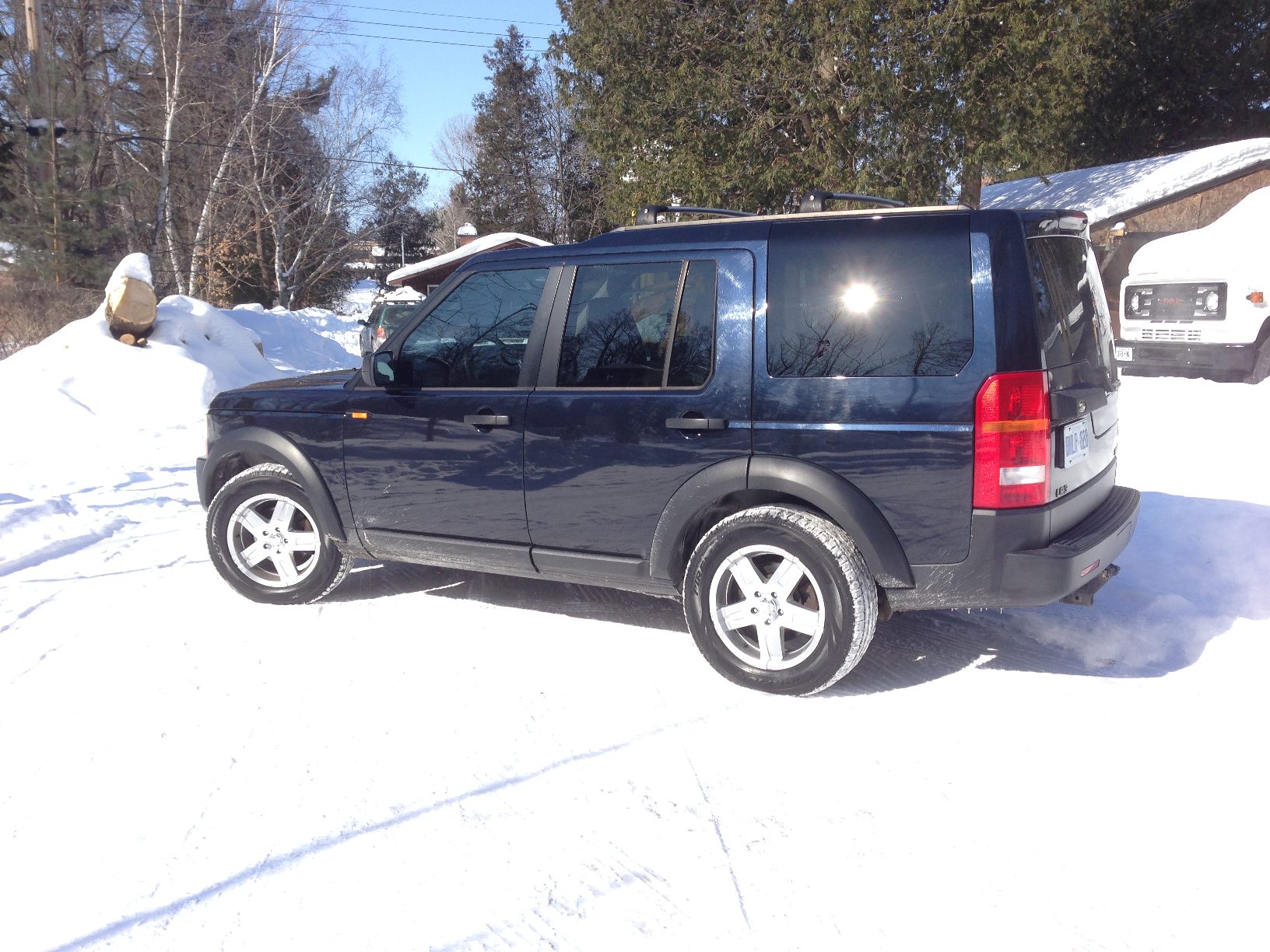

Came with second set of rims with winters, summer on stock 18" but the tires are shot. Has hitch and LR cross bars.
Paid $9000 CDN ($7200 US).
Used to offroad in a '91 F350 with Detroit lockers in both axles and 35" super swampers. Probably be a bit before I take the LR3 off road, but it does drive a lot nicer than the F350. Got it detailed and the interior came out pretty nice, has aged well.

I believe the "had enough" moment was the service it was in for when they put it up for sale. If you look at the last bill you'll see they were not charged labour. They had expected to pay it (quoted over $3k) but the dealer for whatever reason chose not to charge it. It was in to have the flexplate replaced, so dropping the trans. If they would have been charged the labour that would have been over $18k in 9 months.
