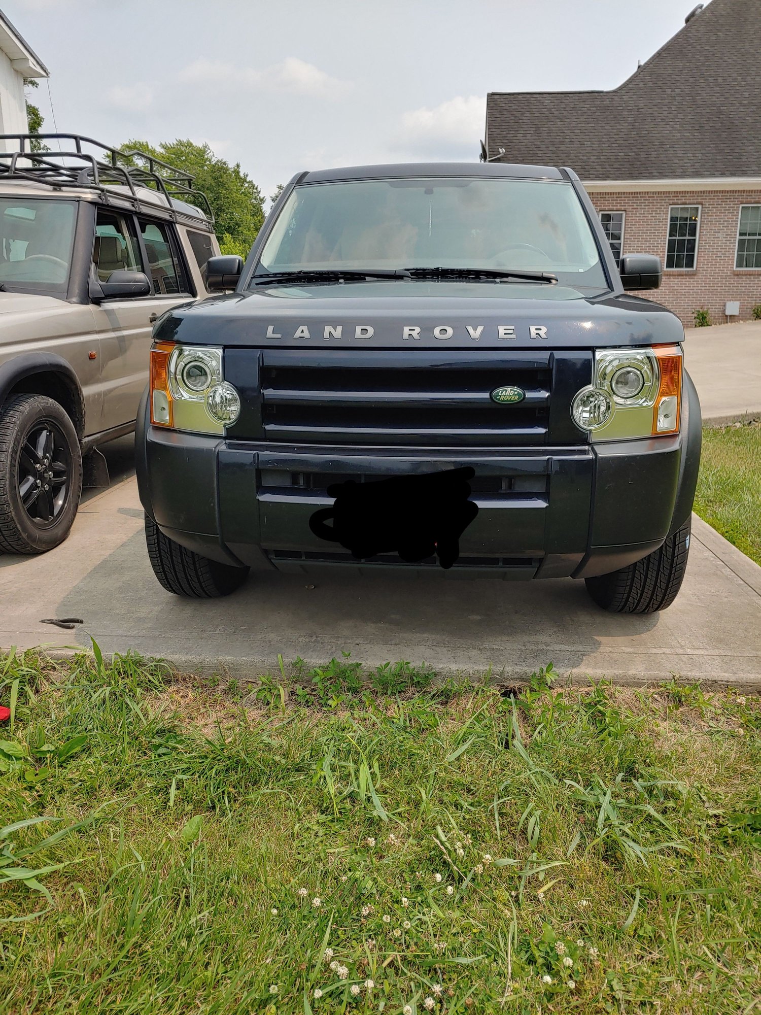

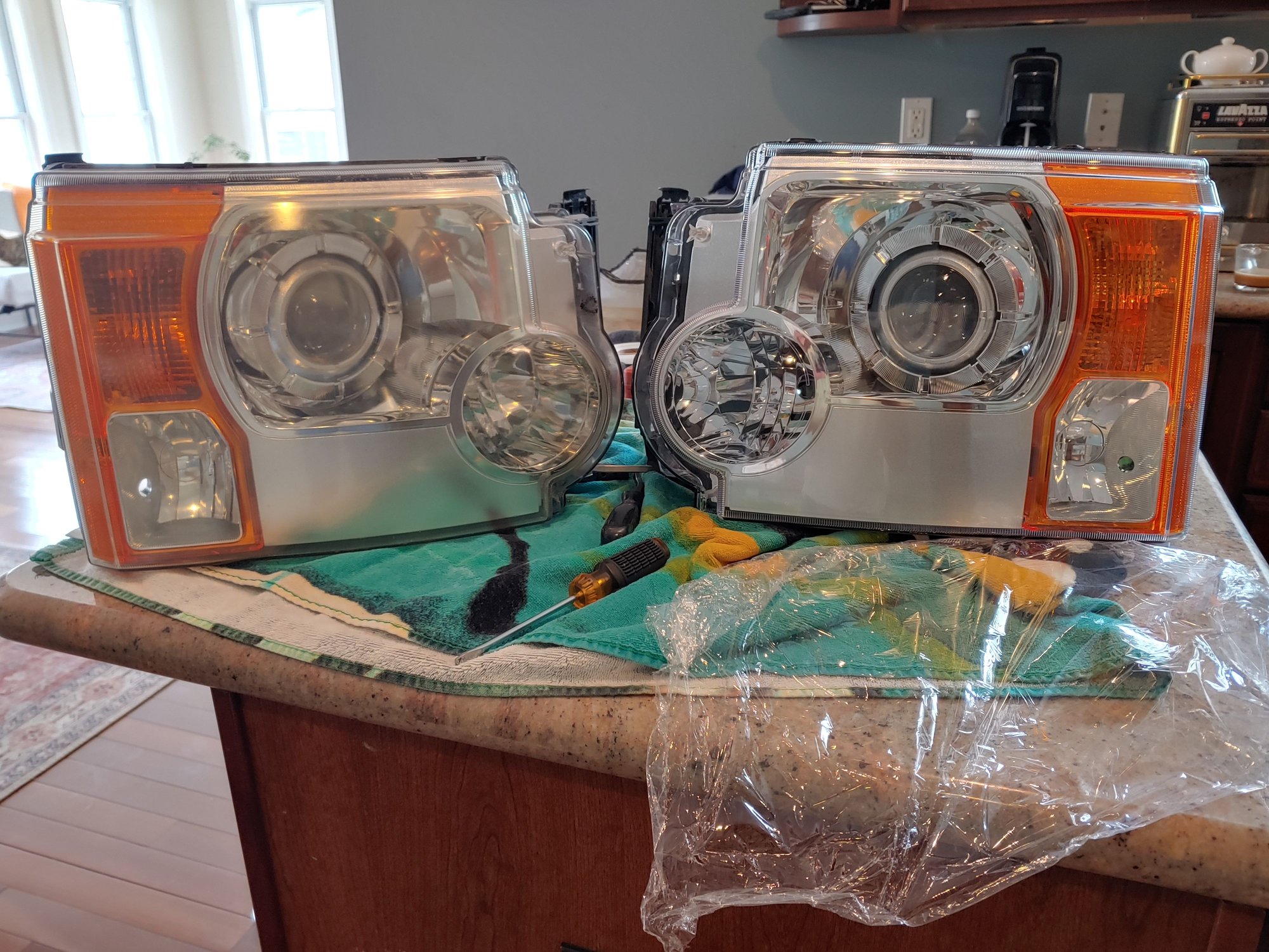

Hi LR3 friends. Put new headlight shells I bought off AliExpress was about $110 USD took 3 wks to get to me in the Midwest. About 4 hrs to replace. The picture in my kitchen shows old and new. I polished the old ones last year. This is the link from AliExpress

Nice! I want to do the same - while also removing the orange plastic bits. Powerful UK sells these too but they are polycarbonate and I would bet money they are in fact. The Aliexpress ones say ABS in the specs, poly in the text. So part of me says they are the same, the other part of me wants to spend twice as much (with shipping factored in) to ensure they are poly. Either way, though, they will make mine look better too!
And I did polish mine too, just a month ago. I will never, every use the sanding things they come with again. I used just the compound on one and it turned out great. But I wanted to get some of the bad scratches out and then it all went south... lol

Just remember to coat the clear plastic, especially for those that are sanding/polishing. Either wax, ceramic, or an actual clear-coat paint to give it UV protection. Otherwise, they'll fog again. I wet-sanded mine in progressive steps, then polished, then ceramic coated them and they look nearly new, aside from some pitting which I can't get deep enough to remove.
