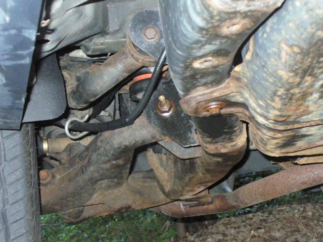

It's a 2006 with 118K miles that spent it's whole life in MA near the coast.

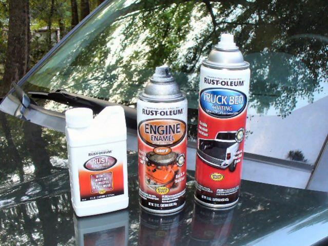

Step 1: I mixed up a gallon of Neutra Salt (or use Salt Away) and doused every bit of the under side with the solution before I did anything else. Let dry.
Step 2: Wire brush on a drill to remove as much as I could get to. Most weld lines had rust on the surface.
Step 3: repeat step 1 to neutralize what was now more exposed.
Step 4: Apply Rust Reformer in either liquid (brush on) or spray (for hard to get to places) It converts rust to a paintable surface and dries almost black.
You could stop right there and the underside would look good and most rust would be contained (or slowed down a whole lot)
Step 5: Spray flat black paint or truck bed liner. I didn't like the Undercoat products because they're pretty thick. The bed liner goes on like paint.
FWIW, I used the 2x8 wood slabs (that I use to change boat trailer tires) under the wheels. That extra 4.5" of height made it real easy to work.
