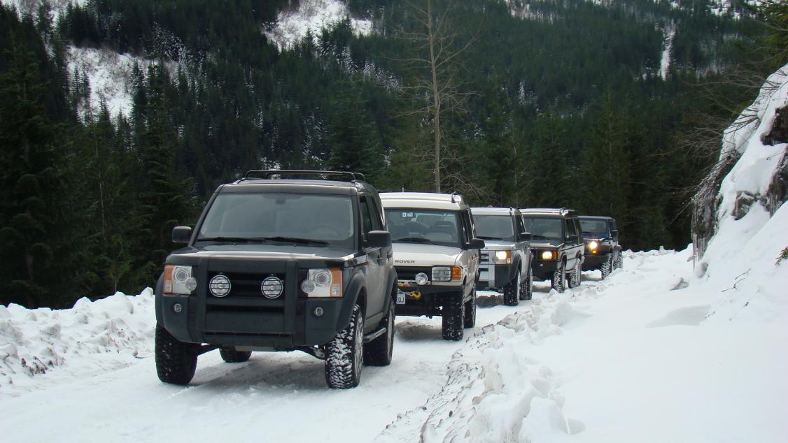

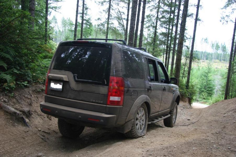

Dusty, you at least make some fair points and a somewhat consistent and cohesive argument. I will say this...we've been talking about stock-to-stock thus far. I think that if you saw my particular LR3 you would not mistake it for anything feminine. It would "lift its leg" and **** down the air intake of your D2.
Now that I've gotten that bravado out of the way, I think that solid axles are 2nd best. IFS sucks, I'm sure we can agree on that. Full Indi is not much better. Solid axles offer great articulation, durability and fewer moving parts (thus simpler)....but the EAS fully independent suspension is really the best. You get great articulation (see above, my suspension beats yours) AND...you get massive amounts of ground clearance since the diffs are tucked up inside the belly of the vehicle. I have about 13" of ground clearance, Dusty.
Now, I don't know how you are set up. You could have one of these Discos that are completely unrecognizeable. My LR3 is basically stock but with armor and tires. I sit on 32" MT/Rs. So even those Discos with the 2" EMU lifts and 32" BFGs pee down there leg when they see me coming.
If you have your fenders all cut up and 35" Super Swamper TSLs under your rig....great. But that's not a Disco, and I could do the same thing to the LR3 given enough money and the will to **** it up like that.
Pics show ample ground clearance (snow pic) and nice articulation for a non-solid axle rig.

ho, that is a good looking rig. I like it.

Love those sliders.

You're hardly articulating at all and your front tire isn't even touching the ground!!!
You have 32" MTRs and armor, so you are able to drive with more abandon than you would with your stock truck argument.
Im running a 4" lift with 33's, sway bar disconnects and stock gearing. Ill go against your LR3 any day of the week and twice on Sunday.

Yes my front tire is dangling over a large hole at the top of a steep hill; photo may not show it clearly. The articulation in the rear is what I mean; mostly to show that the EAS with the cross-link valving really does work as-advertised. Look how with one tire stuffed the other one gets forced down (clearly shown in the photo) like a solid axle would.
You have 33s on what? Your auto-sig says you have the lift and 33s on your LR3, so I'm not sure why you'd "go against me" with that; it wouldn't prove your argument for the D2. Also, for which vehicle do you have a swaybar disconnect? I hope you mean the D2 because disabling the swaybar on an LR3 does nothing to increase wheel travel.
I have no real "modifications" on my LR3 other than putting on real tires and adding better skid plates and RS Sliders. I use the IIDTool to get a few extra inches from the EAS; that's it. Since this capability is within the stock EAS capacity, I still consider my vehicle "stock" but could understand an argument to the contrary. I could agree to call it "Quasi-Stock" or something. There are no mechanical changes to the vehicle, that's my only contention.
