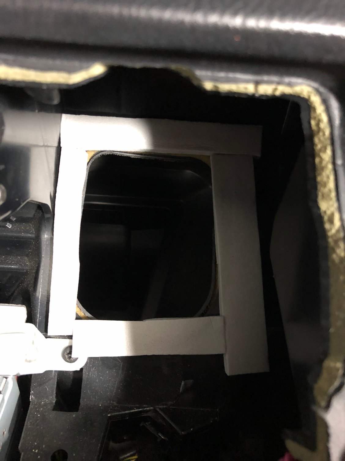

Nice trip! Gay brach can be a big trap in winter, the small ponds are totally hidden. You may have been overheating. While the coins are down low, the two ducts at top should have an additional seal added. I had issues with mine, but it would actually tell me on the display it needed to cool down. That is when I found those ducts leak bad as they interface to the outside fascia, the BIG piece you pull off the dash at center, the should. The factory foam had no indents to show it was being pressed onto. Some window seal foam fixed it, never an issue again.
