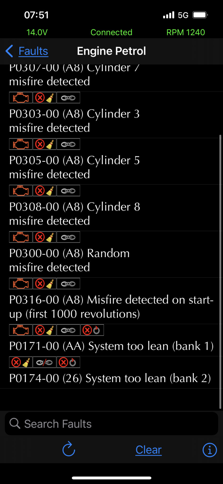

I'll be checking the EGR pipe today or tomorrow now that I'm off work. The codes have been gone for a while, however this morning came back with a vengeance!
Fired it up to run the kids to school and got 9 codes. All misfire then the lean codes. There was a slight rough idle which I noticed a few other times - never codes before.
Today's list of fun:
  • P0301-00 (A8) - Cyl 1 misfire detected
  • P0307-00 (A8) - Cyl 7 misfire detected
  • P0303-00 (A8) - Cyl 3 misfire detected
  • P0305-00 (A8) - Cyl 5 misfire detected
  • P0308-00 (A8) - Cyl 8 misfire detected
  • P0300-00 (A8) - Random misfire detected
  • P0316-00 (A8) - Misfire detected on start-up - first 1000 revolutions
  • P0171-00 (AA) System too lean - bank 1
  • P0174-00 (AA) System too lean - bank 1
I have a new LR EGR gasket and LR TB gasket ready to install. Not sure what else to do now.
A few weeks ago I ran a fuel trim vs. throttle position recording on the IID tool. I've attached that and the codes above for someone smarter than me to tell me what the heck I should look at now. Truck is currently enjoying the garage, awaiting a wrench.
Any and all help would be appreciated.
