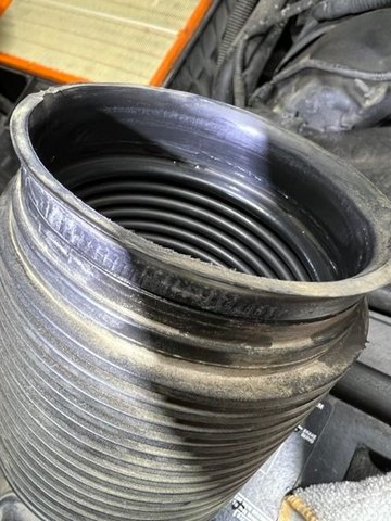

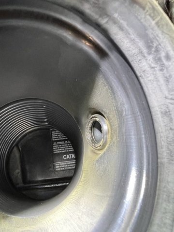

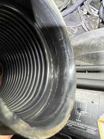

Old Feb 26, 2022 | 09:20 PM
droolyFace's Avatar
Joined: Mar 2020
Posts: 149
Likes: 34
From: Earth
Well I couldn't wait so I took it apart. Nothing looks cracked with maybe the exception of the inside of the boot that compresses onto the throttle body. There's a close up of the weirdness below.
I removed everything then cleaned it up for a better view. All the rubber gaskets look good and do not have cracking at all. The hose from the boot by the TB that goes to the back of the engine looks ok too. It's got some scratches on its top but nothing deep, it all looks superficial.
I also checked the o-rings for the oil filler cap and dip stick. Both looked brand new. I did find some small amount of crusty crud on the top of the ring of the filler cap. Cleaned the o-rings on both as well as the outside and insides of each hole. I was very carful not to let anything get inside and nothing did.
I'll go hunt down a smoke machine now to rule that out I guess.

Old Feb 26, 2022 | 09:27 PM
DakotaTravler's Avatar
Joined: Nov 2017
Posts: 5,106
Likes: 986
From: Green Bay, WI
The most common place for cracks is on the middle plenum, they often crack at either end. The smallest crack can be a big issue, think hole in straw when drinking. So if you did not notice any, then you are probably okay there.

Old Feb 26, 2022 | 09:31 PM
droolyFace's Avatar
Joined: Mar 2020
Posts: 149
Likes: 34
From: Earth
Didn't see any there, especially as what was shown in the link you posted.
I'll look again tomorrow with fresh eyes and smoke.
