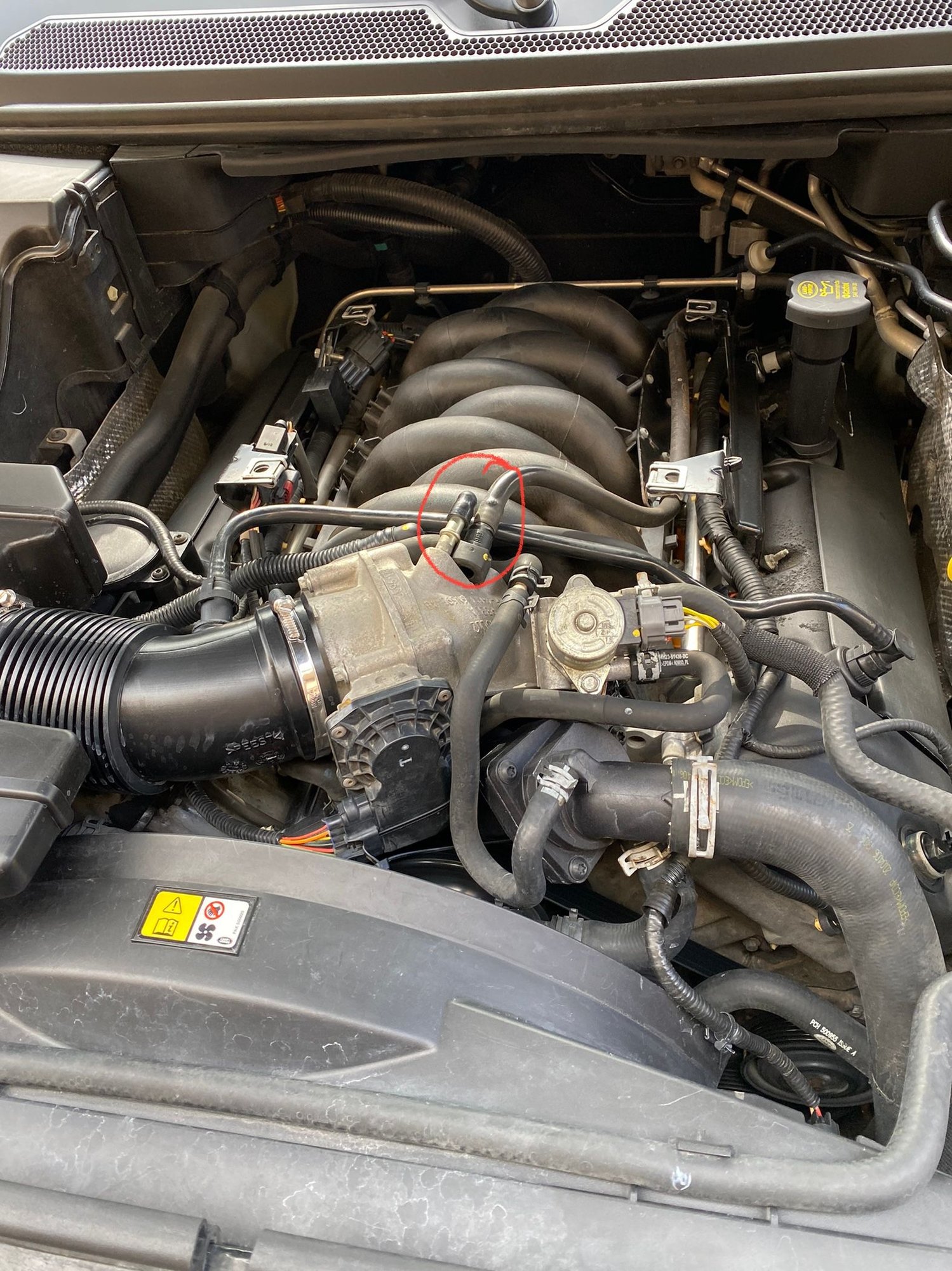

While not looking at the engine, I can’t visualize the evap tube you are referencing. Happen to have a picture handy?

Circled in red.
