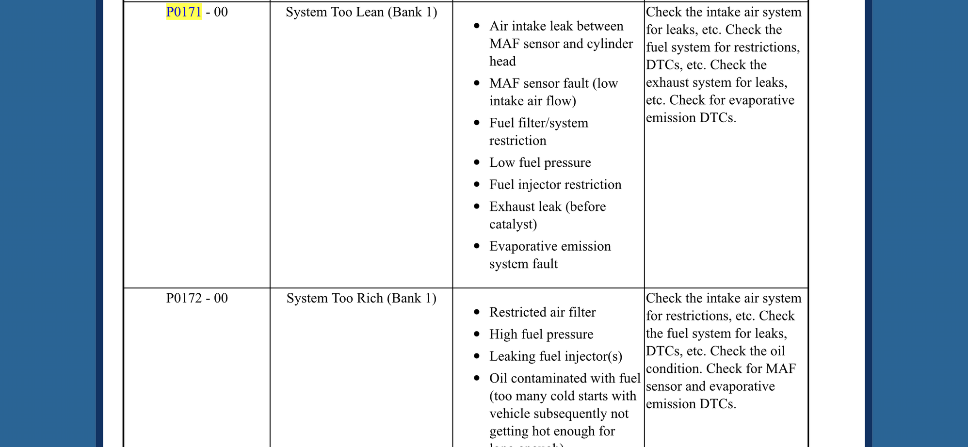

Here’s what the book says.
Yes, a clogged injector will cause a lean condition. The computer will respond by adding fuel (increasing fuel trim) on the lean bank.
Everything in the book to cause lean, except a clogged injector, would likely show up on multiple cylinders or both banks. You can eliminate MAF or air leaks in the intake ducting because they would impact banks 1 and 2 evenly. Low fuel pressure would also likely show up as multiple cylinder misfires, not just #1.
I can’t think of a reason why you’re running good between 1k and 2k RPM. A flashing check engine light means you’re misfiring excessively. Spark related misfires, plug or coil, would show up as rich (low fuel trim) because unburned fuel is reaching the O2 sensor.
If you swap injector #1 to a different cylinder and the misfire moves with it, you found your problem. If the misfire doesn’t move, then you’re digging deeper to things like a manifold gasket leak, low fuel pressure, etc., or worst case, checking compression.
