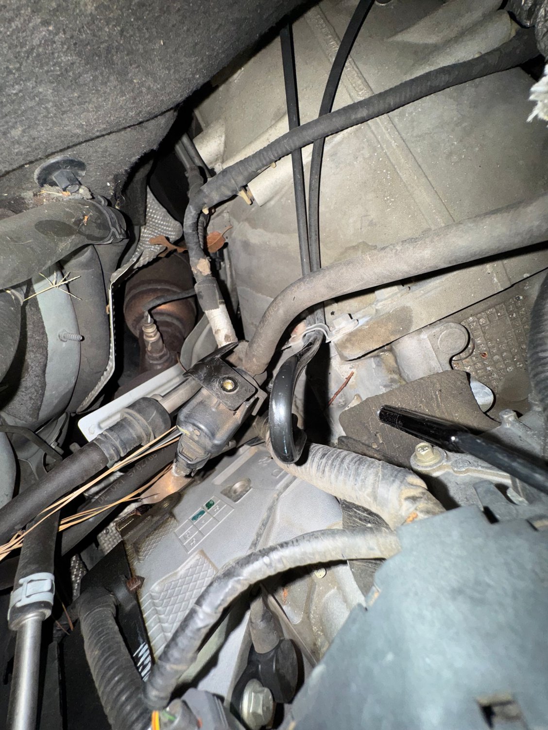

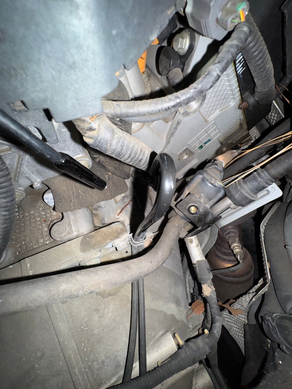

Well, mine was a 7mm which is weird. Anyway. I got the bolt off and took a couple of pictures back there. Now to figure out how to disconnect the power and then figure out where the other end of the hose is connected. Hopefully once I disconnect the power, I will be able to see it.

i was able to get it off. Having the correct replacement part helped tremendously because I could overlay it and vishalize how it’s connected. The power clip was easier to get off than I expected and besides the bolt, nothing had a risk of falling down.
