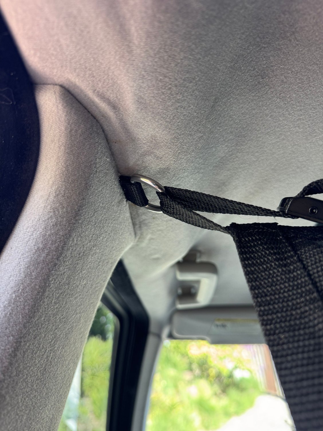

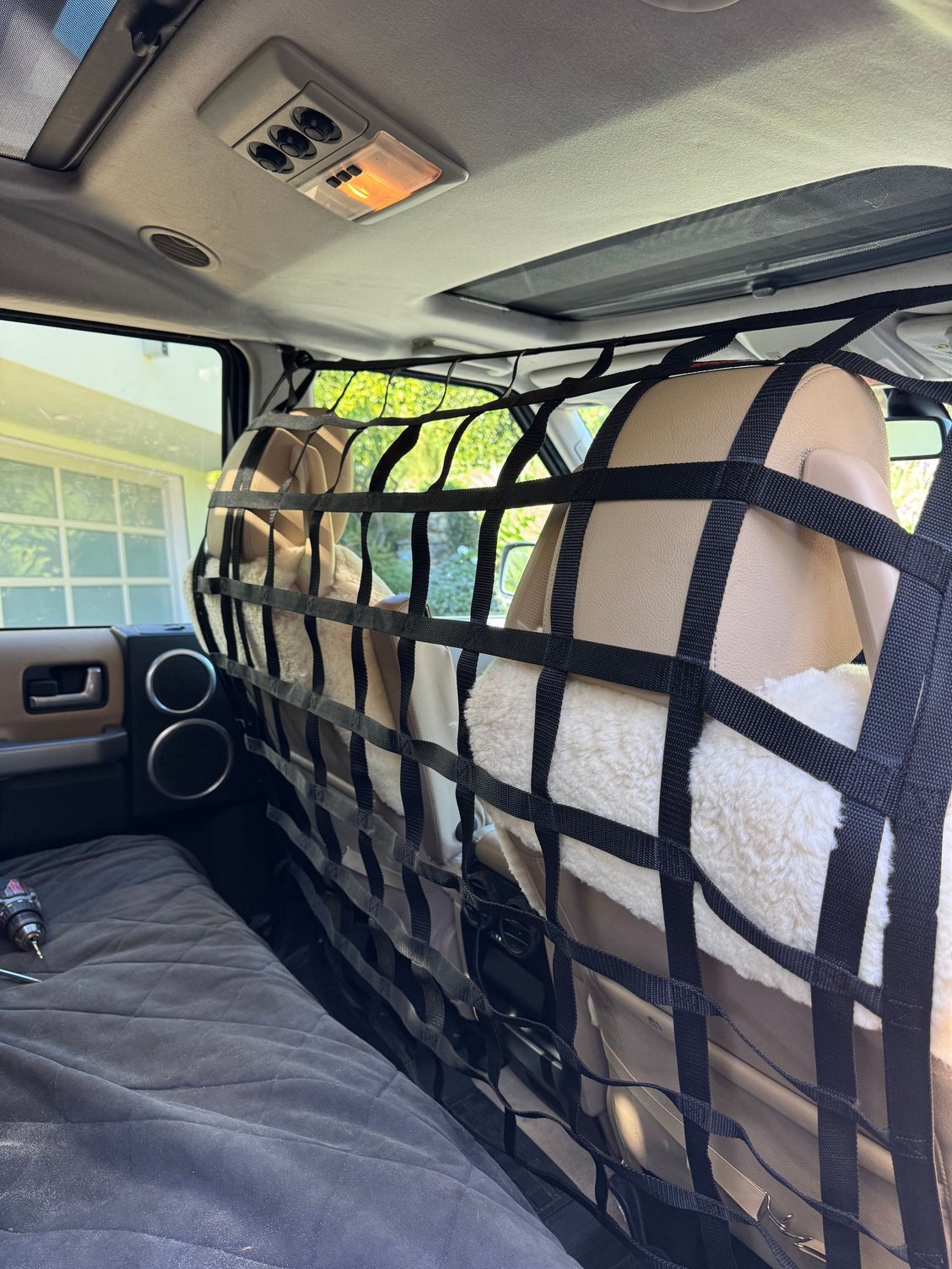

I was looking for a way to keep my dogs from jumping into the front and giving them a little more safety if god forbid we got in an accident. Eddie at Raingler sells cargo and area nets for various vehicles. I ended up with the Toyota Highlander net and I thought someone else might find useful info.

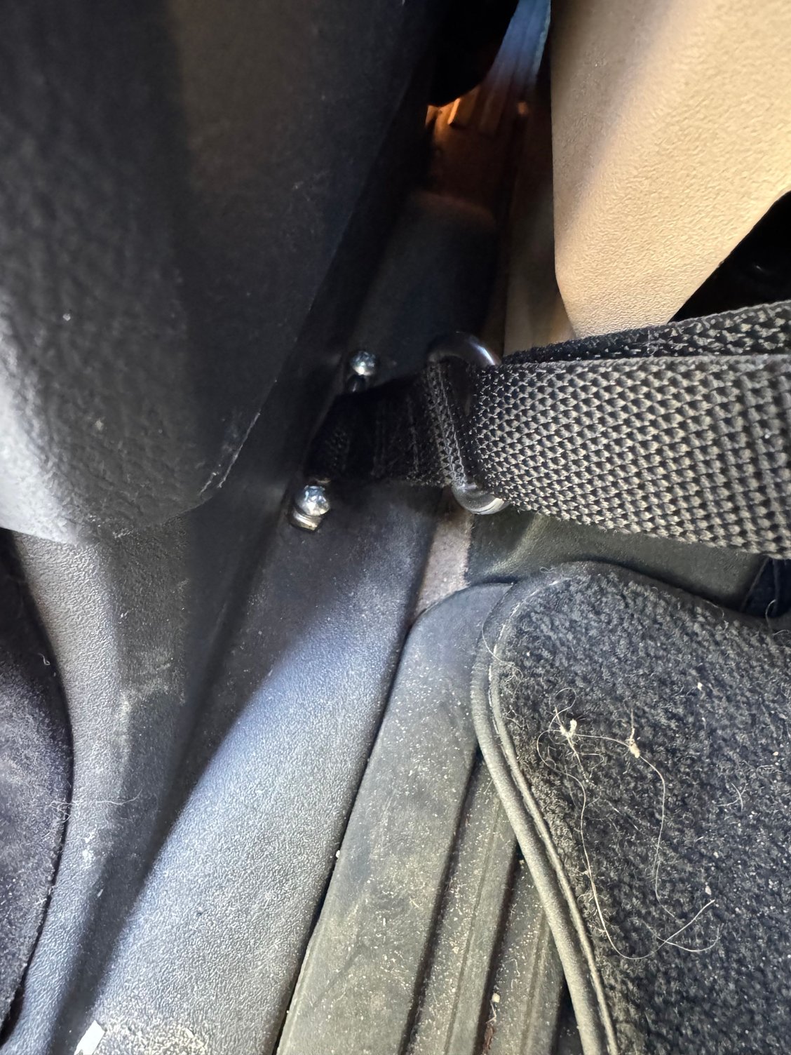

For the install, there is an 3/4” / 18mm hole at the top of the B pillar behind the trim. I used the triangular plate with the attachment ring Raingler provided with a Hillman 3/4” expansion nut to fix in with the ring strap upwards. I had to cut a slot in the trim area you can’t see to allow the trim to push up past the strap and a small notch in the area where it comes out from behind the trim. For the bottom, I used the screwed loop.

That looks good and easier than fitting a metal barrier.
