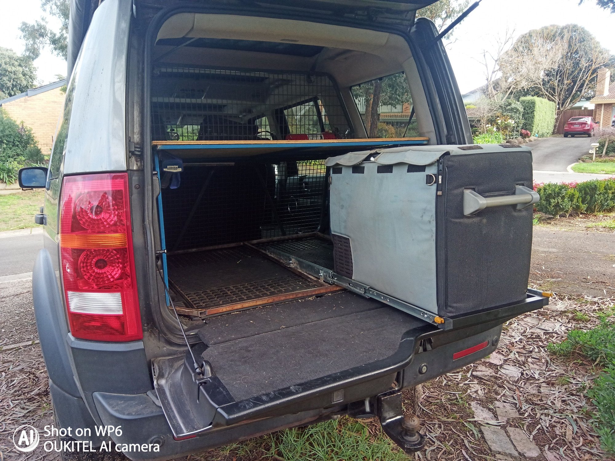

I did start this a while ago but wasn't sure how i wanted to execute it, originally was going to use 25x25mm aluminium tube with plastic connectors but it would use a lot space since you can only make square a rectangular shapes.
Decided steel was a better choice as i could make any shape i needed and use smaller tube, 13m of 13x13 x1.8mm found its way onto the roof rack and i made a start the next day.
I already had the plywood for the top so mocked up the height i would need to clear my fridge, taking into account that the Disco floor slopes to the rear with a drop of about 25mm front front to rear.
Also needed to tilt the fridge slide back so once fully extended it would clear the lower tailgate, i made up the base frame but soon realised that to get the rigidity i needed i would need more steel or even go up a size in tubing.
Luckily i kept an off cut from an old roof rack that a mate and i went halves in years ago which had just enough long pieces to remake the base frame, i then cut down the other frame to become the top frame.
Slide is one i made for my old D1 and i just based the rest around it,on the left i will make a lipped tray on slides with a large removable plywood box.
I will be using turn buckles onto the tie down points to secure it since the frame sits right over the bolts, i made it so it can be removed easily and is quite light.

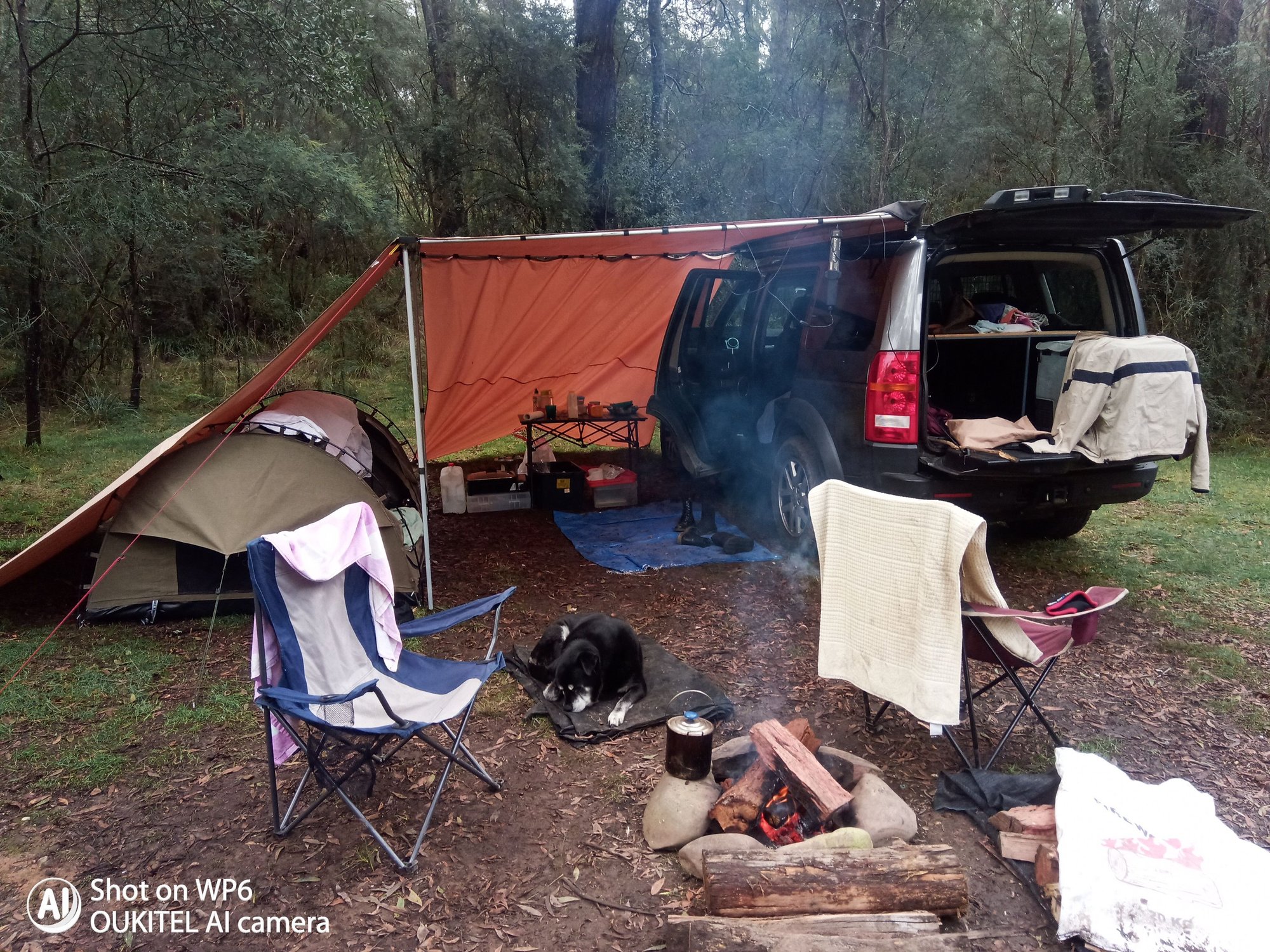

Tested out over a few days away for a mid winter camp.
