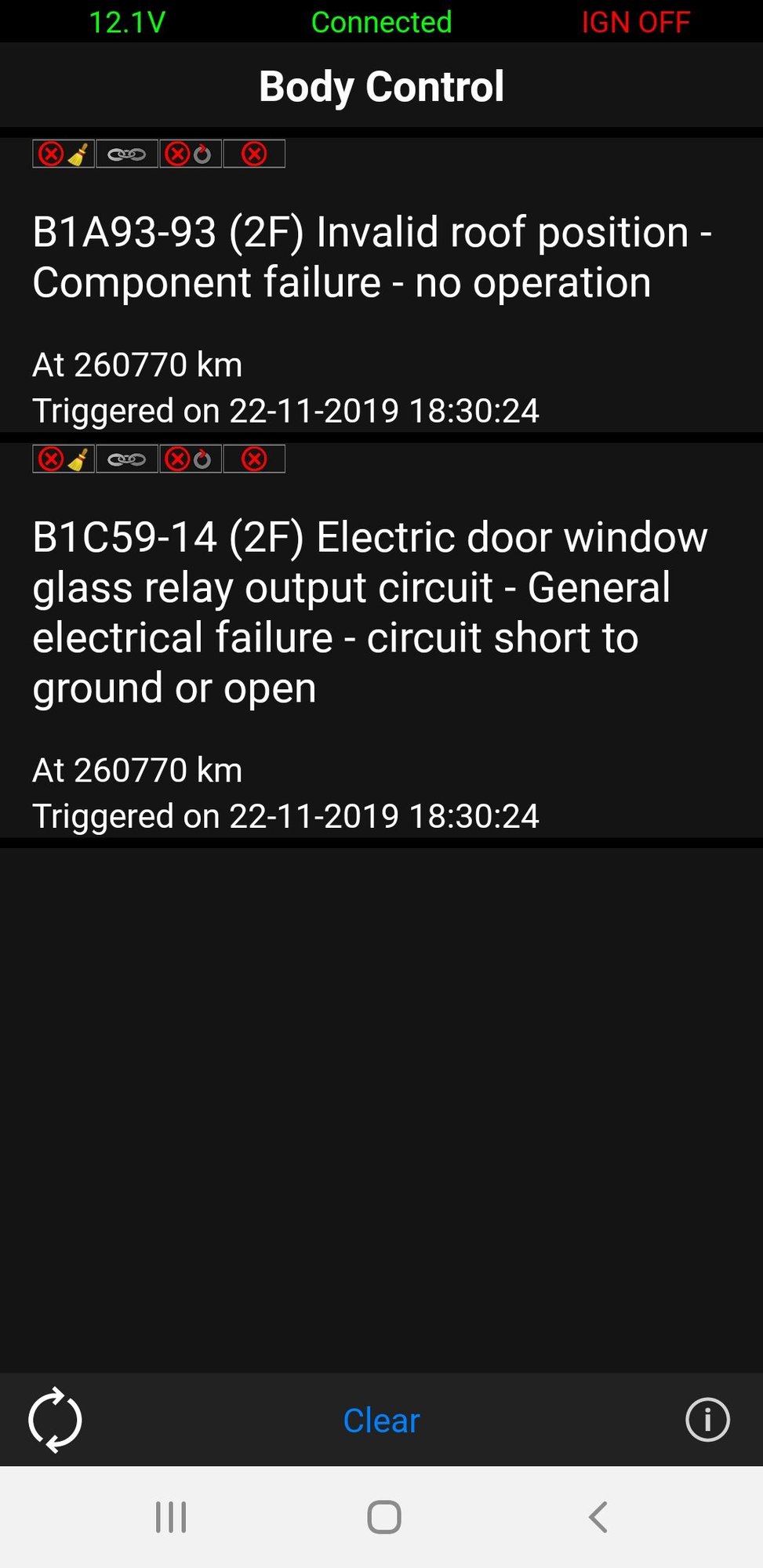

TMadlem84's Avatar
Joined: Nov 2019
Trying to revive a dead thread instead of creating a new one.
I have same issue - both rear windows dead.
I've replaced the master window switch with new unit
I've looked around wiring in right side footwell for obvious signs of corrosion but saw none.
I'm getting a ground/open fault from gap tool. But I have no idea where to go from here.
