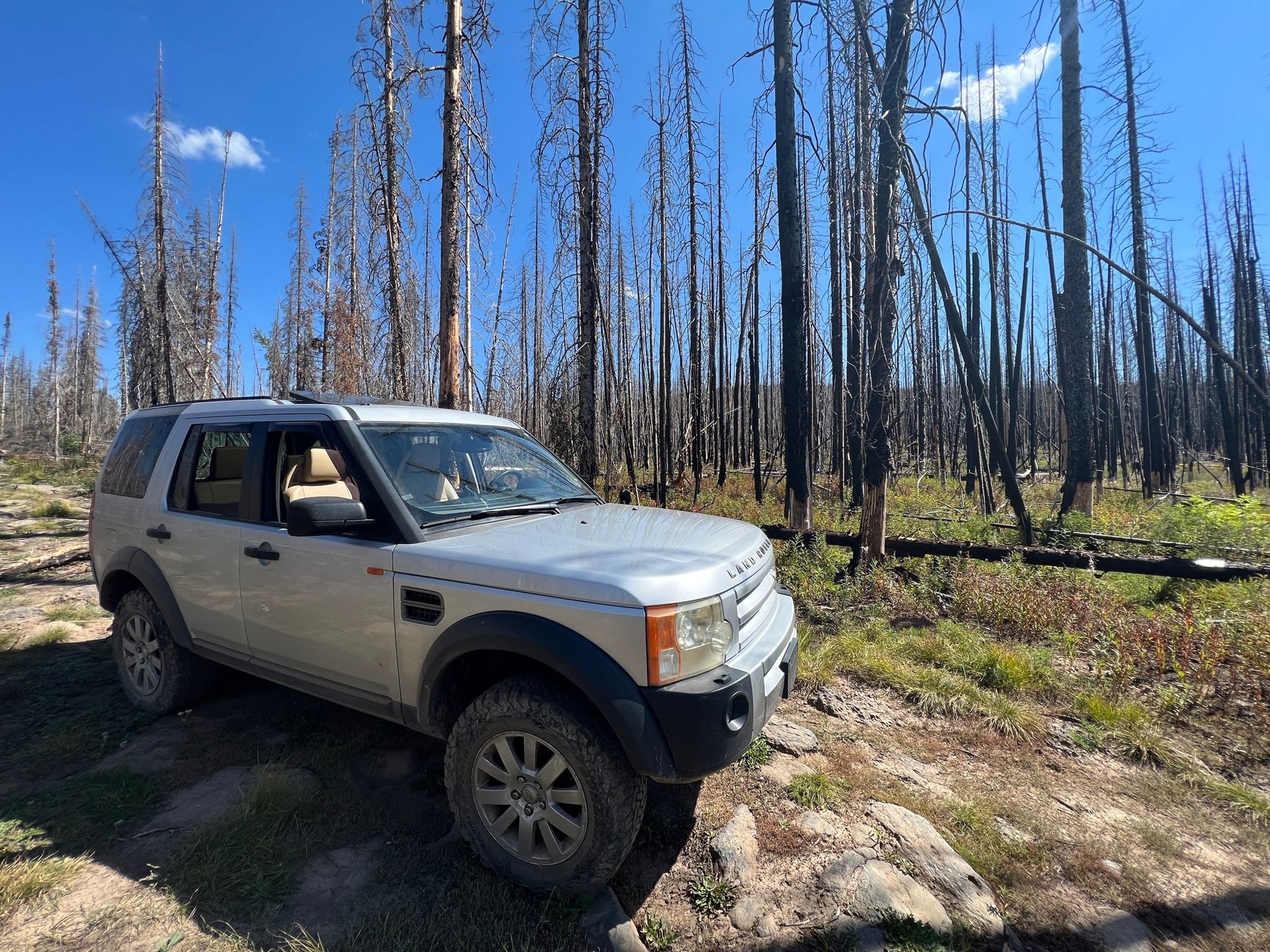

So, I ended up just going with 265/65 r18 BFG KO2s... They fit no problem, no rubbing whatsoever... If I ever decide I need more clearance, I'll go with the spacers, but, for now, this seems to be working very well!
