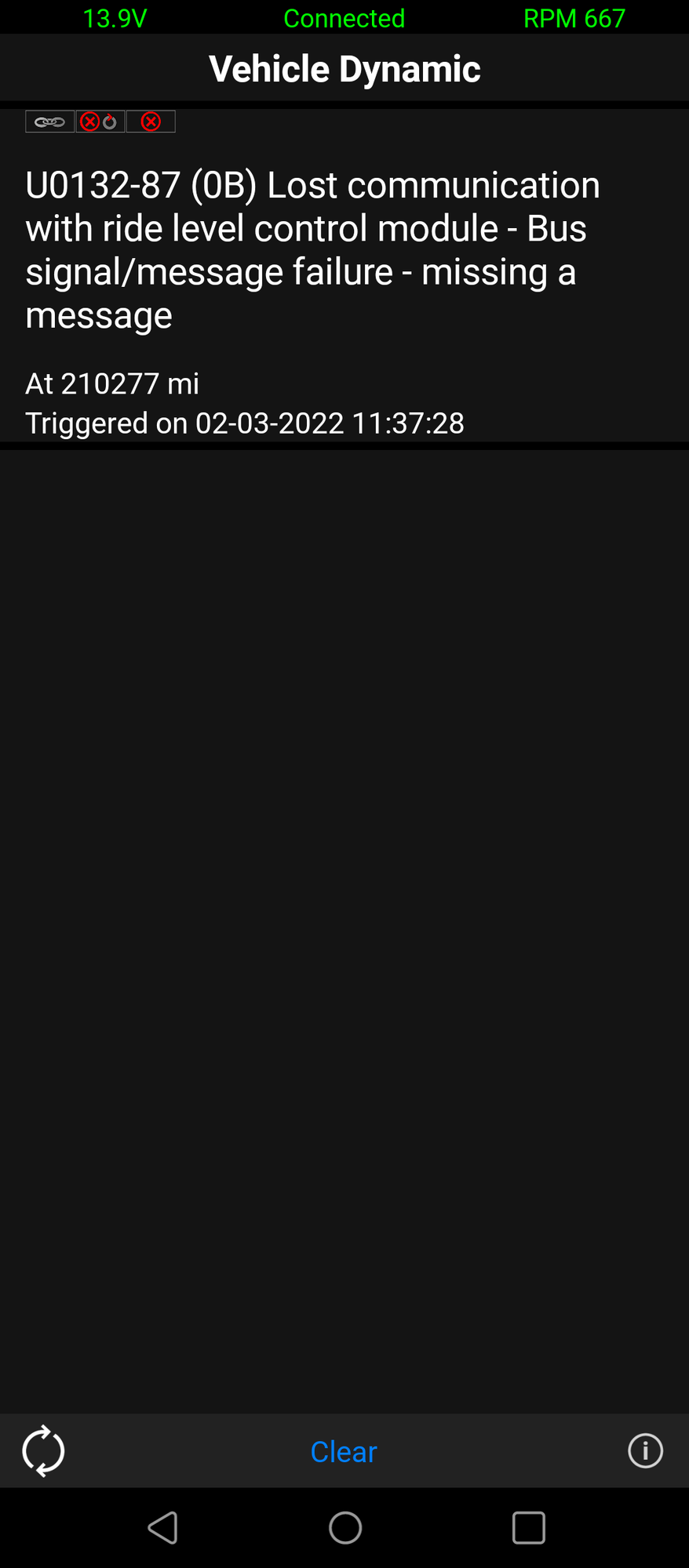

Tried pulling live values to see the pump but faults faster then I can pull it up

Now got random fault. Old dryer ran full cycle to 258 and dumpped galley to 26 after blow off. Fault happened mid cycle but no fault on dash.. Sitting at standard height now with tank full. Fingers crossed no faults when I test drive

Quick follow up, 10 mile test drive zero faults. Everything seems to be working. Will update if faults re appear. Thanks for everyones help. Cheers fellas 🤘

You can disregard the code for now unless its persistent.

50mile test run. Zero faults. Sucks buying a brand new amk and have it not work. But was able to swap stuff o er from old amk to make it work.

Yeah, lost com faults are what I call ghost faults. Kinda behind the scenes stuff that all too often are not real faults. Was the new one a genuine AMK?

well, I would say knock off since it came new shipped for $178... Came with bracket and new relays that didnt fit either. Motor runs great. Everything else was plug in play. Swapped dryer from my old amk and after a few faults has ran without any problems so far. So basically, the knockoff amk had a **** dryer straight out of the box.
