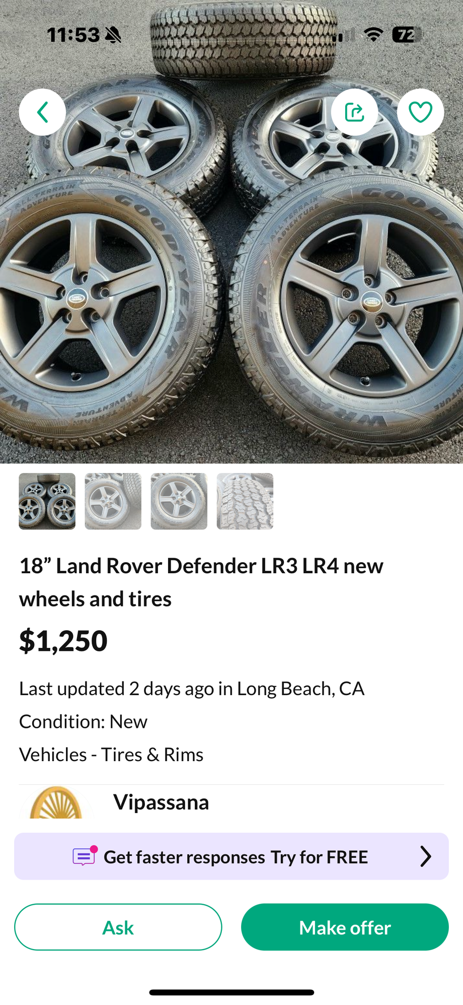

The new defenders came with 18” alloys and steelies. Guys around here are selling sets of 5 with the wrangler AT tires, almost new for $1250.
