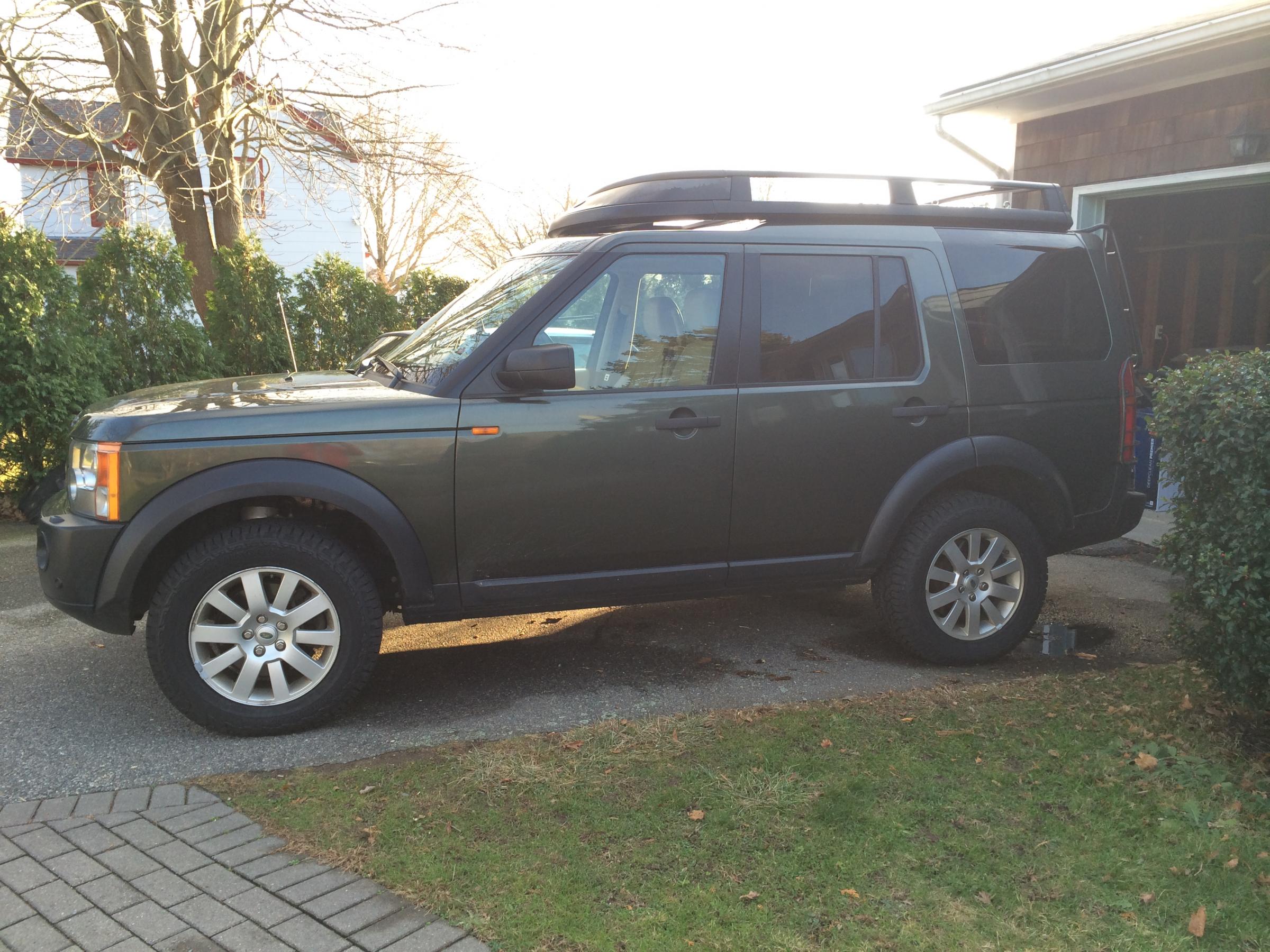

Hey Boneless here's how my truck looks with the rods. I haven't had a chance to take a pic of my rods side by side yet, had to change out 4 belts in the wife's volvo 240. Many rusted bolts, 4 hours long and tons of swearing.
Your truck should look like its in offroad height with the rods. Take a look at the pics of mine.

Your back looks right but your front looks wonky.
