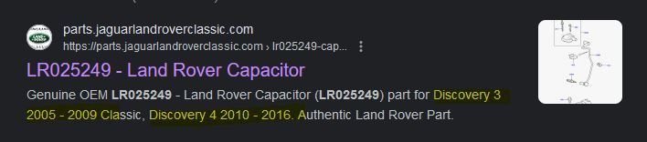

I was looking for LR004160 as well and found that LR025249 might work... when searching I came across this: https://www.ribblevalley4x4.com/allm..._LR025249.html that had LR025249 as a related part. Looking up LR025249 shows it's for the LR4 and LR3.
I haven't bought it yet as I may do the junkyard option first.
That is very interesting and might consider getting that part if I find that capacitor is issue after jumping the wires first. The connector seems to be the same as well as the wire pins look to be in the same location. Thanks for the info!
