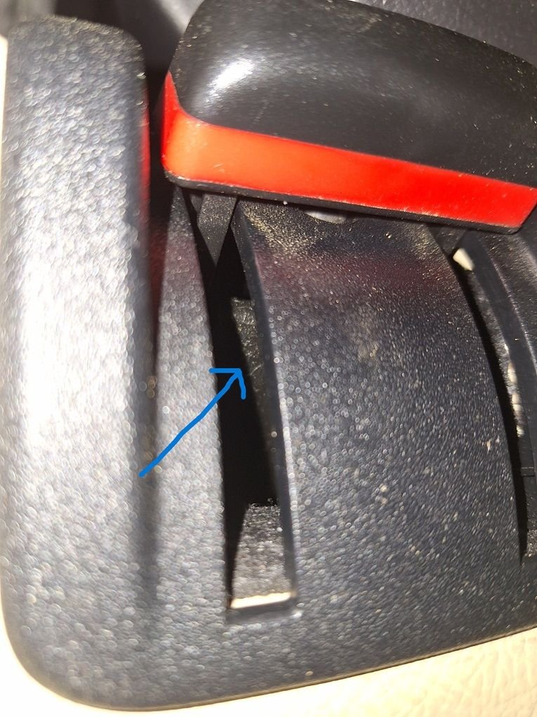

While my rattle may not have been your rattle I did have second row one that took me a long time to track down. It had to do with the pull handle that is used to lower the seats. The handle itself will pull straight out. What I found is down inside where it goes there is a little piece of material/plastic that is suppose to clip into the handle mechanism. Mine had come unclipped so rattled around inside there. With the handle pulled out I was able to maneuver a couple fine tools down the slats and clip it back in place. May be worth a look. If your rattle is only on one side, shine a light down the other to compare.
