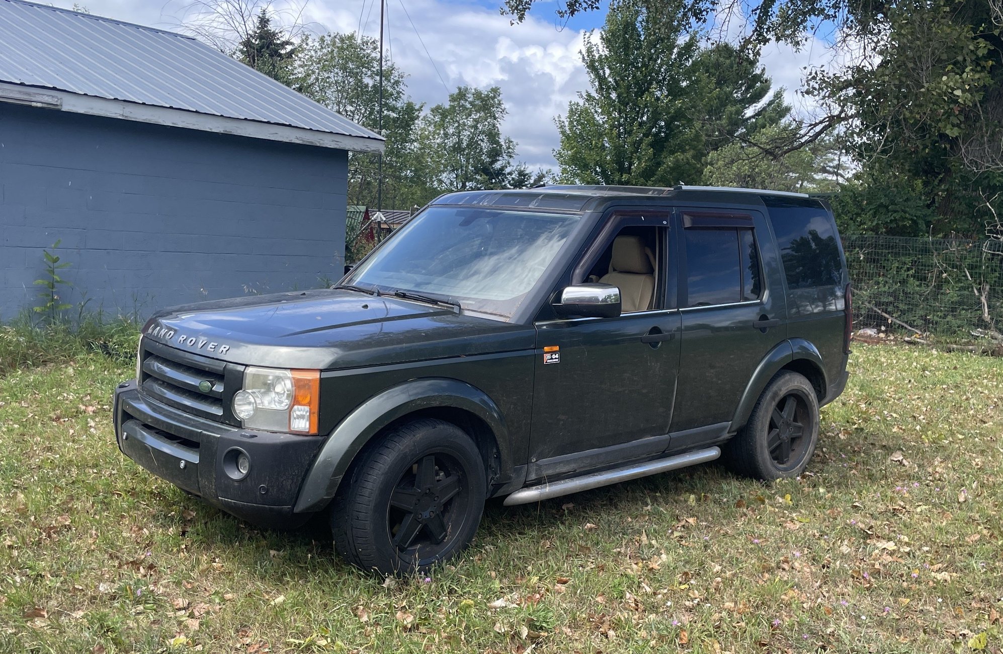

Originally Posted by Gnomadf
So to answer my own question-Nope, can't get there from the top. Some PB Blaster and a bit of light precussive adjustment and I drove my $500 LR3 home.
Pics or it didnt happen
Old Aug 13, 2024 | 03:47 PM
Gnomadf's Avatar
Joined: Jul 2018
Posts: 363
Likes: 90
From: Tip of the Mitt
Here it is in all of it's grubby glory.
As found in the trees, lots of needles in the vent by the windshield. But anything you can drive home for 5 benjies smells like victory to me. And smells a bit like weed.

DakotaTravler's Avatar
Joined: Nov 2017
Posts: 4,988
Likes: 962
From: Green Bay, WI
Not a bad looking rig!
