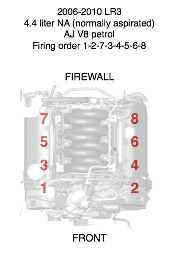

Yeah, I found that moving the coil packs on misfiring cylinders is an important
troubleshooting step if you get multiple misfires all at once. It's also free and pretty easy.
I posted this Reduced engine performance message a while back hoping to help others. If I knew then what I know now I would have put "multiple misfires" in the title and not just in the body.
Also, I made a diagram based on the LR3 information from this Firing Order And Cylinder Numbers for Land Rover Engines video and some other resources I found online. It can be handy for those of us who aren't intimately familiar with the cylinder numbering scheme used.
