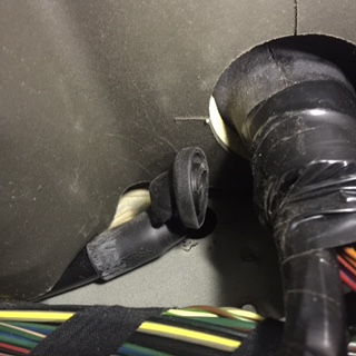

I finally had time to look into why my driver side floor was wet whenever there was a nice rain or snow melting. When I grab the elbow, it was torn in a couple of places. How are people fixing this? Is there a hose on the other side of the elbow that fell off? My first thought was to order a new elbow from the dealer but after sleeping on it, I think I am going to remove the elbow and slid another piece of hose on it and stick it threw the hole where the elbow was. Unless someone has a better idea.
The elbow should be intact, no tearing. It can be fragile although mine was in good shape. I thought the same thing when I pulled mine, going "where's the rest of this tube?". Nope, it ends right there in that weird vaguely sarlacc-looking closure that I promptly snipped off. Good on you for adding the extra tubing, it might keep any water from coming back in.
