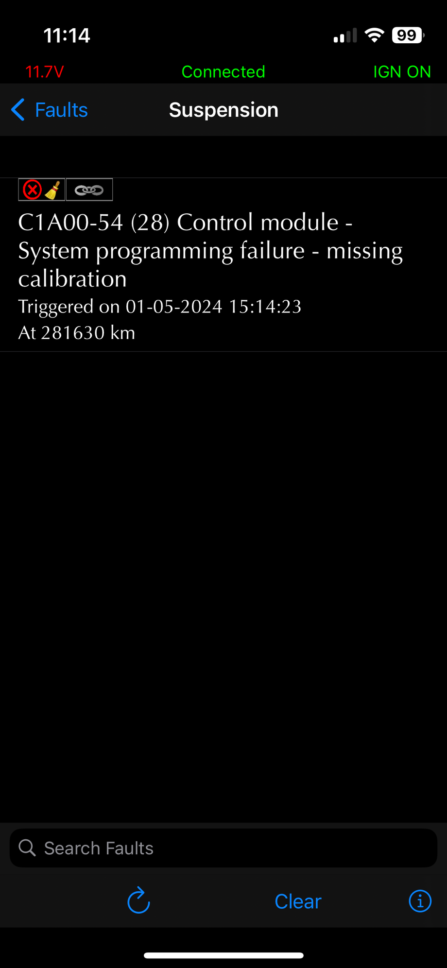

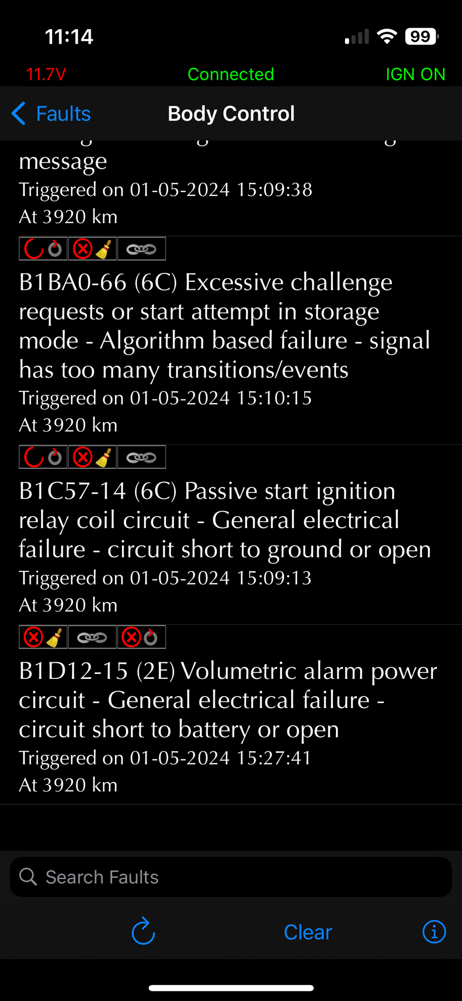

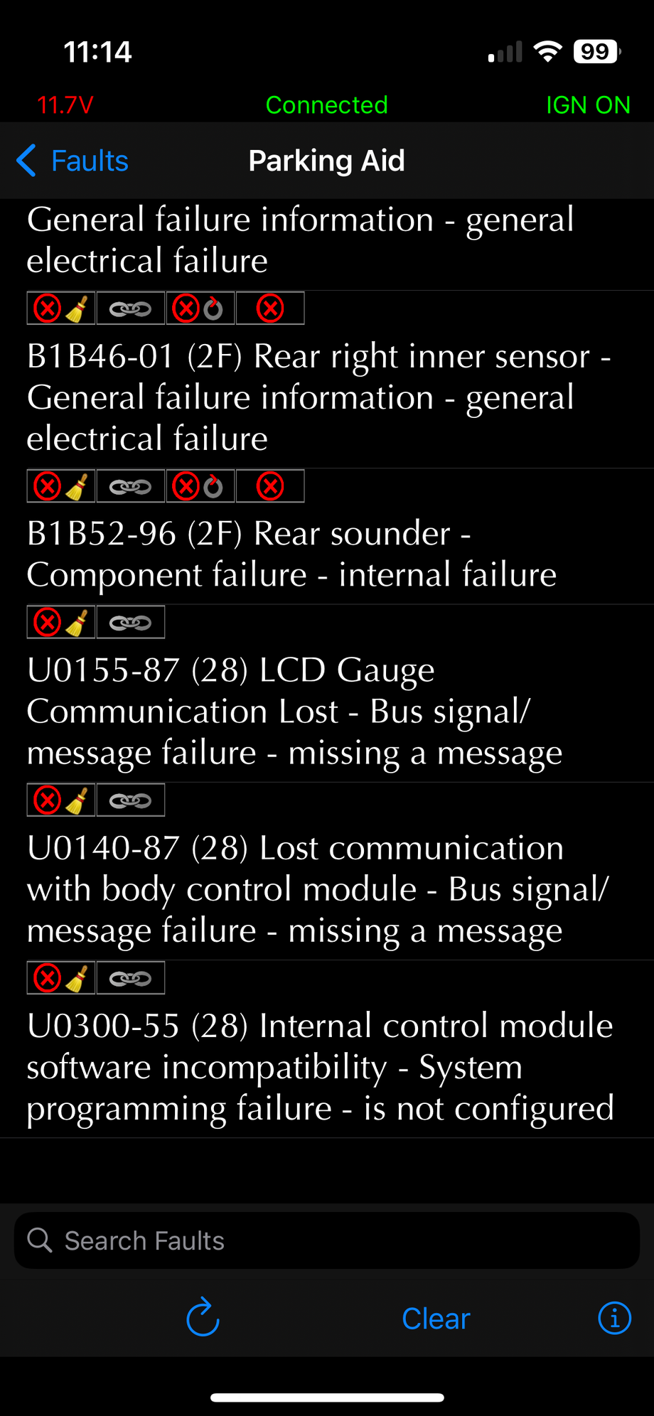

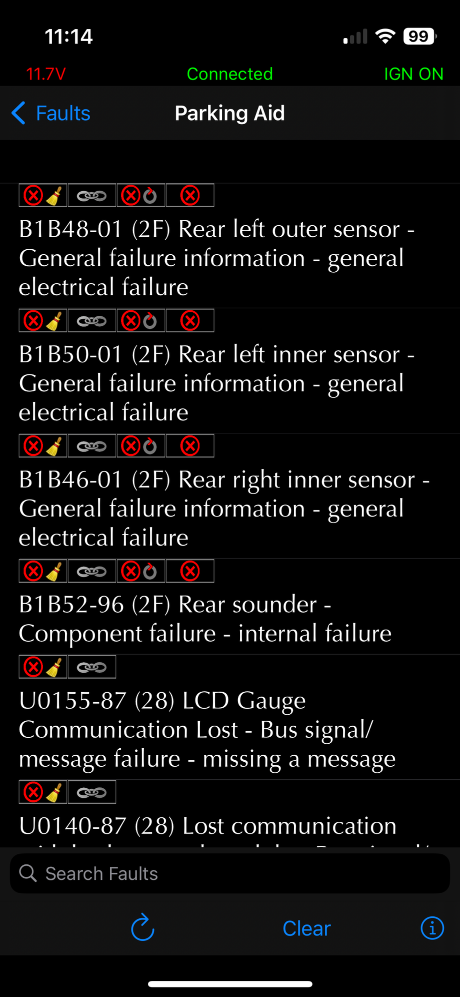

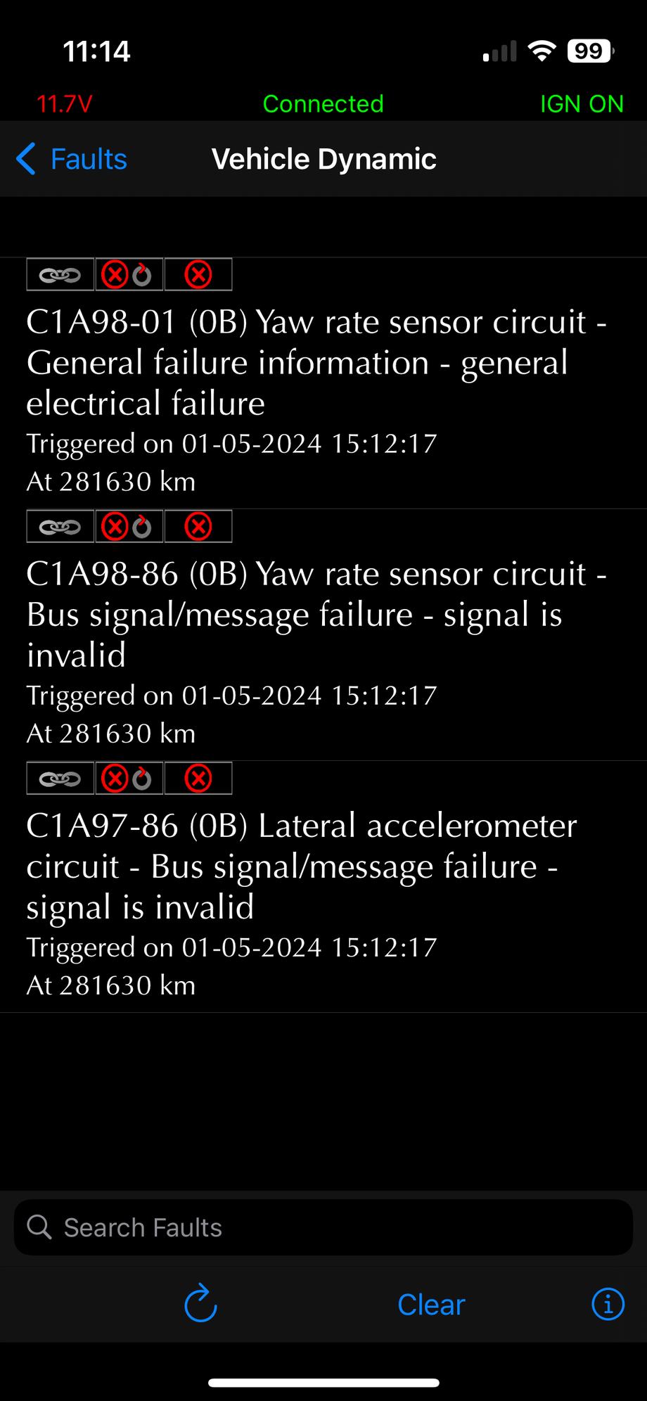

Thanks for responding, I removed the CJB main fuse, relay junction box behind the glove box - and also checked and replaced any fuses under the hood as well as checking all connections for corrosion. Dash message coming up was HDC system fault, special functions, disabled, or not available. Codes showing currently after clearing and re-checking are:

You said you cleared the messages but the ones with dates are from January. Have you cleared them recently? [edit: just noticed on my Gap that it uses European format, DD/MM/YY, so that's May 1 not Jan 5] Also get a decent battery in there or recharge the one you have.

The mileage on the codes are out of wack, some say 281k and others 3920 ?
