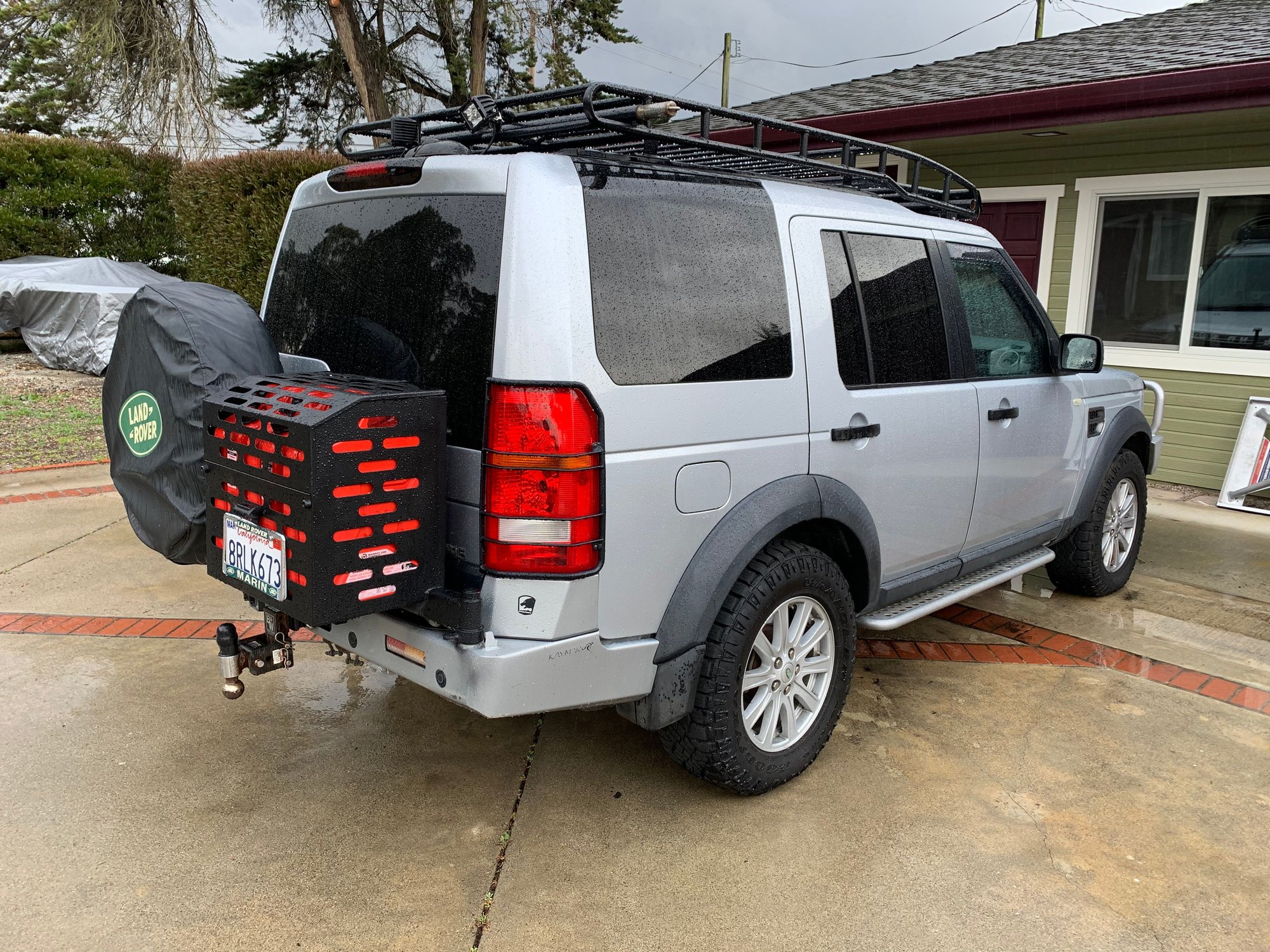

I haven’t posted here in a while, I bought this basket case/salvage title LR3 last year and wasn’t sure if I was going to keep it. I have put a lot of work into it and put it up for sale and haven’t got much response. I drive it here and there but not much. So fast forward, I have bean leading Motorcycle tours this summer in Alaska and have really enjoyed it and I’m going to do it again next summer. I want to drive my LR3 up next year, do some camping along the way. After I do a tour fly my wife up do some touring/camping and then the two of drive home to California. I need to get it ready for the trip and I have ten months to do it.
So I’m looking for some advice of what I should be doing to make sure I have a stress free trip. I don’t mind putting more money into the rig if mean I won’t have problems. Here is a list that have done and what I plan on doing.

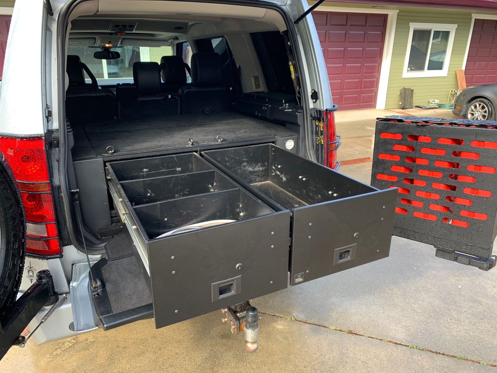

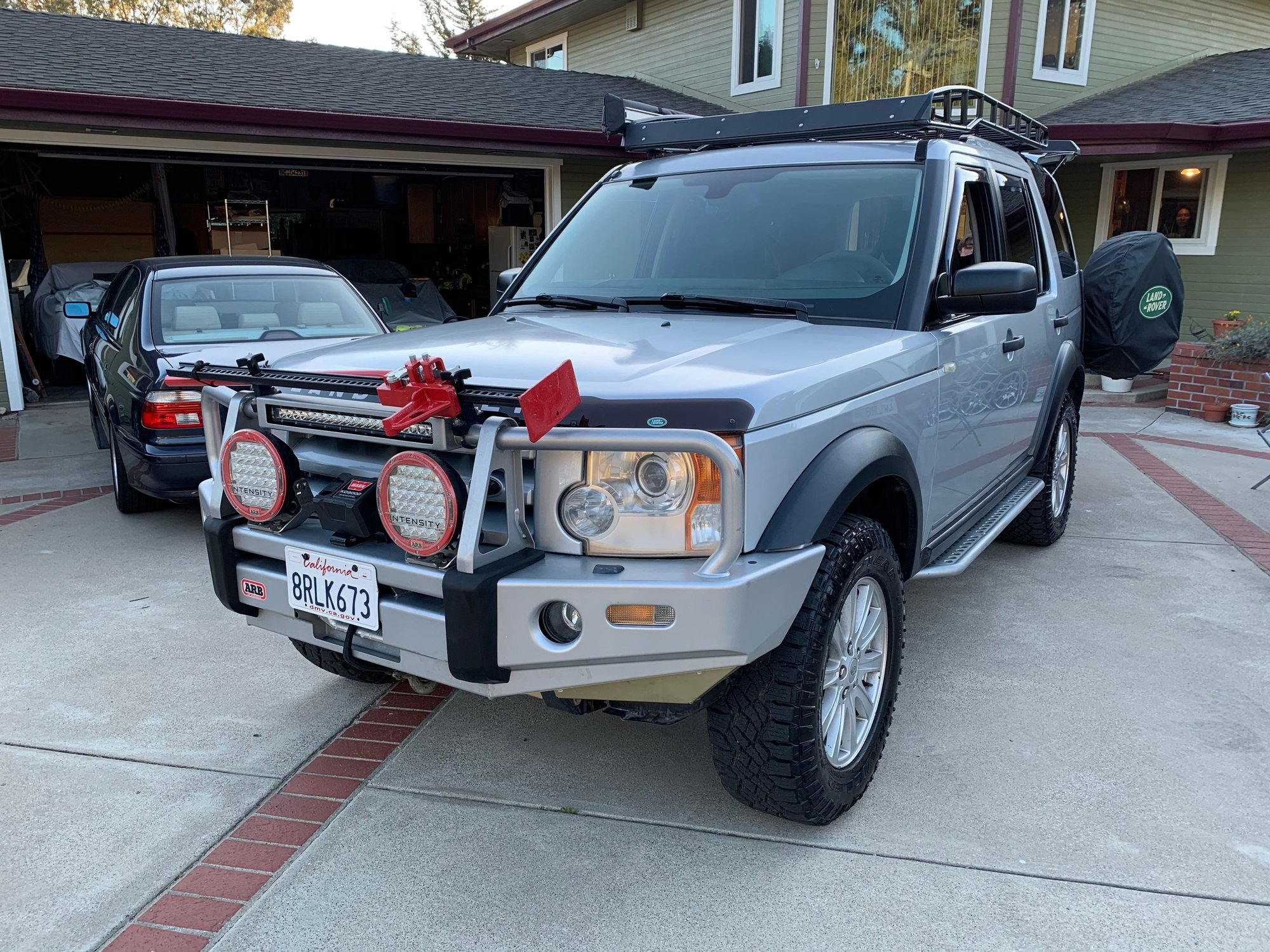

here is the equipment it already has
ARB bumper with a Warren winch
dual battery set up
2000 watt inverter
Pull out drawers
roof rack
ARB lights
johnson rod 2” lift
