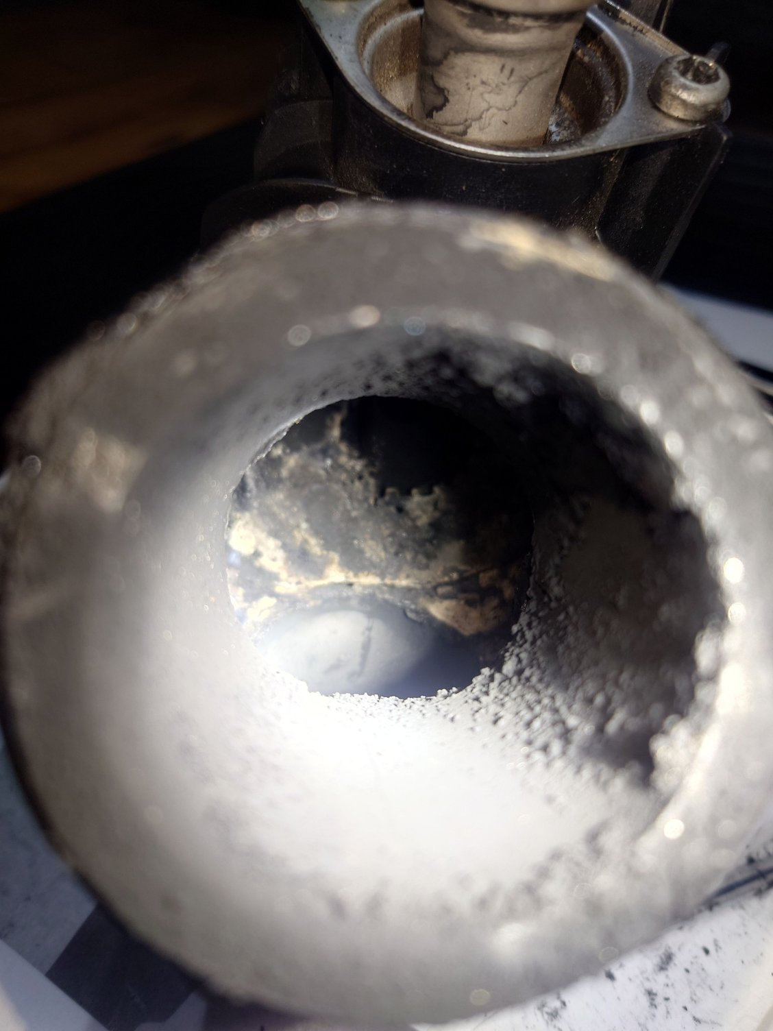

My LR3 2.7 TDV6 throttle body failed on me this weekend. The side of the "plastic" composite housing has melted, from inside to out (from what I can tell). Aside from the usual coating of carbon build up from the exhaust recirculation, there is a bunch of hard brown "stuff" on the inside on the same wall where the bubbling out happened.
I have included two images, one of the outside of the throttle body showing the bubbling out, and the other the brown stuff.

- has anyone seen brown stuff like this before?
- do you agree the damage is from inside out?
- if it is from inside to out, what could possibly heat to melting temp of housing meant to take 100+ C degrees? and how can I avoid in the future?

Brown
Brown "stuff" on the same wall as the bubbled plastic

First off i don't know country you are in, update your location, but there were no diesel variants sold in North America so you would be better off in a UK/AU forum or the facebook group.
Lucky for you there are 1 or 2 with TDV6 engines here including me, i would say you have had an EGR valve failure which has caused hot exhaust gas to flood the intake and melting the throttle body.
Once you fit the new EGR valve i would blank them so it doesn't happen again, this could have been prevented if you investigated it when you first got the DTC for the EGR.

I think I found what happened!
I pulled the coolant cross over pipe off and there was no coolant! Even though the tank is at level. Seems there has been an air pocket or drop in coolant level I hadn't noticed.
My thinking is that the coolant level has dropped in the EGR cooler to the point where the recirculating exhaust wasn't being cooled. Hence extra hot gas into the throttle body and melting it.
Taught me a lesson! I need to be much more careful with coolant levels.
Thanks for all your help! Your advice pointed me in the right direction.
