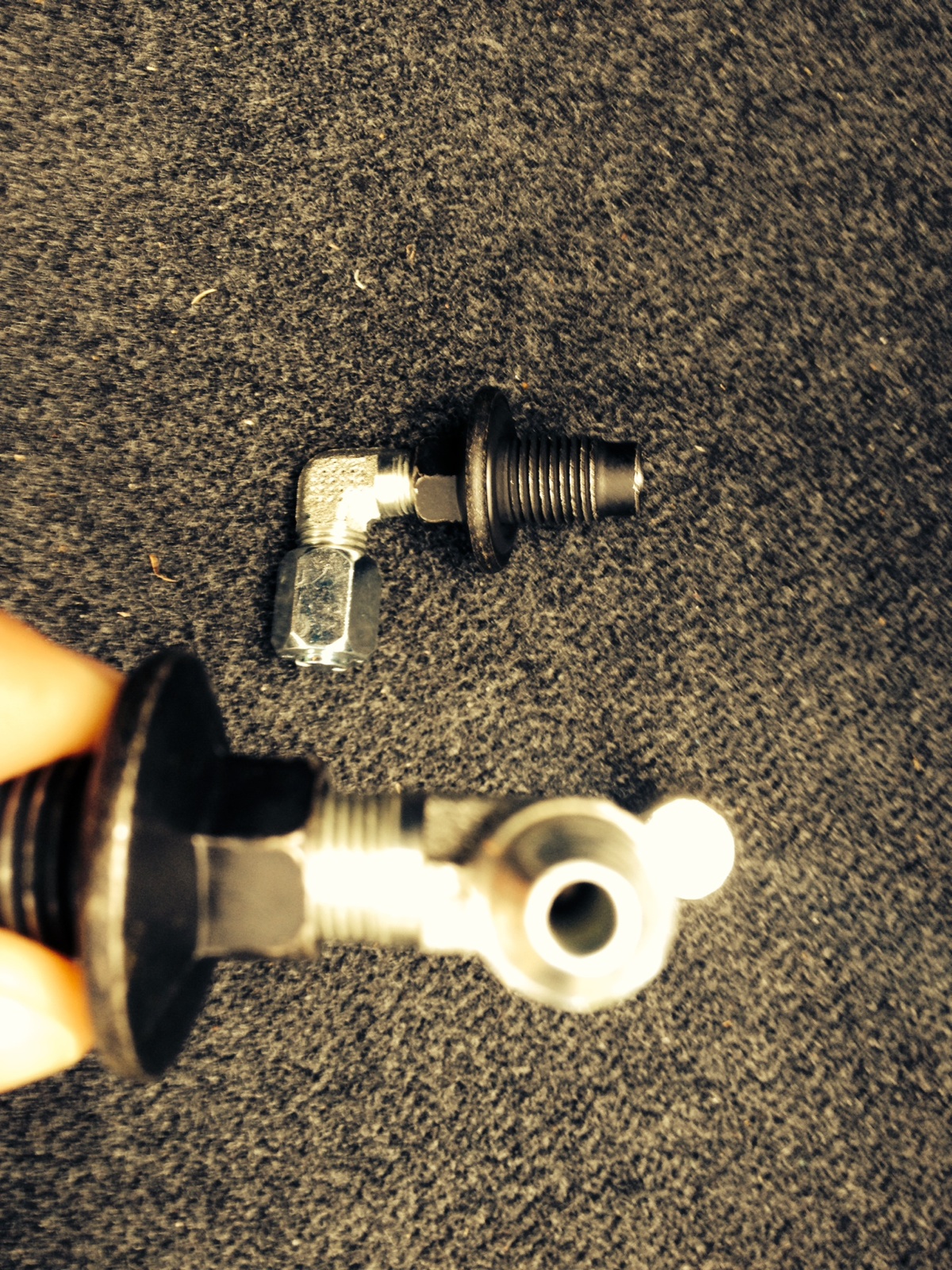

Not to hi-jack but how did you re-engineer it?
@abran yes that's exactly what they described. Is that a time-consuming operation? Expensive?
@ArmyRover I had an OEM drain plug tapped and then fit stainless steel fittings to it, thus relocating the drain hole. The plug was then JB Welded into the pan. It's never coming out again. the SS fittings include an elbow and a cap. Remove the cap, oil comes out. Simple....the one important thing is the 90 turn. That way torque applied in removing the cap doesn't also put a torque on the drain plug.
I have a photo somewhere...I'll try to post it.
Found it!
Found it!

You might actually be brilliant
Now with that I just need to find a alternate way to pull my oil filter and I no longer have to remove my skid plate. Oh and I can quit living in fear of a junk drain plug....

@ArmyRover, I was really sweating the oil pan when I thought I'd have to replace it. The cost is astronomical. I was lamenting it to a co-worker and he was like "you don't have to do that" and started talking about marine solutions he'd seen and such...and then I remembered that I'm an Engineer!
I went to work sourcing parts and finding a local machine shop to do the tapping. I made two of them for about $25. The machine shop wouldn't even take my money; I dropped a 6-pack of a good craft beer and it was all good.
I've had the oil changed since then. It works....a little slower but I don't care. Works best to change it HOT so that the oil will be less viscous and flow better through the smaller hole.
I went to work sourcing parts and finding a local machine shop to do the tapping. I made two of them for about $25. The machine shop wouldn't even take my money; I dropped a 6-pack of a good craft beer and it was all good. I've had the oil changed since then. It works....a little slower but I don't care. Works best to change it HOT so that the oil will be less viscous and flow better through the smaller hole.
