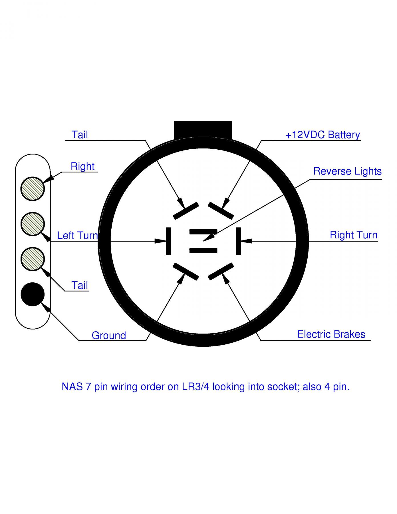

Connecting to the starter motor, while difficult is guaranteed to work.
I noted the comment re trickle charing thru the round trailer socket at the rear. It should work but will take time. One of the terminals should show as having voltage on it - not much but some. If so, you might try running power back thru that terminal. The terminal shown on the diagram marked as 12VDC Battery may show some voltage.
All you are trying to do it get the voltage back to where the door locks will work and hopefully if you can get the hitch to backfeed, that none of the fuses blow that protect the circuit. If one does, it is just a nusiance but what I am saying is do not try to run much thru the socket - just get the doors open.
Let us know how it all worked out.
