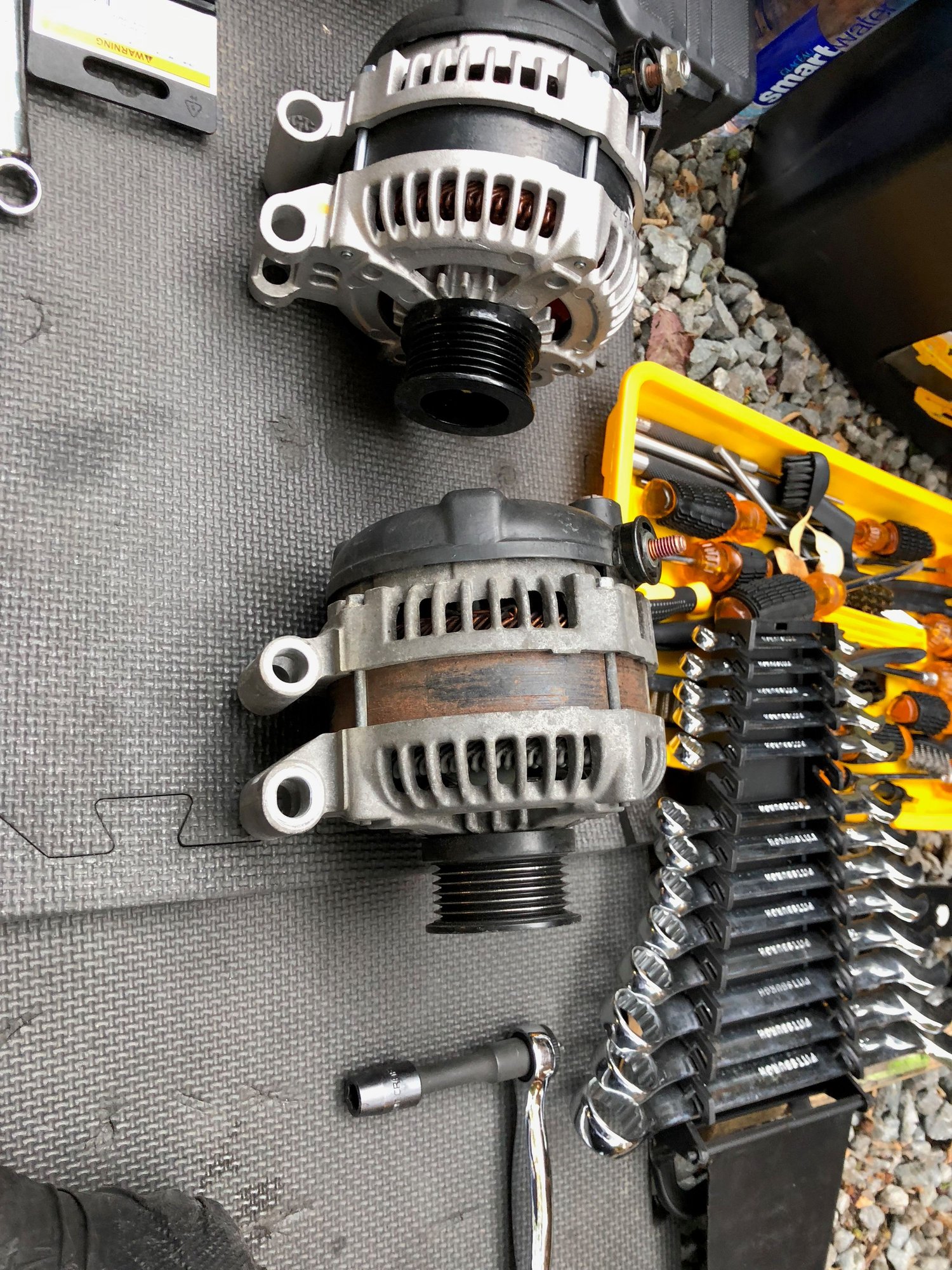

From: San Francisco
Replaced the alternator today and lets hope that solves this. This saga has been going on far too long.
Installation was a pain in the ***. You need to raise the suspension, remove the access panel in the passenger footwell, take off the belt, remove 3 bolts then fiddle with the cables. Embarrassingly enough I missed the 3rd bolt on the alternator and removed one from the engine block instead. I reached above the alternator and found a bolt and assumed that was it. I was wondering why they would have 2 13mm bolts and 1 10mm.
Installing the cables was the worst part. You need to plug the connector back in before you bolt on the alternator. Almost dropped the alternator on my face a few times.
