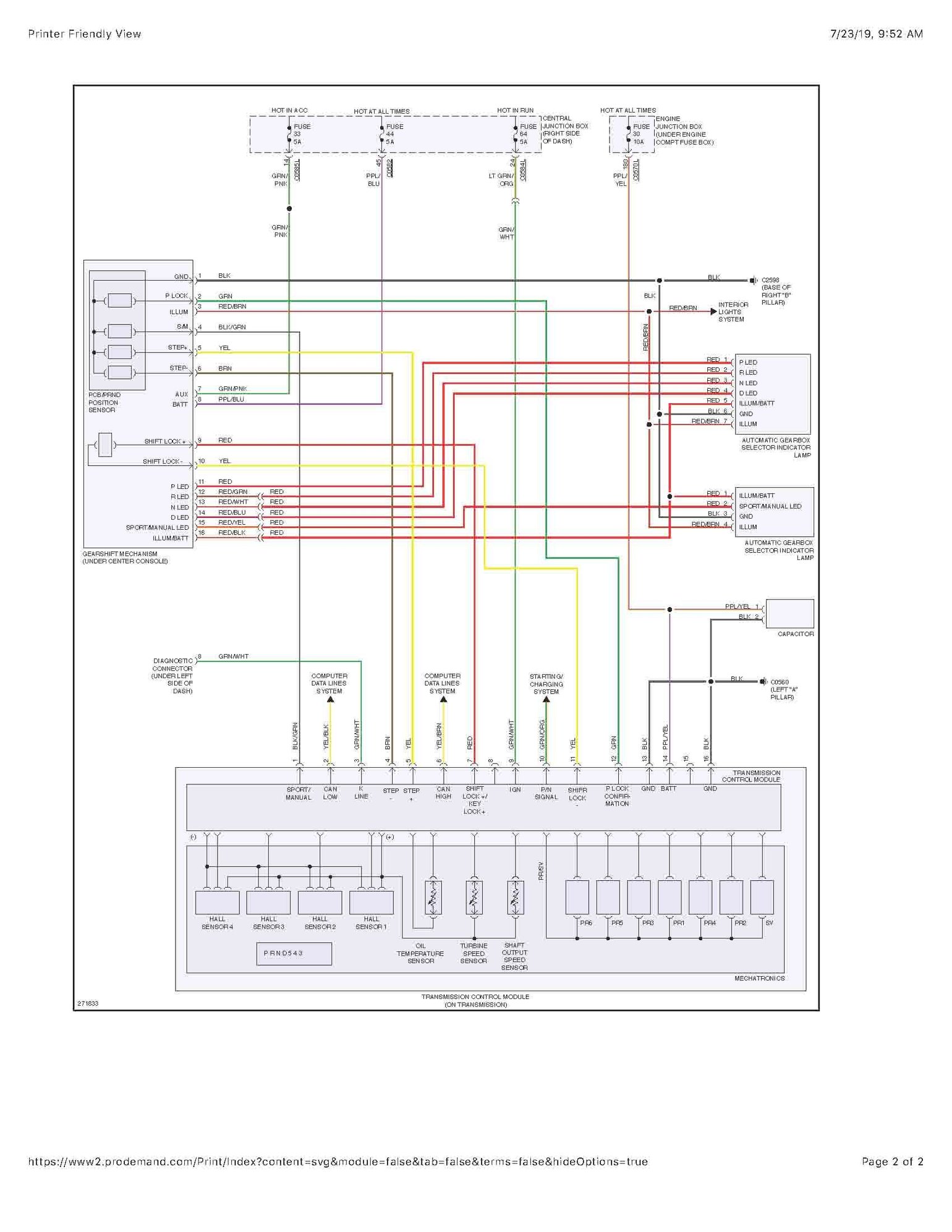

Does anyone have the electric schematics for the shifter harness.

Hey Dakota, I'm about to drive off a cliff!!!! I also have the P081C-64. Turn on headlights and can operate LR4 but no sport shift, fault comes up once in "D" -Gearbox fault. I've looked at the wiring diagram and cant figure out where this additional power supply comes from or what part of the gearshift it powers? The headlight test therefore proves its wiring and not mechatronics? My wiring is all good no corrosion, checked fuses but relays are unknown, no info? Will do resistance test today, mechatronics plug to gearshift plug.
Any additional info would be greatly appreciated!!!!

I am not sure how they exactly made this thing so turning on headlights allows one to shift. I almost think that was not by design, not sure. There are two 5 amp fuses, 33 & 44, in the central junction box. At lest on an LR3. One is alway shot, one is hot with in key position II/run. The only other source is through illumination, so if there is some sorta crossover I think it would be inside the shifter itself. Check those fuses otherwise you pretty much have to plan on spending $250 for a new shifter assembly or risk getting a used one. I dont think they have to be programed.
