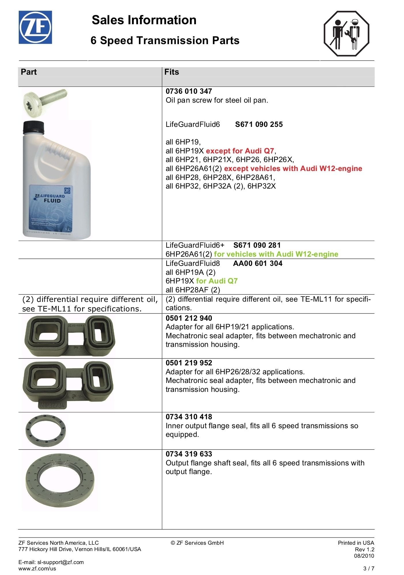

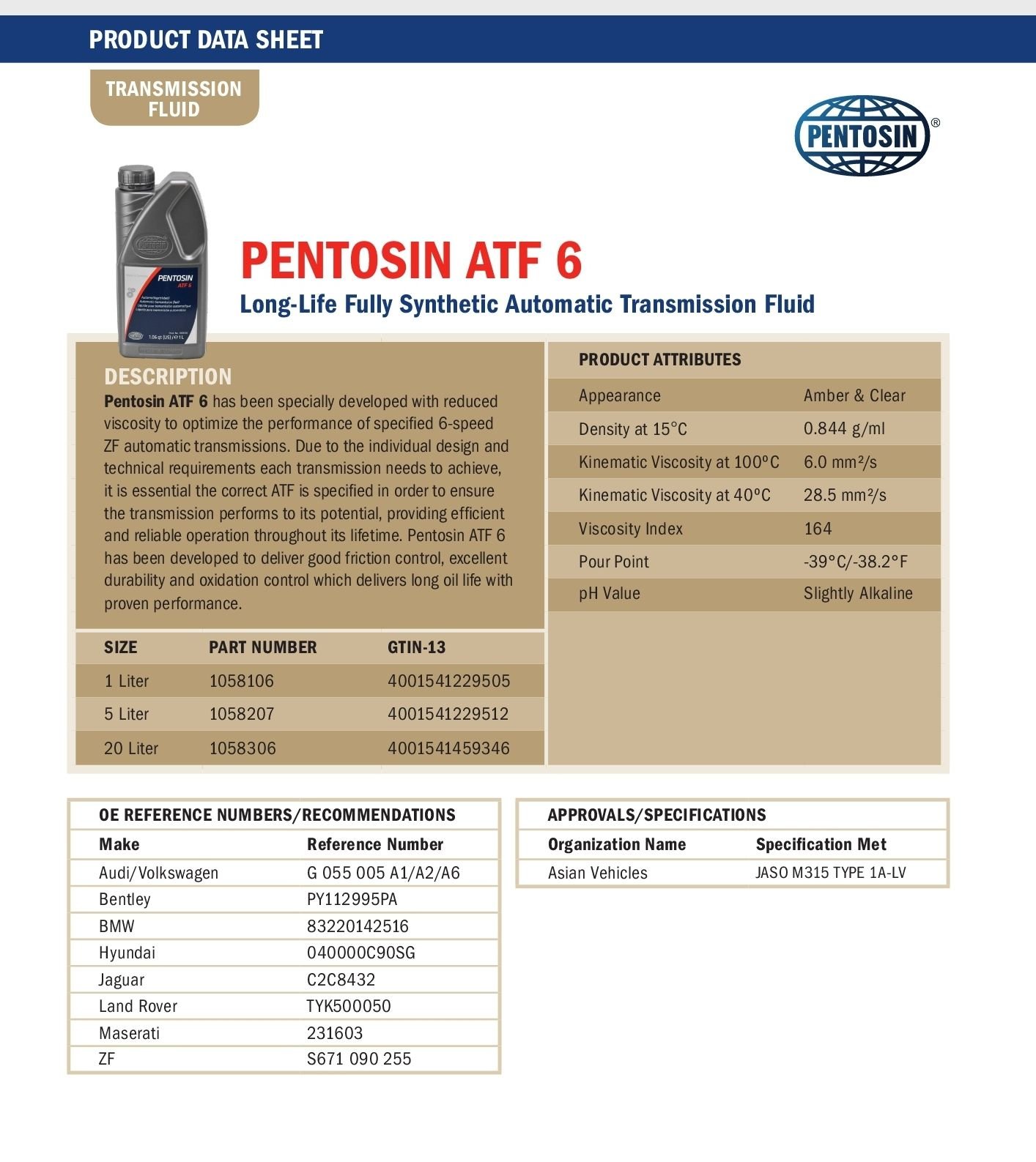

Going through it right now and after some research Pentosin ATF 6 works. See the data sheet attached, follows ZF S671 090 255
Not cheap, but it's available at the Napa auto parts down the street from me.
