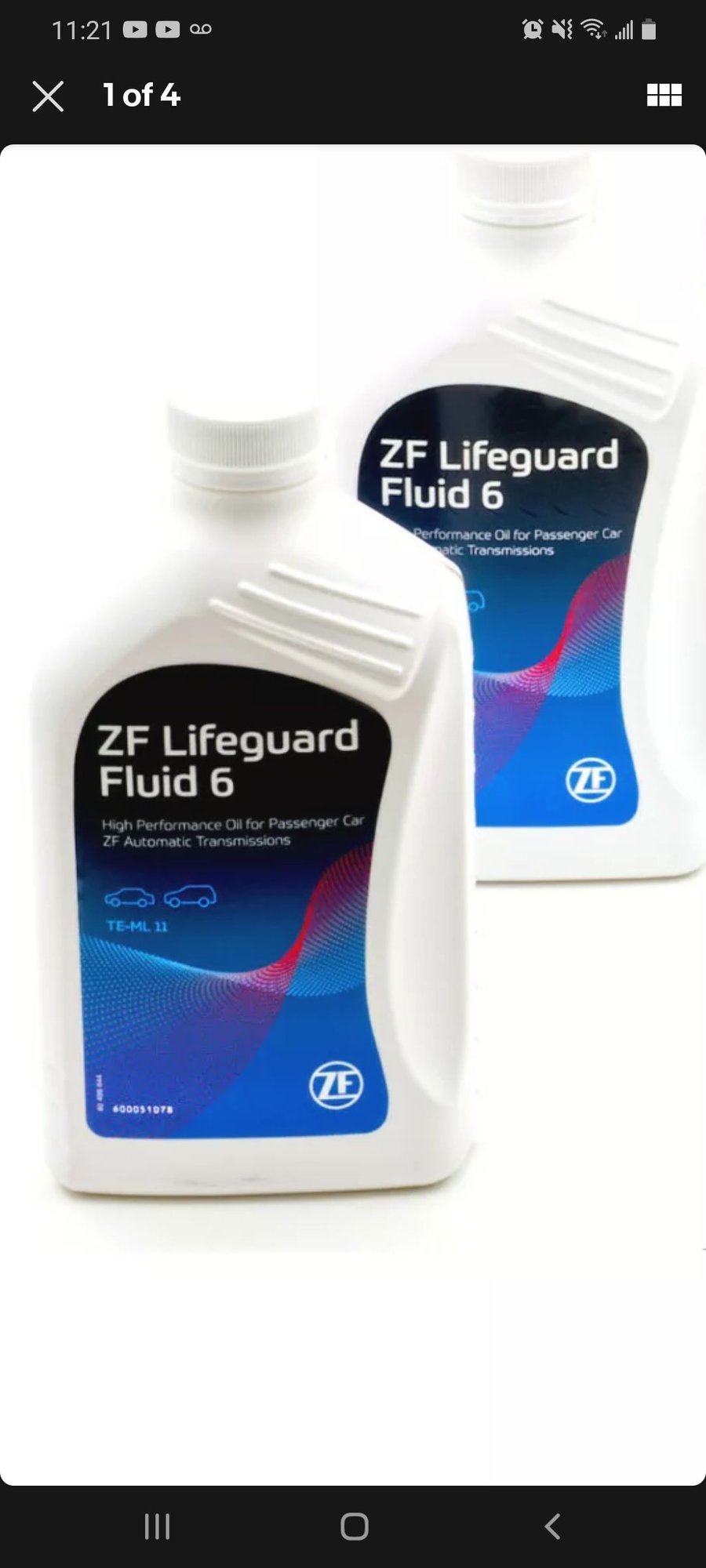

Thats the pan I went with also. Made by Alto - they are the only company that makes em. $100 for that kit, with bolts, etc. But my first pan had a bad weld around the drain and it leaked! Temp fixed for now, have a pan with NO DRAIN to put on next. I dont use that gasket though, it's ****. Me and my buddy went with the Fel-Pro TOS 18753 gasket. Its metal w/rubber seal. MUCH better quality and little chance of leaks. Also we used Motorcraft SP XT-6-QSP Tranmission Fluid. 12 quarts for $90 and its the exact same spec as Lifeguard 6.
