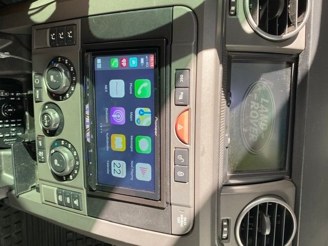

Just updated to a CarPlay pioneer head unit. Had a local shop do it they said they installed everything required. The built-in NAV unit on the HSE is now only showing the Landrover logo. Is this something I’m now living with,
or is there a workaround I am not aware of. If this is something that happens and it’s guaranteed what are my options for that space I can’t stand just staring at a logo and a blank space.

Unless they used the correct loom then you are stuck with the LR logo and no satnav or 4x4 info.

Did your radio have a MOST connection? Two orange lines meeting at a black plug? If so, just put a bypass on it and you should be good to go.
https://www.ebay.com/itm/New-Most-Fi...s/223136521415

Yes. I remember seeing them in there. So if I buy this item from
ebay it should work then.
also my subwoofer is now not working.
I wish this wasn’t so much of a problem. But I really do love having wireless car play now.
I also put in the tuf-tok power panel. Which I like
Old Mar 6, 2020 | 08:18 PM
DakotaTravler's Avatar
Joined: Nov 2017
Posts: 5,079
Likes: 980
From: Green Bay, WI
They should as the MOST network will be complete again and not a broken loop.
No clue on the sub, it depends on how you wired it. The factory one depends upon the factory amp.
