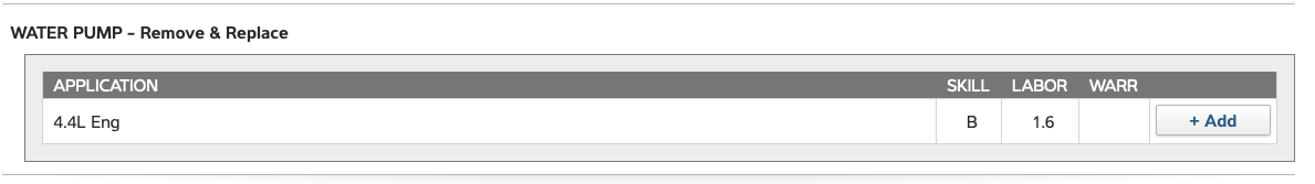

Here are the labor times, they might be a little shy, but they are close.
