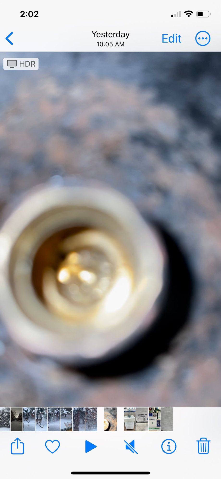

How does the rear bag itself feel? Maybe something is indeed plugged in the port. Try poking it with a small metal probe? You should be able to remove the port itself form the strut - again, make sure vehicle is supported! It is also possible the internal shock has failed and bound up somehow.
I tried pushing a small hex wrench into that opening as it is low clearance in there and the hex wrench has the 90° angle to allow access into the fitting. I cannot get it inserted due to some sort of blockage. I will try to attach a picture from the video I took of that port but due to the closeness the phone did not focus that well.

I just ordered new ride height sensors for the rear as well as all 3 valve blocks. I may try to remove the fitting from the top of the air strut today! The line is disconnected but the fitting has a blockage of some sort going on!

Todays update. I removed the offending air spring/strut and I can not force any air in nor get any air out of it. It is an Arnott and I will call them in the morning however I think this is simply the problem! Once I removed that I was able to deflate the system of air via the iLand device. Along with the other parts on order which I may end up keeping for future repairs or preventative maintenance I think I will need a new air spring. This one was replace a few years back and as far as I know the others may be originals! Go figure~!!! The fitting on top of this air spring is locked in place with a split ring and given the amount of pressure that has to be on it I don't want to try to remove it I don't think. It will shoot through whatever it is pointed at like a bullet I'm guessing. It is likely more sane to just order another air spring and be done with it!
