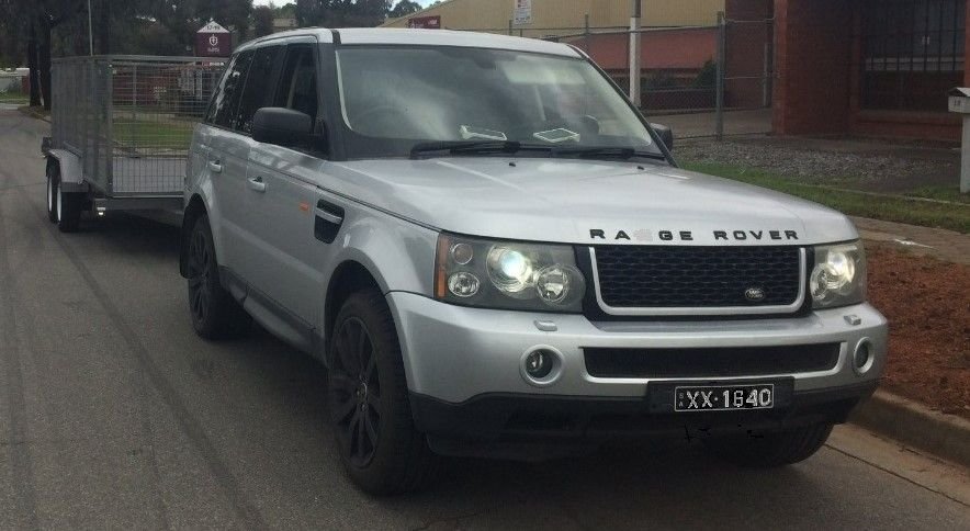

I think i will, as it just sounds bizarre! If it's doing the opposite, does it try lower when you press it to 4wd Raise height? Will certainly be interesting to see what happens when you replace the sensors. Def right decision. If it still, does it with new sensors then the switch(& Or switch system) itself, surely something to do with it. I'm lucky i simply get the completely random ''Suspension fault'' <[ ]> that comes up every now and then. Good luck. Ps. Is there a decent thread about the Rear entertainment system? My head rest Screens are not working and I've located a disconnected Fiber Optic cable under the drivers seat. No moisture in the tailgate etc as i've read many others with the problem have had. Cheers. Attached Pic of my Beauty for ya!

On edit: Nice ride!
