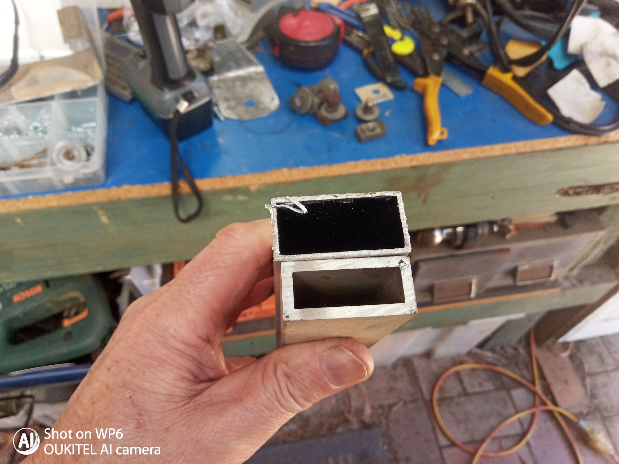

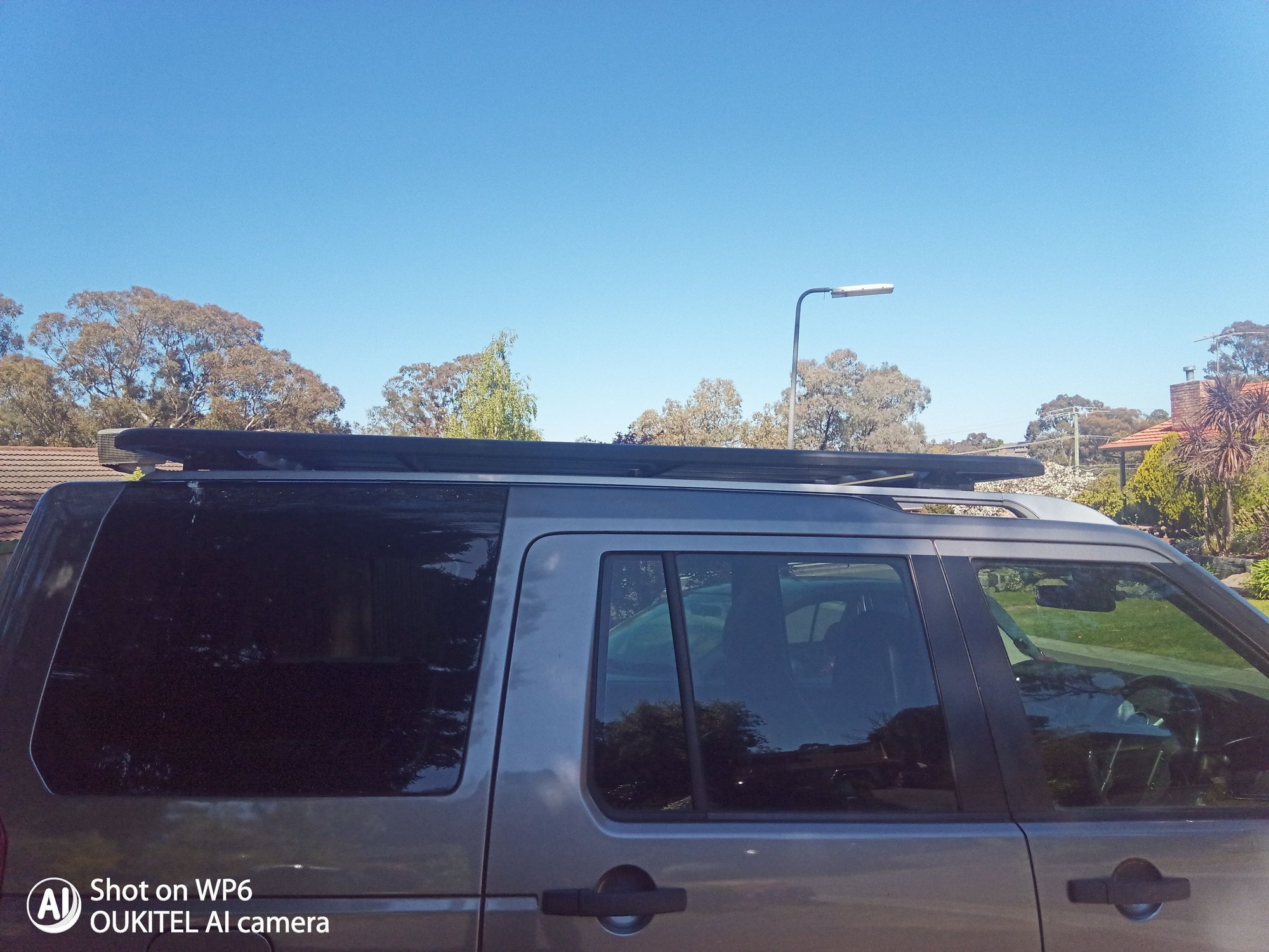

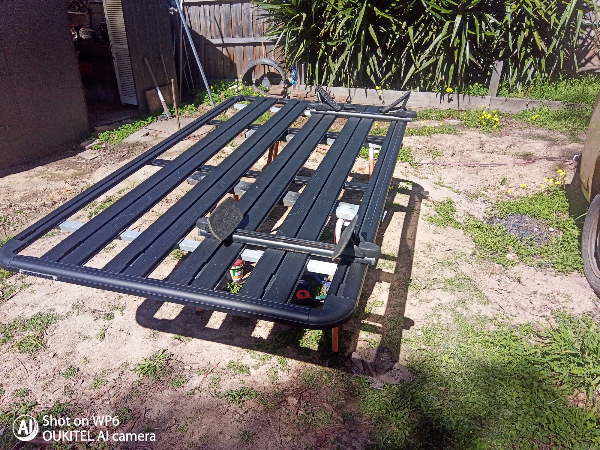

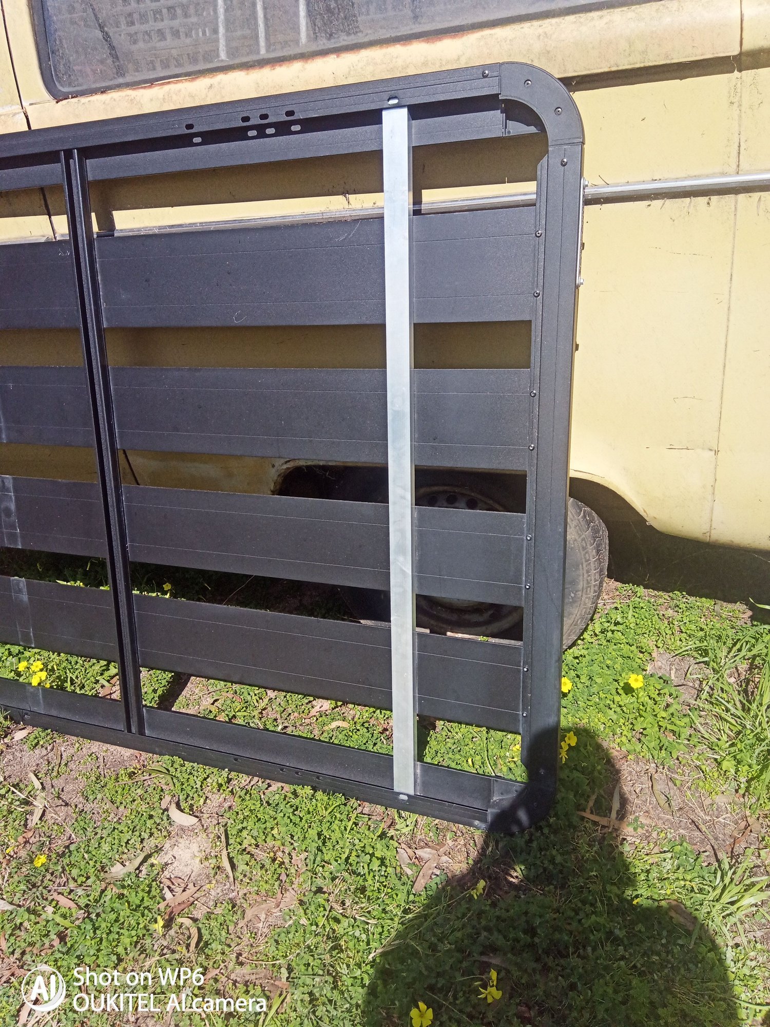

Was given this rhino rack that was missing the 3 mounting ribs, bought some alloy tube the right size and sleeved it for reinforcement and fitted it up with some legs i bought a few years ago.
I wanted it low but still be able to clean the glass roof, came with some maxtraxs mounts and now i need to make some brackets for my 42" LED light bar.
Also have some rhino kayak mounts that fir the rack.

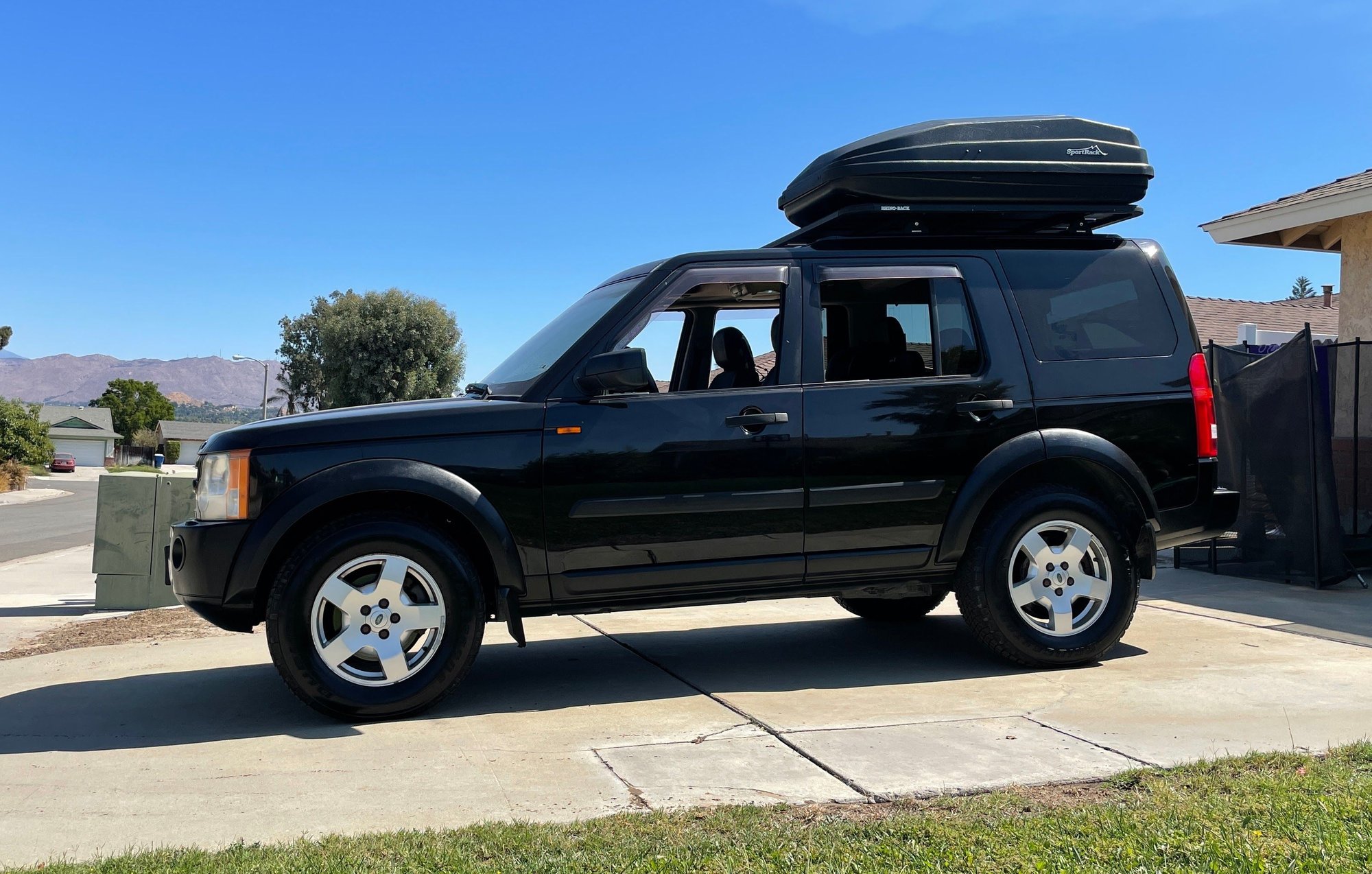

Got my truck washed for the first time in months and put my roof box on. Finally starting to look how I want it, next will hopefully be some tint for the windows because black leather interior is not fun on sunny days. Also considering painting the stainless side bars black and putting them back on. Current setup is 255/70/18's with about 1.5" front lift and 0.5" in the back.

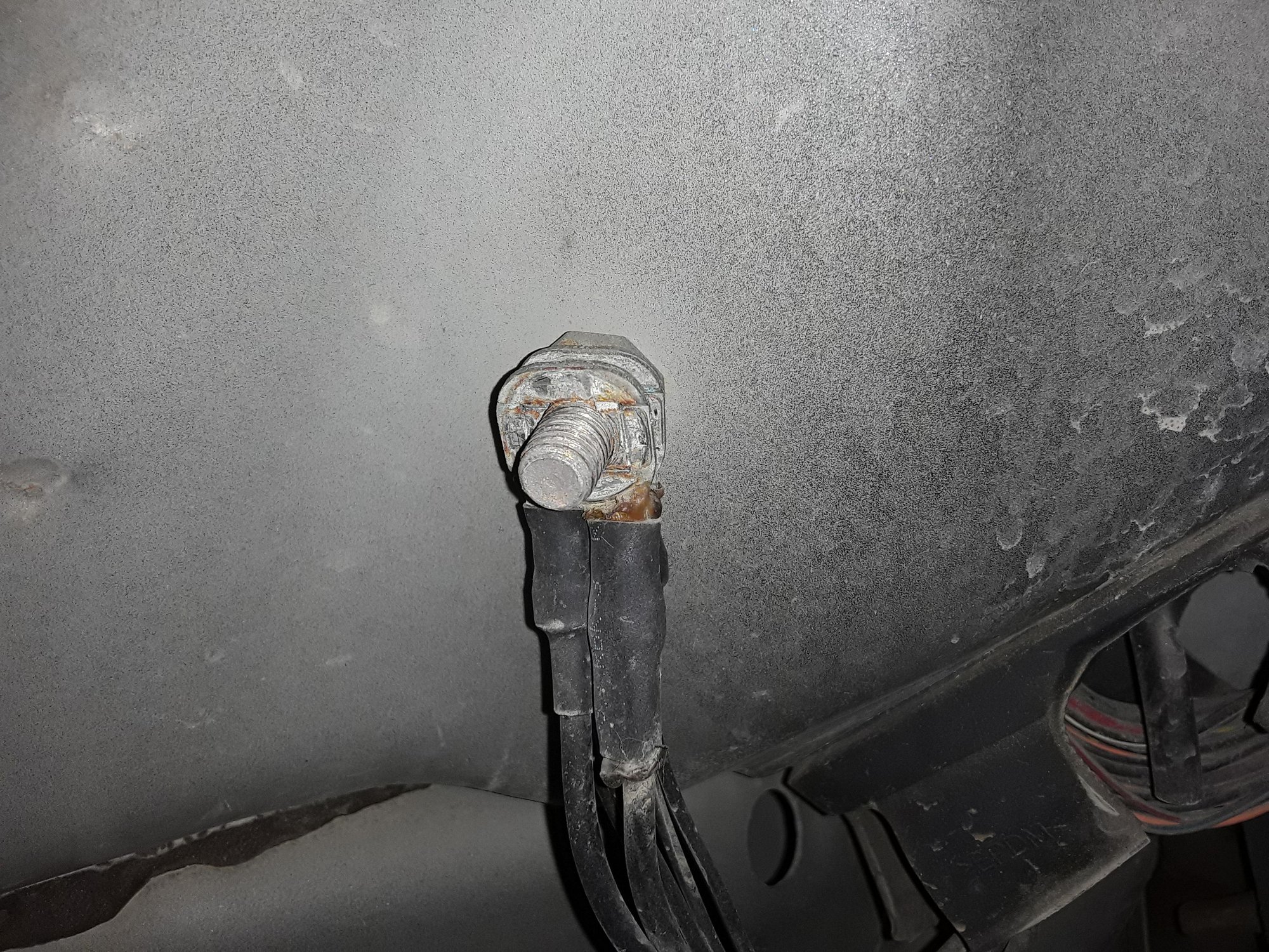

Default LR3 Ground Connection
Checked and cleaned my primary ground circuits, engine side and the through stud connection under the fender liner, chasing an intermittent no start and miscellaneous error messages that are not real. Looks like all is OK now, started about 12 consecutive times and no problems, will post a separate thread on what was done. Photo is under the fender liner stud connection after removing acorn nut, if problem not solved will report back...
